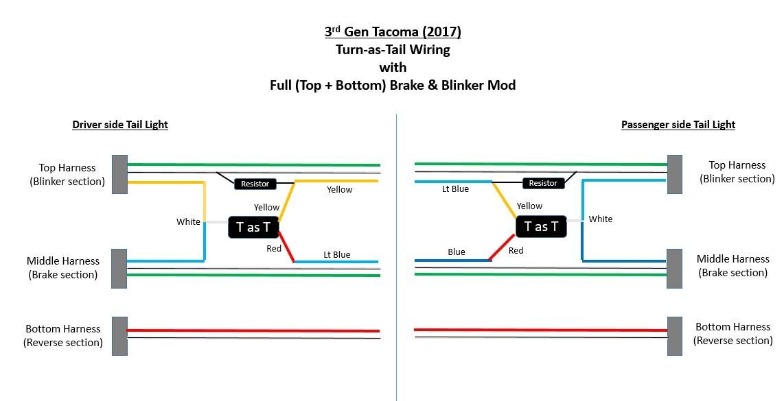

    Okay so I could use some help. I did this mod and it worked great when the truck was off and just acc power on (hit start twice).
    With the truck running, from what I can tell the brake and lights are fine but the turn signals are intermittent. They will either blink once, not blink at all (and no indicator on dash) or they will blink normally. This seems very strange...any ideas? I do have resistors in there so at first I thought maybe I should take those out of the equation and see what happens maybe running both lights needs more power or something but it doesn't make sense that when the truck isn't running it seems fine.

    More info please, are you using the Diode Dynamics module? Did you use the schematic from post #112? Any loose wires?

    Yes, using the diode dynamics module with the diagram from this thread which also shows resistors. No loose connections. I thought I had one, so I ended up removing all the butt connectors from the DD module and use some better connectors. Where I had to connect three wires I soldered them (DD output to blinker/brake).

    I've posted this before, but our stock flasher relay is hyper sensitive. I.E too much resistance and you get the hyperflash, too little and it will flash once and quit until you start the truck again. Finding the balance is tricky. And unfortunately the flasher cannot be changed out as it's built into the gauge cluster. Try removing the resistors and trying. Or go do a different OHM resistor.

    Removed the resistor and now it's working, except hyperflashing with lights on now. Ugh. I have a 6ohm so maybe a 3? Not sure what I can find. Or maybe those zevo led lights will work better.

    Tried installing this today and this is what happened:
    Without the resistor, it will hyper flash when in night mode (headlights on). When in daytime mode, it seems like everything works perfectly fine.
    With 1 resistor (5 ohm) installed in the turn signal circuit, no lights work in any mode.
    So I thought maybe I needed a resistor on the brake light circuit too, so I installed a resistor (5 ohm) on the brake light to see if they will start working, but no luck.
    I ended up taking it all off.
    It sounds like what we need to find out is the exact resistance. It has to be between 3-6ohms.
    FYI: I followed the attached diagram.

    So I ordered a pair of 3 Ohm resistors. I should have them Tuesday. Without a resistor (and before this mod) I would hyperflash if brakes pressed or lights on (night). During the day it was fine.
    With the resistor (6 Ohm) it fixed all of that.
    Now that I did this mod, it works fine with the truck turned to acc mode, but not on with the 6 Ohm resistors.
    With no resistors, back to the same issues as before - works during the day but not at night or when brake is depressed. So I'm hoping splitting the difference works.

    I used Sylvania 7443R LED’s from Walmart for brake and turn and Sylvania ZEVO 921 6000K Super Bright LED’s for the backup lights. Just one 6ohm resistor as drawn in the schematic and no issues (they hyperflashed before adding the resistors).

    hmm. I was planning on doing this today, but now I'm wondering if I should wait. I do have some 6 ohm resistors I intended to put on the blinker side. I run with my headlights on a lot so I got to make sure everything is working correctly lol
