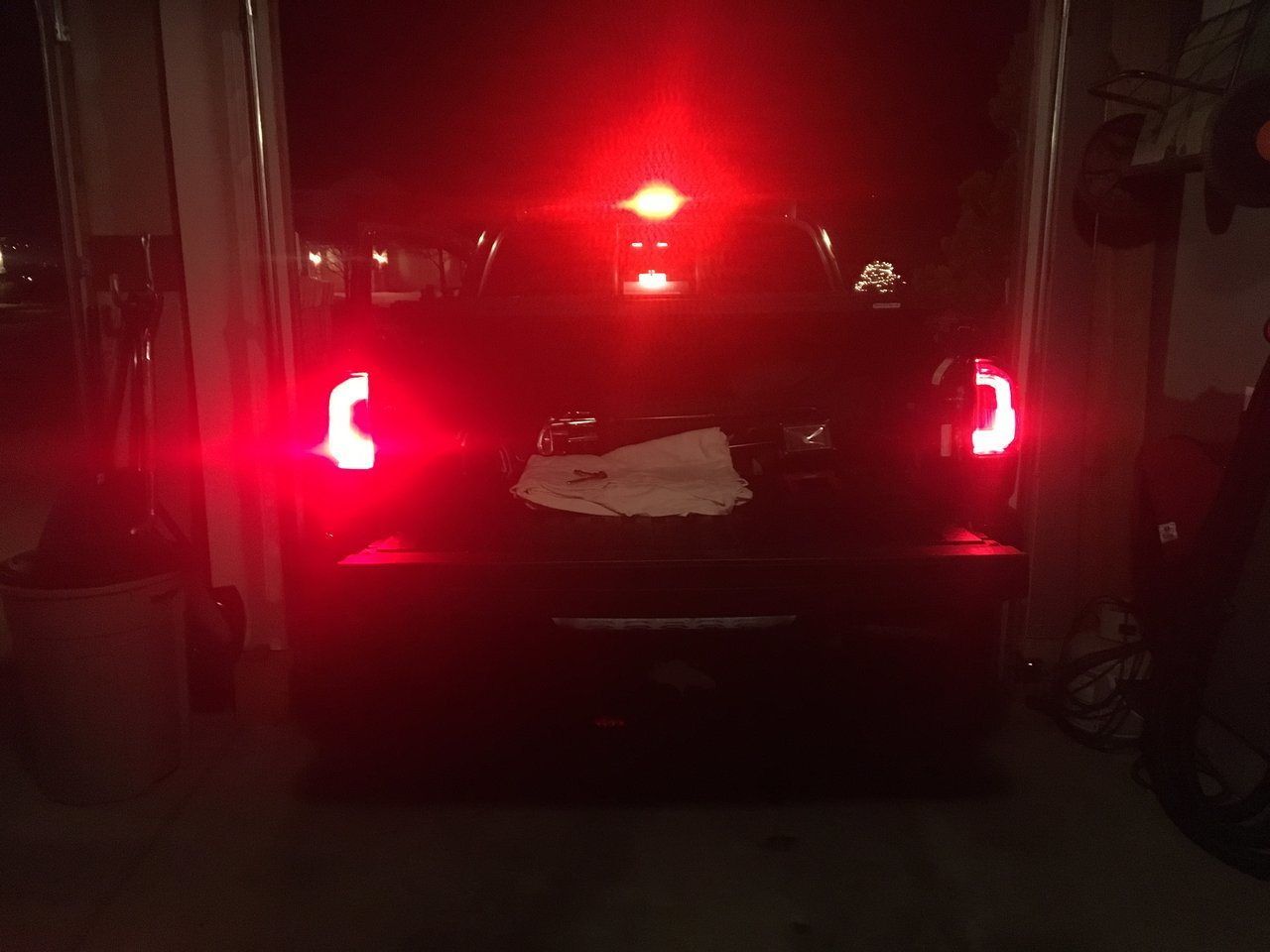

    Think you can tell which one is not LED!
    Frantically working on Turn as Tail mod with DD module.
    Question: when I install the resistor for turn signals, do they need to be “ mounted “? I see 2 mounting holes but not much wire came with it ...
    splashflash likes this.
  10. Dec 11, 2017 at 6:13 PM
    #250
    splashflash
    splashflash Vagabonding
    Oct 13, 2017
    #232899
    676
    Art
    Timnath, CO
    17 DCSB 4x4 M/T Off-Road
    They get hot, mounting is definitely recommend.

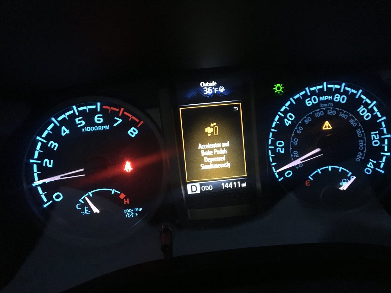

    so.... I followed wiring diagram from earlier post with 50w 6 ohm resistor. I decided to just do one side ( driver) to test it. I put on hazard lights and instrument panel only showed the passenger blinker, front passenger turn blinking only, rear driver lights NOTHING. BUT when I remove brake light LED the driver turn signal work?!?!?!
    Thoughts???

    What a way to start the day.
    Could not drive into work. Can’t get up to 10 mph.
    I noticed brakes squeaking slightly when I was moving car in and out of garage last night.
    No mechanical obstruction seen in cab.
    Since I could not get T-T module working I disconnected and just put resistor on driver turn signal.
    Adding to my issues one of the Red LEDS would not work yesterday so I just put LEDS on passenger reverse and brake keeping stock on passenger turn until I got new LED.
    Mixing LED and incandescent on passenger side should not cause any issues - right???
    Called Toyota. Said would not be covered if caused by LED swap. May try disconnecting battery, replacing back to stock and go from there...
  16. Dec 12, 2017 at 7:27 AM
    #256
    splashflash
    Oct 13, 2017
    #232899
    676
    Art
    Timnath, CO
    Woah! And no, running led with regular bulbs should be fine. I ran leds on my brakes and regular bulbs on my turns before I did the mod for a couple of months.
  17. Dec 12, 2017 at 7:45 AM
    #257
    toyomaniac71
    toyomaniac71 Well-Known Member
    Jan 22, 2016
    #175782
    316
    Dave
    Colorado
    16 DCSB Sport
    Toytec 2.0 Boss 2" lift; Fuel Boost 18"; Nitto G2 275/65/18; BAMF Grille
    I need to contact DD.
    I ordered the same module that was listed earlier in the post and when I spoke to DD earlier they said it should work but at the same time not sure if they have actually done one themselves on the 3rd gen. He mentioned they need to get another one in their shop and try it. He also said they have been trying to get on TW as a vendor but are having trouble getting approved.
    I’m thinking if I had done just the LEDs/resistor I’d be fine. That module has me concerned
  18. Dec 12, 2017 at 7:50 AM
    #258
    MESO
    MESO Major Modder Vendor
    Feb 16, 2015
    #148809
    16,292
    State of Jefferson
    2016 DCLB TRD HELLCAT SWAP
    Woah.. that's no bueno!
    The joy of computers in trucks. All this data and resistance, 1 thing off and throws other stuff out of wack.

    Holy crap!
    o_O
    Definitely try disconnecting the battery for a minute! Let the ECU reset. Most of the time, when I have a problem with a basic computer, doing a simple restart seems to do the trick.
