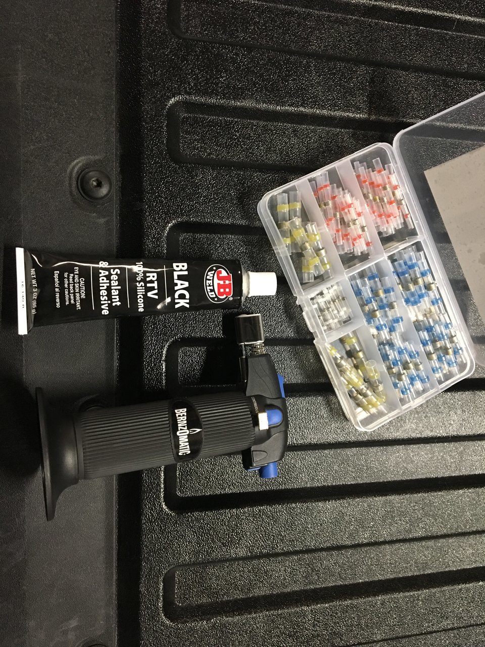

    Those connectors are cool! I've heard nothing but good things about them.
    But, it finally got a good soldering iron and found a bit of joy in using it. Ha! I can't believe that crappy Radio Shack irons were my problem for literally decades.

    This was my first time using them or a pocket butane torch. I don’t have much soldering experience myself.
    Few tips if others are considering using torch for first time. Keep surrounding wires, paint, etc covered! I had some metallic-like tape used for ventilation ducts lying around which was helpful to protect surrounding plastic/wires.
    Practice with scrap wires to get a feel for it. I found it helpful to line up wires and heat plastic insulation on both ends first, THEN solder middle section. This prevented wire from “slipping” out if you do center first - if there is slight tension on wire, as soon as solder turns to liquid the wire can slip. Just my 2 cents.
