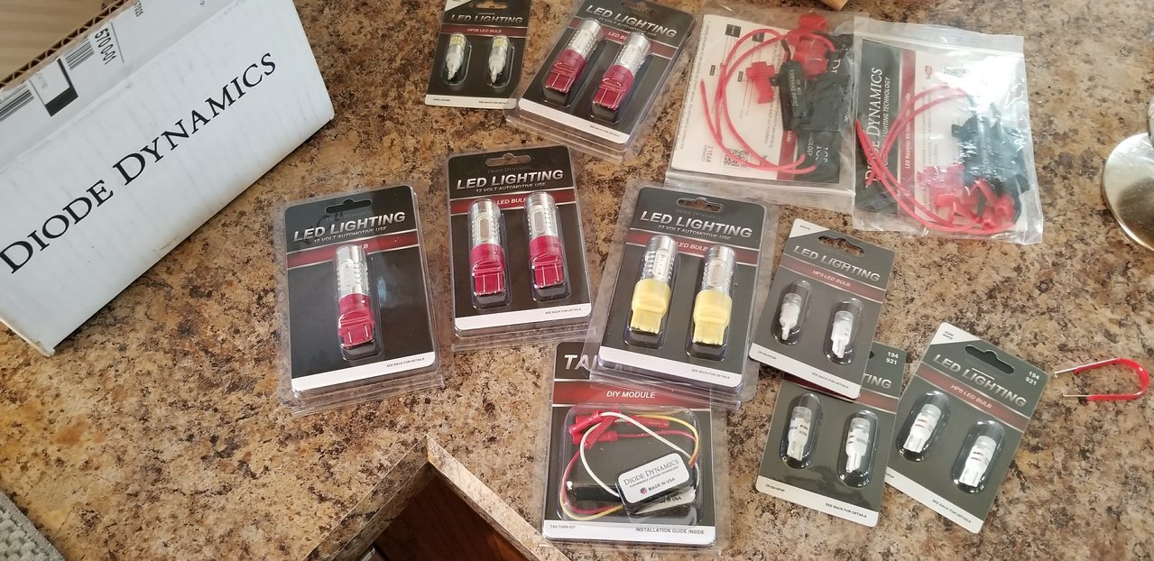

    Hello, I was instructed to post my tail as turn issues in this thread.
    I have a 17 Tacoma Pro, that I purchased these for ...
    Installed, everything works great in the garage KOEO. Drive to the end of the block and I get one flash with the blinker and then nothing, same with the other side.
    Turn the parking lights on, and everything works as advertised. Parking lights off, no turn signals, drive back to the garage. Shut the truck off, works weather the parking lights are on or off.
    Key On Engine Running: Blinkers only work with parking/running lights on.
    Key On Engine Off: Works perfectly
    Installed 6 ohm resistors front and rear. I have emailed Diode Dynamics to see if they might have a fix for my issue. I have found a couple of threads but couldn't seem to find a fix

    Sounds like you're having the same issue that a few others had. It would work until you press the brakes and then turn on the turn signal (with the brakes still engaged). Once you do that, the turn signal only blinks once then there is nothing until you turn off truck and then turn it back on.
    Everyone who had this issue solved it by putting bigger resistors in the rears. So far, everyone who put in 9 or 10 ohms (in the rear) seems to be working without issues.
    If you wanted to try something, you could take the resistors from the front and add it (in series) to the other resistors in the rear. It might be too much resistance at 12 ohms total, but since you have them on hand, it might be worth testing out before you order more resistors. If it does happen to be too much resistance, it won't hurt anything (I've tested this...lol)
    Of course, when you take out the resistors in the front, you'll have to put in your OEM halogen bulbs while you do this test.

    Awesome, thank you. I unfortunately won't be able to test this with the front resistors as I have already soldered and heat shrinked everything. I'll go ahead and get some 9 ohm resistors ordered and update with my findings.
    Thank you again!!
