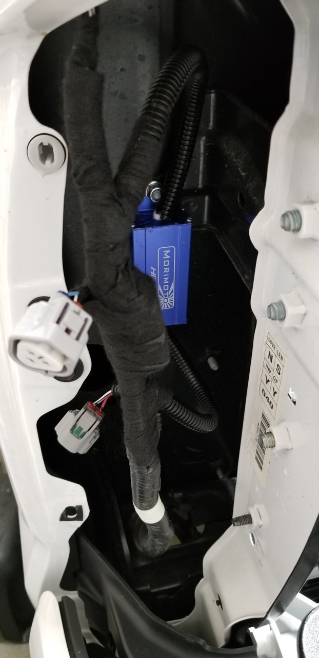

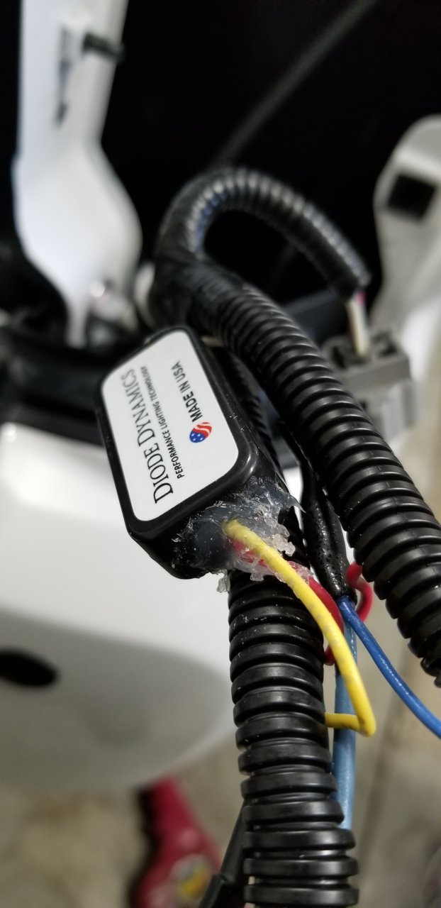

    Okay, so here's an update with my tail as turn / resistor issues.
    Ordered what I thought was a set of 9 ohm resistors but ended up with Moritmoto 7.5 ohm resistors. Thankfully they do work where the DD 6 ohm resistors did not. I now have fully functional turn signals no matter the headlight setting.
    I also threw some silicone in the tail as turn boxes to avoid corrosion setting in immediately.
