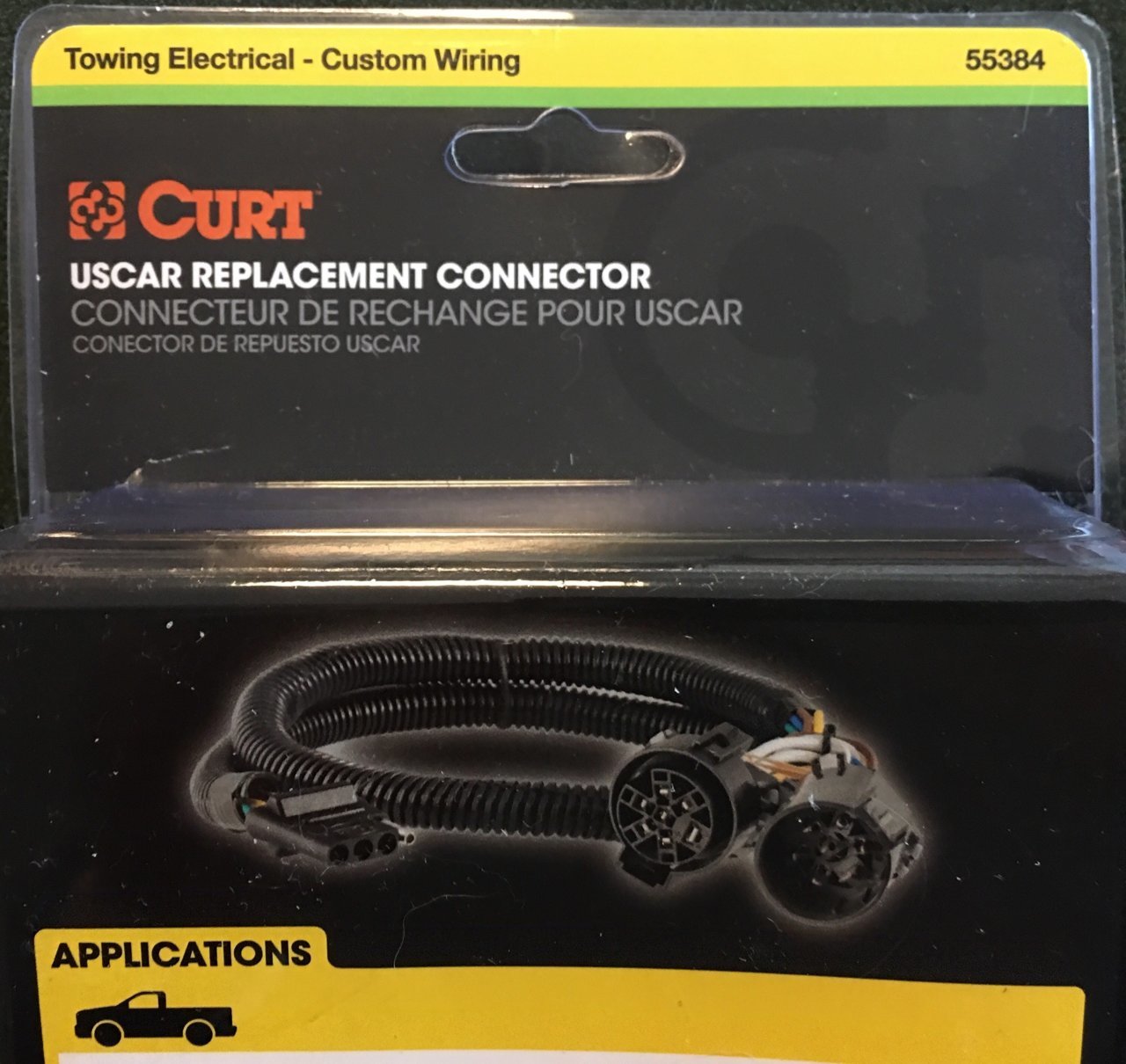

    I installed the same OPT7 Redline bar when they first became available last year but I used this Curt wiring harness which looks identical to the one you listed above. Keeps all the wires hidden from sight.:thumbsup:

    It does look identical. Probably made in the same factory, just with a different label.
