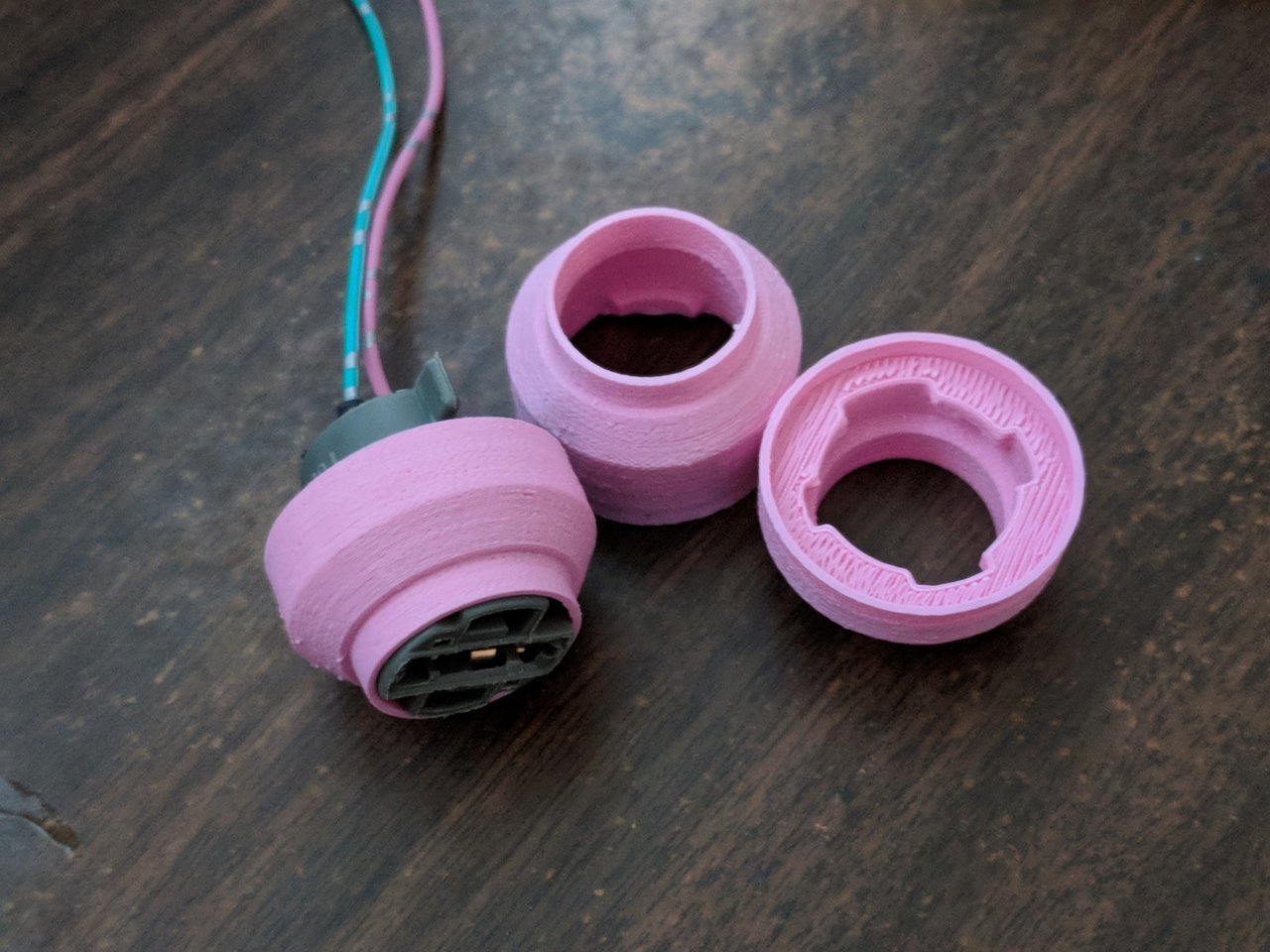

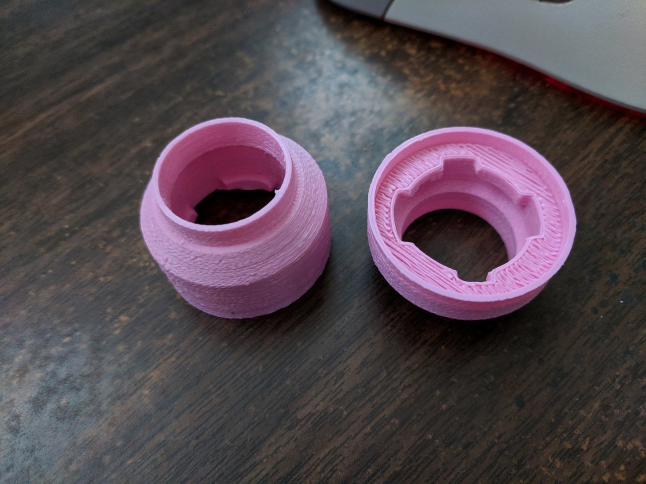

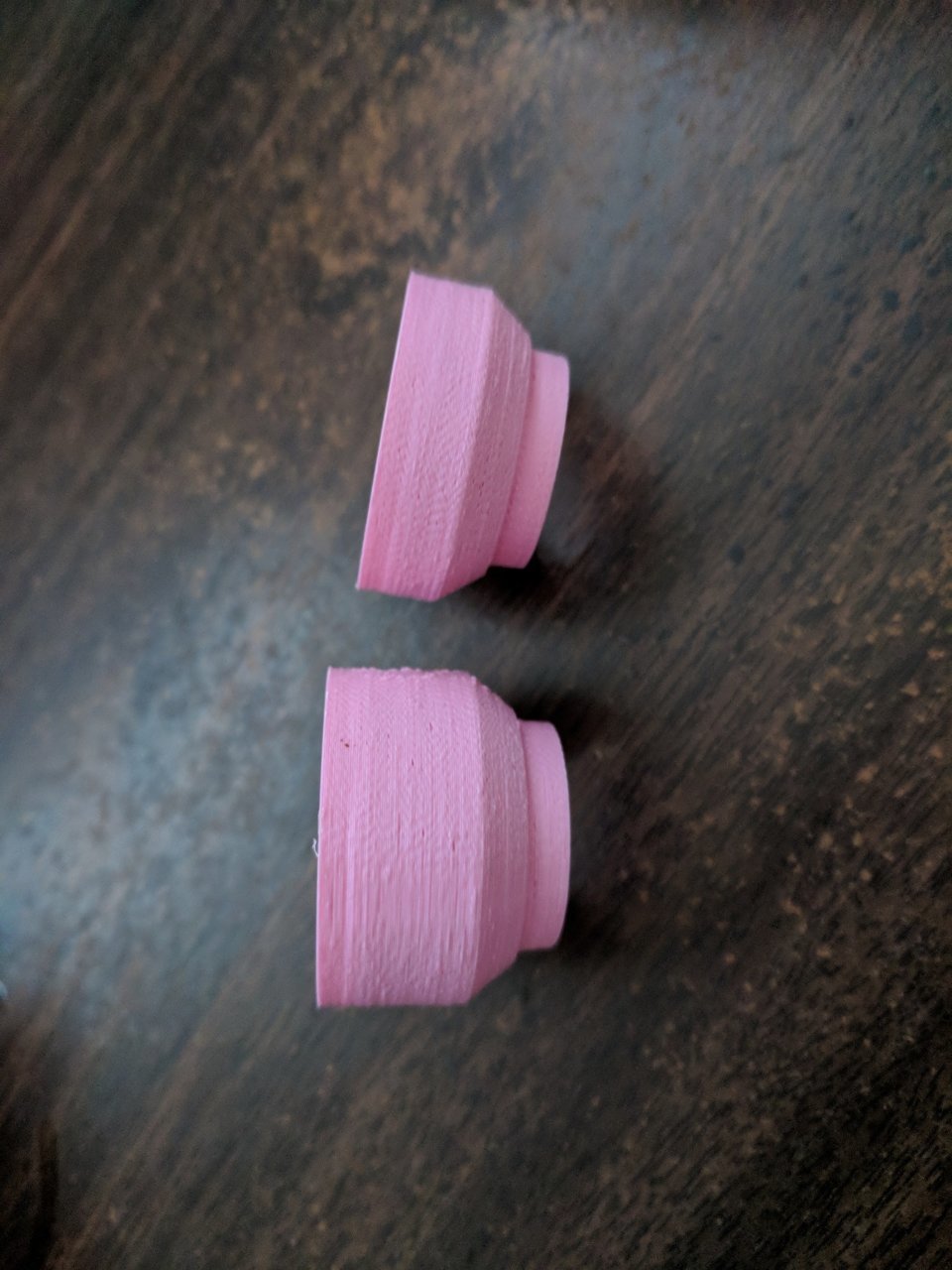

    This adapter should work to hold in those 7440 lights, you can get a file for 3dprinter at thingiverse https://www.thingiverse.com/thing:2941466 There are two heights in case the LED's are long. get a friend to print or use one of the print+delivery services out there. it's a small part and should be pretty cheap, on my printer it was about $0.40 for the pair, online services will charge $5-10 for a pair.
    splashflash, Kopasz, RobP62 and 3 others like this.

    Thanks Eric. So it looks like I owe you $1.60? Still haven’t tried them out—I’ll do that today when we get back from Skamania. I suspect I’ll ask you to print me up one more taller/longer adapter.

    I've finally got around to revising my Tritton adapter. The V3's were adjustable length so the 7440 adapter didn't really need to be a critical length. Well, now Vled's made the new V6's a fixed base so the adapter will need to be precise. After doing a bunch of these 7440 conversions, this is what I came up with. A snap clip installation, chamfered screw slot and a stop. All at the correct seating depth for proper light distribution in the bowl.
    I have some in the printer now, if they look good I'll offer them up to guys that want to do this mod.
