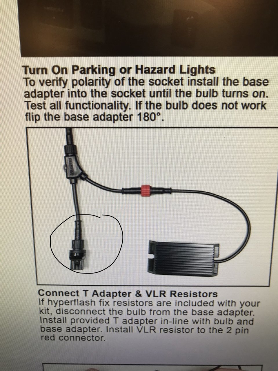

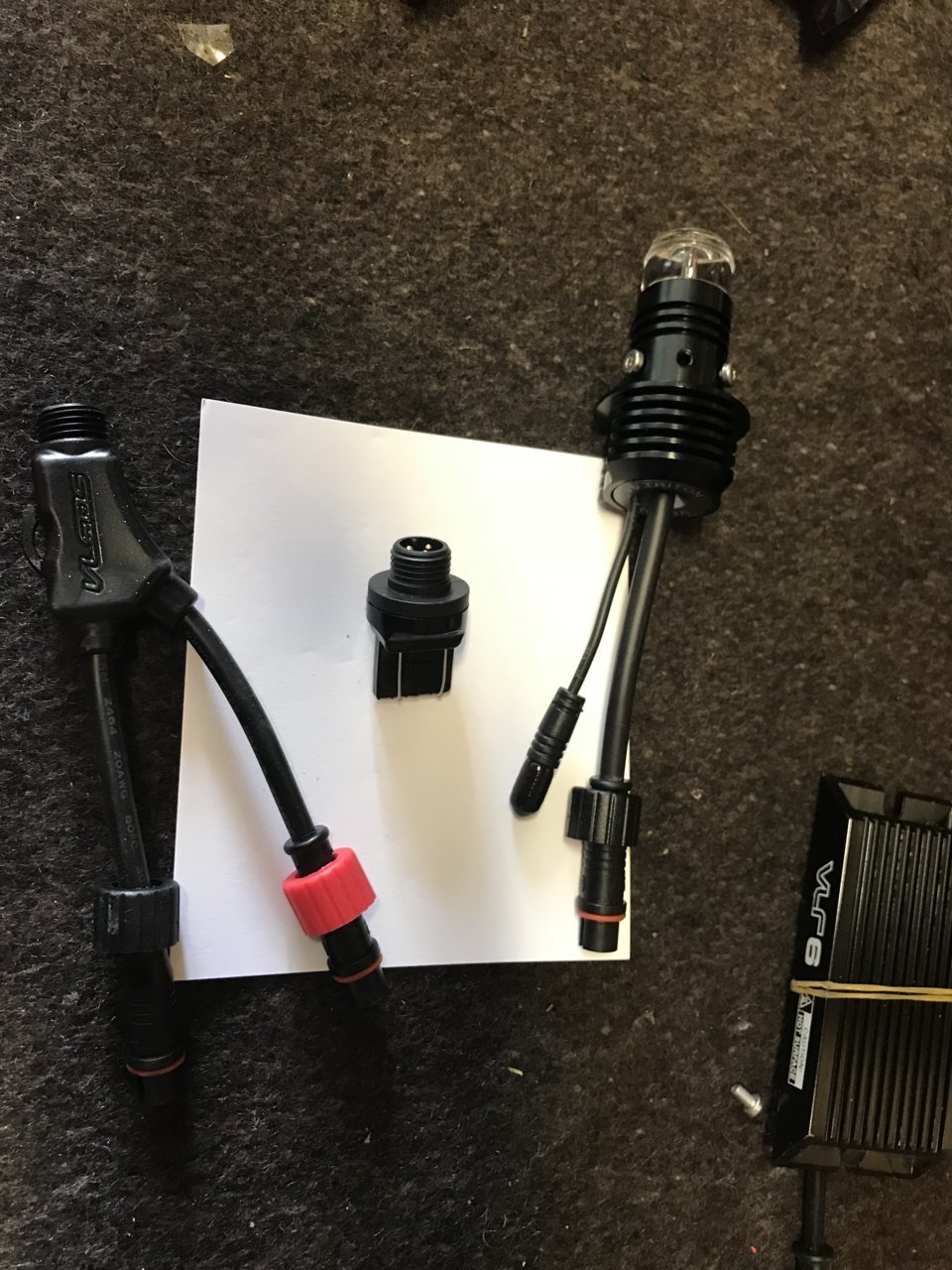

    I am working on this as we speak. Do I need to cut this adapter to get into the wires?

    This is where I am confused. How do I connect the stock harness to Triton? Do I cut the wire on Triton to expose the acual wiring?

    Errr typo. I meant to type V6's(newest model). Which is what these adapters were designed for. Although the v3's(discontinued) should fit as well.
    When I ordered my V6's, I opted out of a connector because it will have to retrofitted hardwired anyway. They supplied me with a pigtail that had 3 bare wires. Different than your pic

    I got you. That is the mistake I made than. I just went to their website and you can select hardwire and I selected 7440. I should than be able to cut the wire and splice into three wires.

    Probably just cut there and I should see those three wires. What you guys think?

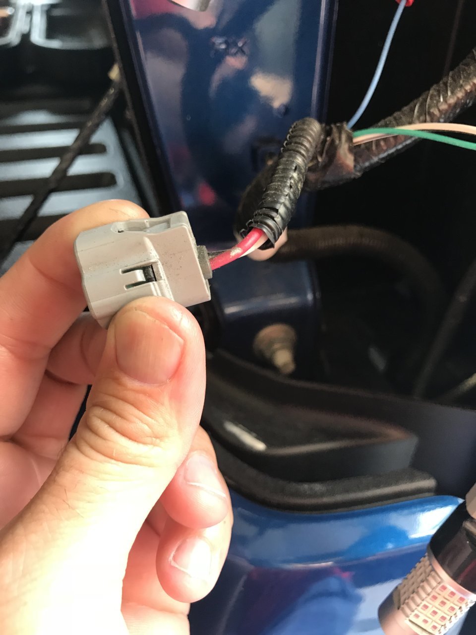

    So need some help from the brain-trust... TaT install.
    I am not a big fan of cutting/splicing/etc the factory wiring harness bits and I was contemplating making a jumper and was curious if anyone could help me out in thinking about what parts would be necessary... thinking I just need the below and some male spades to go into the original plug?
    Replacement Plug / Pigtails-
    https://www.amazon.com/Toyota-Connector-Pigtail-Harness-Electrical/dp/B01BA6CI0C
    https://www.amazon.com/gp/aw/d/B077RDRT5J/ref=ox_sc_act_image_4?smid=A1LK2U4Z4PVUFU&psc=1
    I have found the sockets for the tails but dont see why that would be any better... thoughts?

    What you need to go totally splice free is two sets of male connections for all three (upper C, lower C, Bottom) and two sets of female just for the C (upper C, lower C). You don’t need the lower as that is where the V6 is. These are available both original Toyota and aftermarket. The numbers for female are usually one digit from the male. Once I’m done with mine I plan to do a simple how-to to make this more of an afternoon project (two beer).
