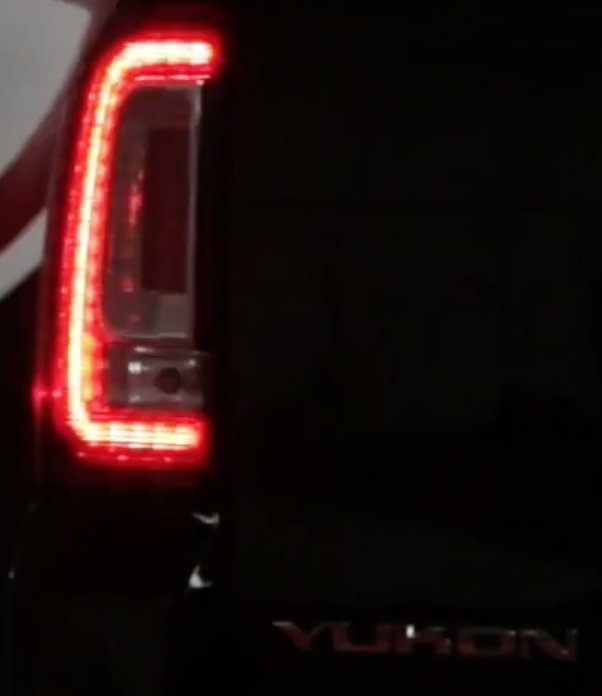

    I've seen some GMC that have exactly the style setup that I wish Toyota would have gone with.
    cshrum likes this.

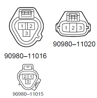

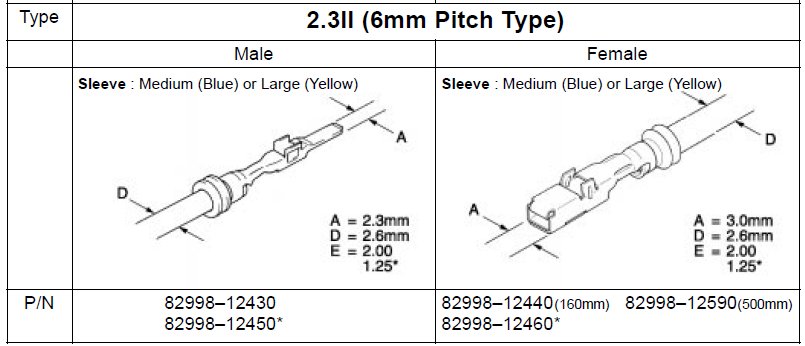

    Where can I find the part numbers for these plugs?

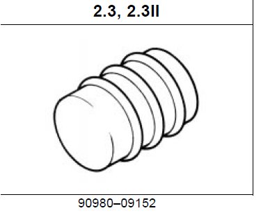

    upload_2018-9-23_23-39-6.jpg090II-PIN3 for 14 AWG wire, Yazaki p/n: 7114-4027 090II-SKT3 for 14 AWG wire, Yazaki p/n: 7116-4027 $0.18 ea 090II-SL3 for insulation dia. 1.5-1.9 mm (.059-.075 in), Yazaki p/n: 7158-3008-80, Brown (seal)
    upload_2018-9-23_23-39-25.jpg $0.18 Plug upload_2018-9-23_23-40-0.jpg$8.00~$6.00
    Fill in the missing connector part number MESO...:D

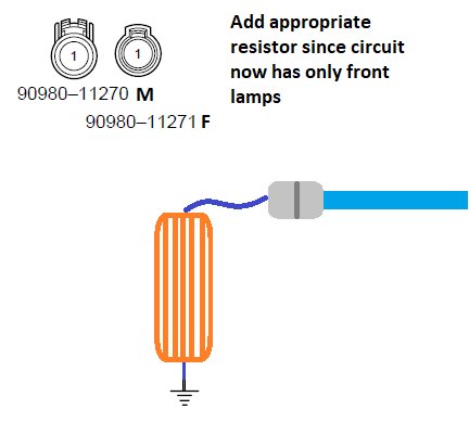

    Just for U.
    Fill with Epoxy or Silicon for weatherproofing.
    Make Y wires to L& R with repair terminals.
    Remove the terminals at the OEM connectors use these with resistor on other end.
    $8.75~$3.93
    This has been mentioned before....
