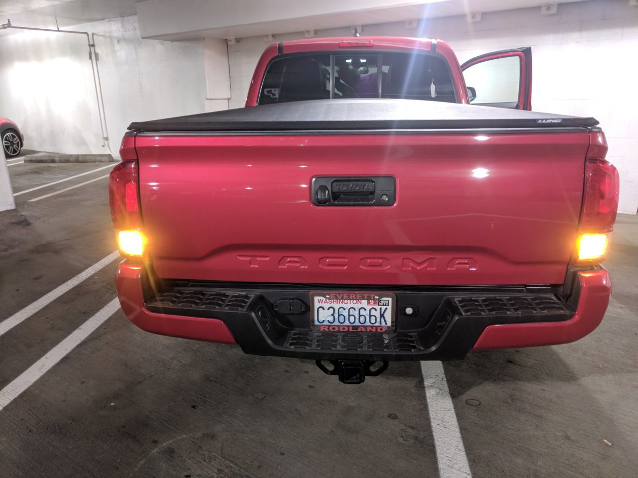

    What did you do for turns? 921NA incandescent bulbs in the reverse housing?

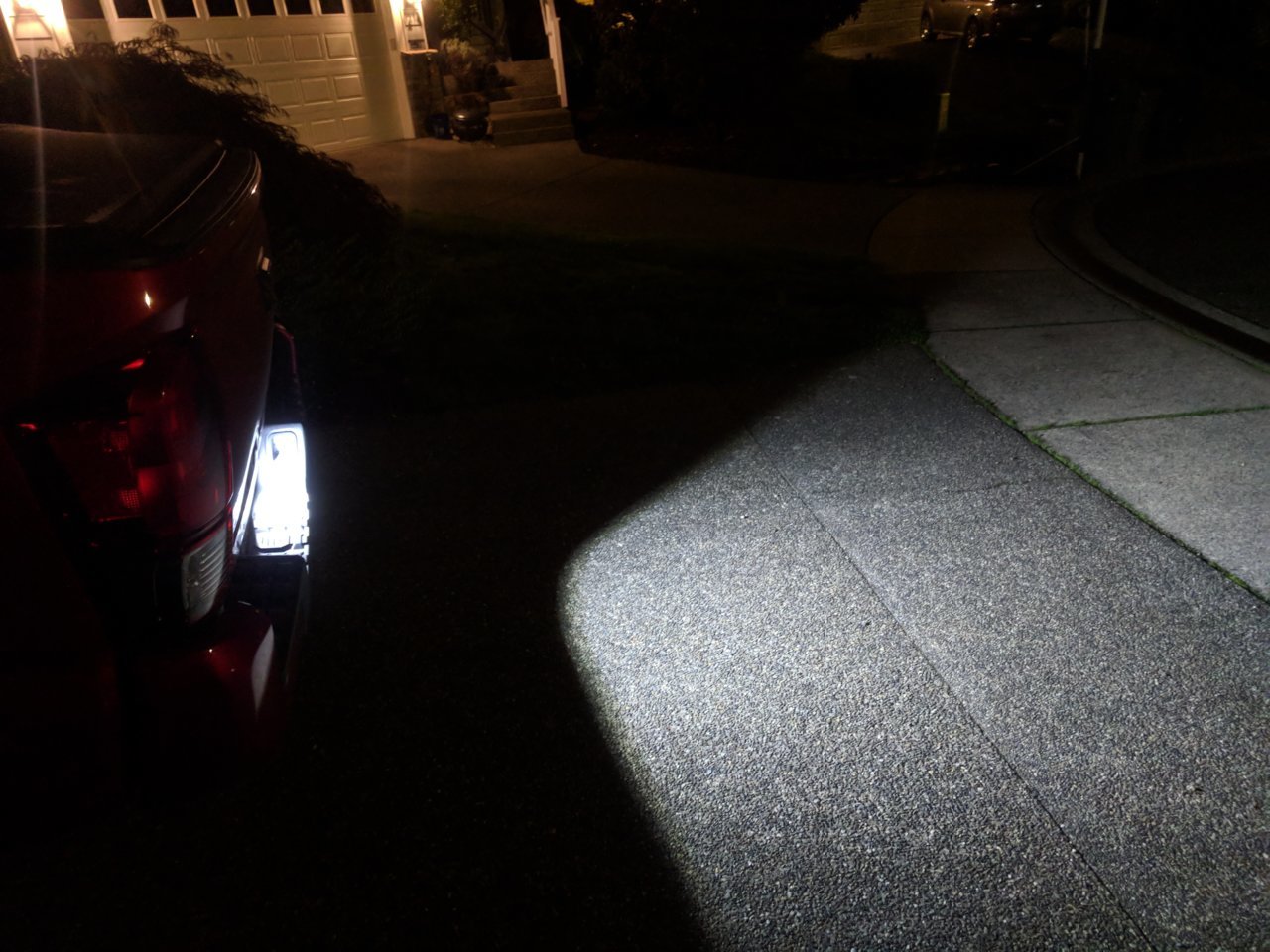

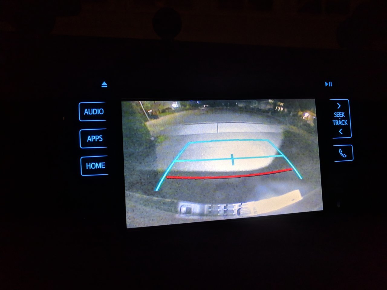

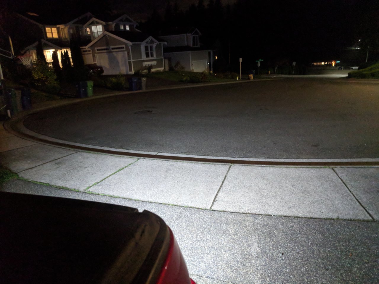

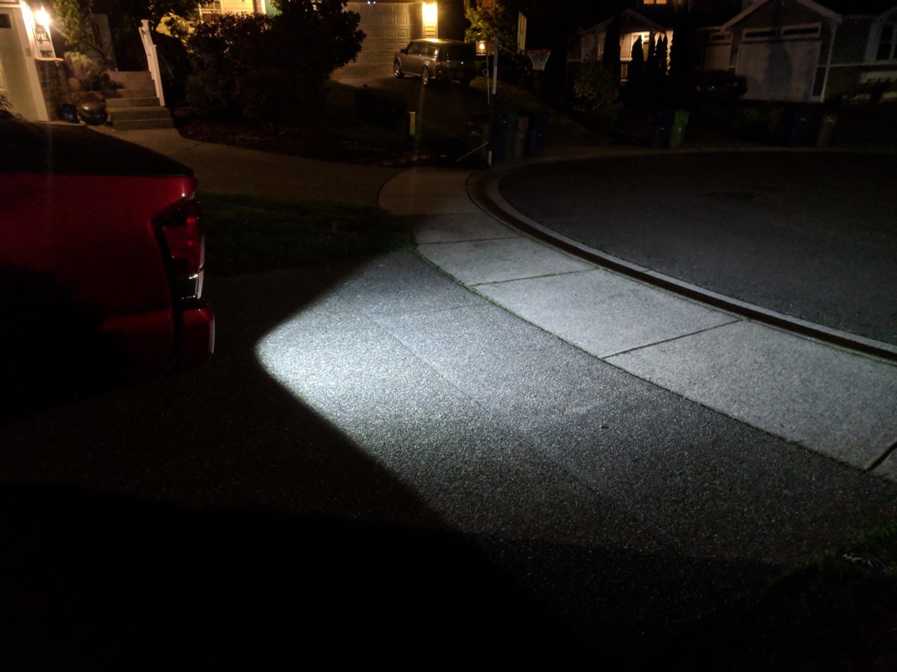

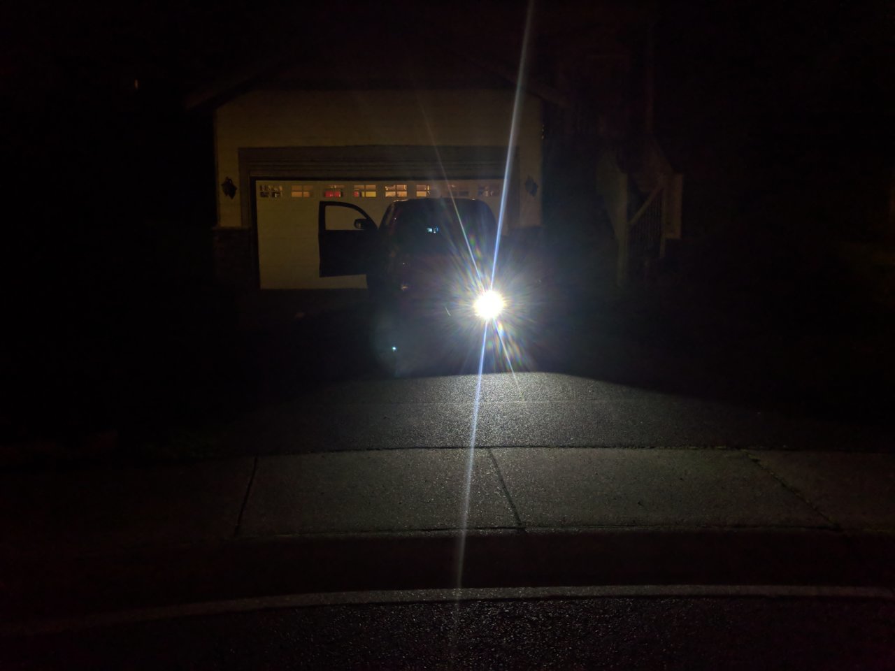

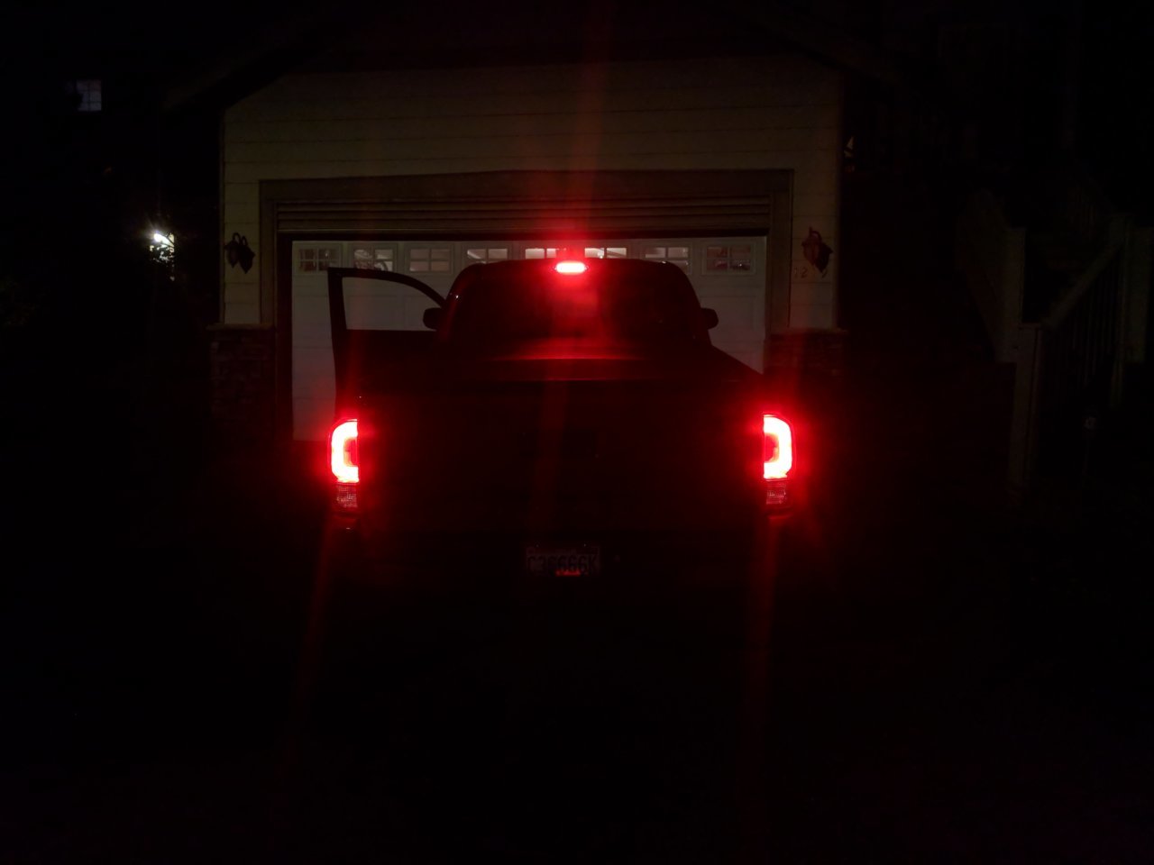

    Pics and a couple crappy vids!
    Before you all get angry, this was an end spot:
    The Rigid Ignite with the diffuser does not project down as much as I hoped, but as you approach objects, there is plenty of reflected light to see well:
    Backed up to the wrong house in this one! Hahaha!
    Sorry. The fam was tired after the long day, so I was doing this solo.

    Yes and yes. 921NA as a first try that I am just too damn happy with. I was gratuitously offered to beta test a set!

    Idea for that... take a spacer (or make one from an appropriate material - like bondo/putty knife) and sand it at a 45 degree angle. Then install between body and light. This will give it a downward cast you are looking for.

    That is a good idea, but my guess is that it would still be about the same due to the light projecting onto the bumper step. A thick 0deg spacer would help as it would reduce the distance to the end of the bumper.
    From what I saw, there is a lot of light to see things as they are approached at night. Looking through the rear window is the same or better than before. I will continue to check on it and will post some daylight shots.
    Also, I realized that the videos were taken with the license plate lights off. Sorry!
