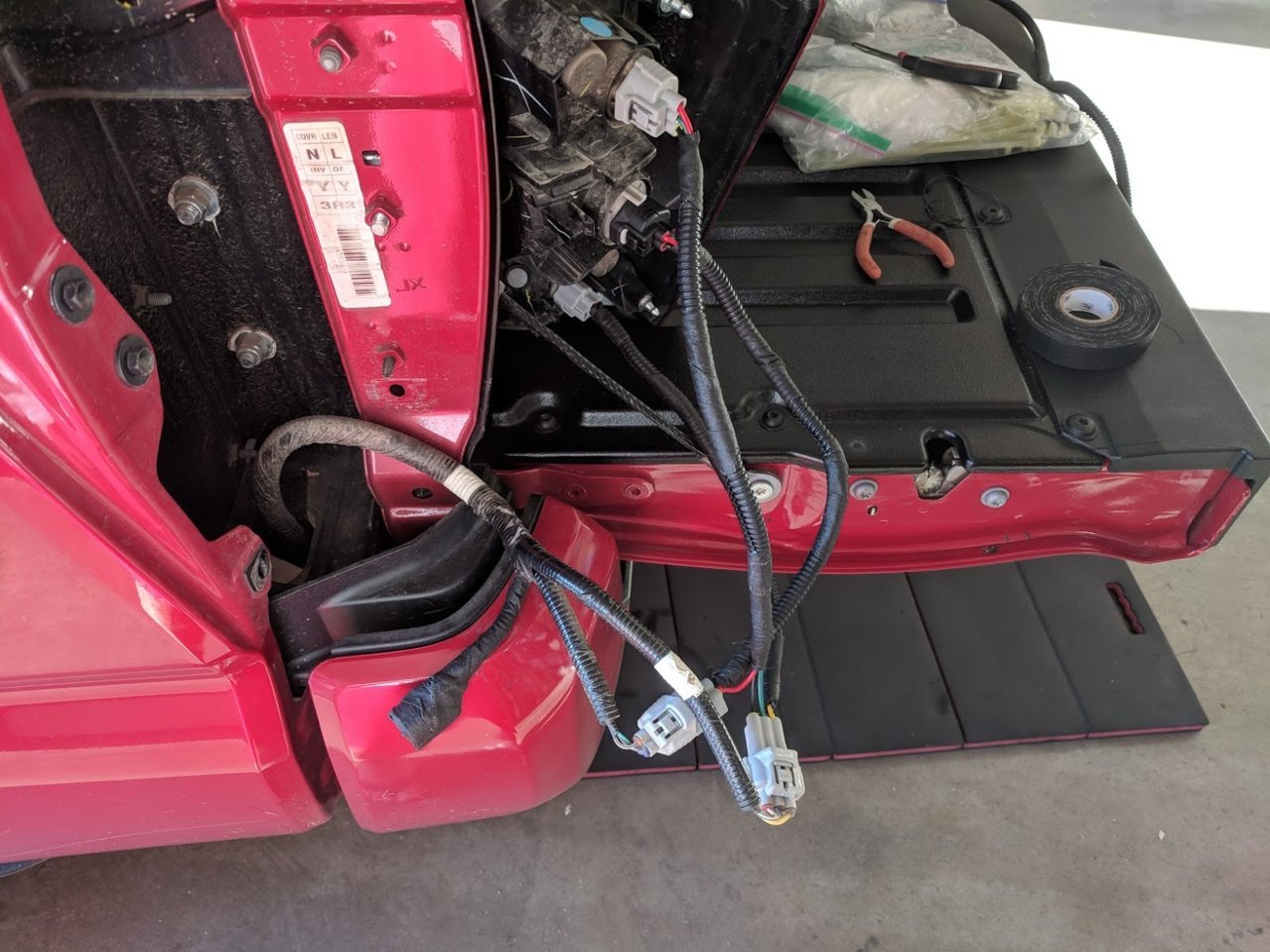

    I had some split loom lying around and finished up the installation.
    After this pic, I went back over each loom with the friction tape.
    Since I am happy with the single flush mount hooked into the right side harness, I capped the reverse connector on the left.

    It is a beta test for an upcoming plug-n-play kit that @NoOne and @mesojdm are working on.
    My setup with a single flush mount reverse light is on the previous page.

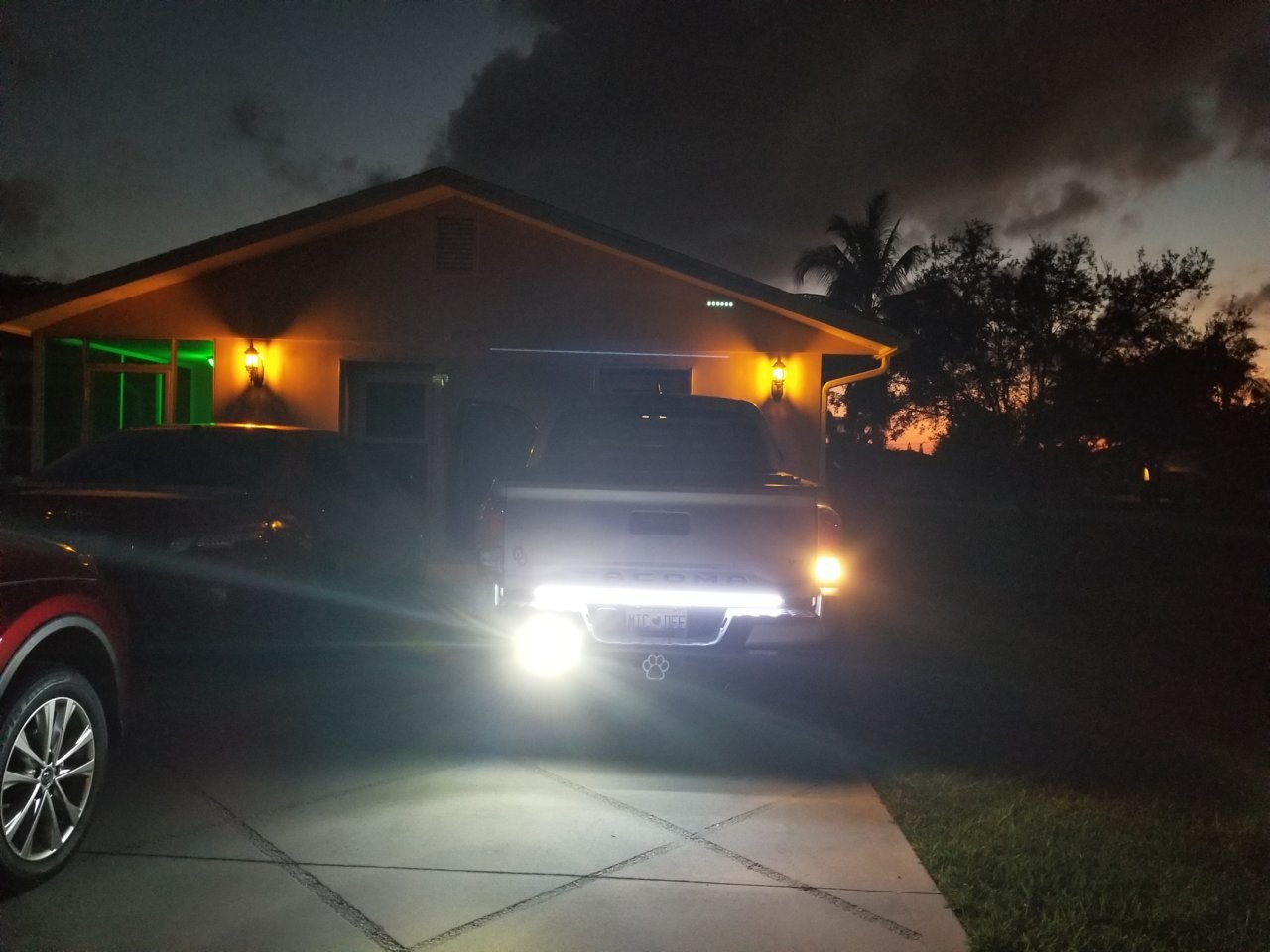

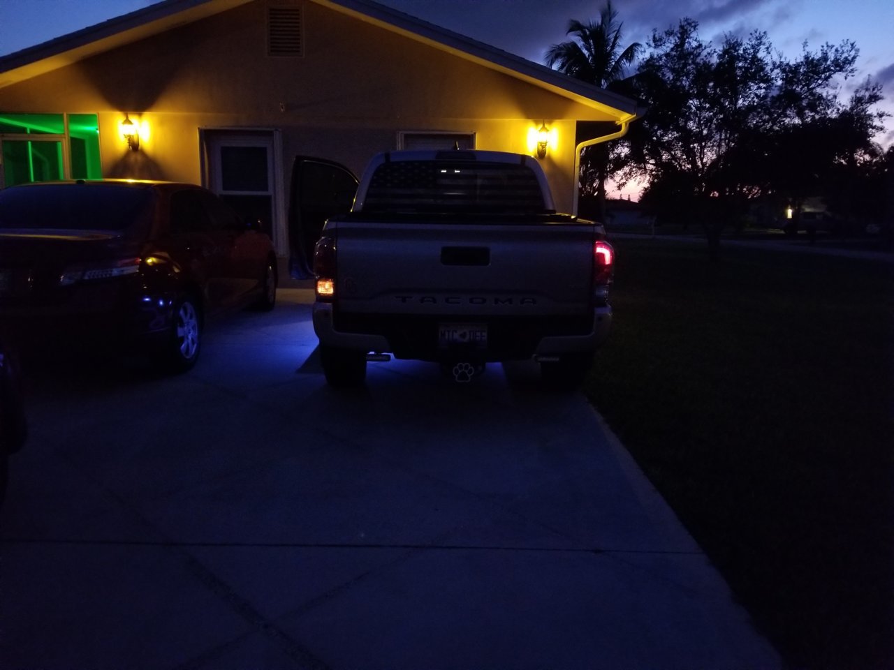

    I am one of the members here that received one of the prototypes. I was pursuing the same solution myself as can be seen from several of my previous posts in this thread.
    Top notch work! This harness has done everything I wanted to accomplish. Once these are in production, I expect there will be 2 options. One for the switchback and another for relocation alone. I have at this time stayed with incandescent bulbs, excluding revers of course, but may move to LED brake and blinker in the future.
    Stock blinker passenger relocation driver's side.
    Same with reverse.
    ToyoDrew, tonered and NoOne like this.

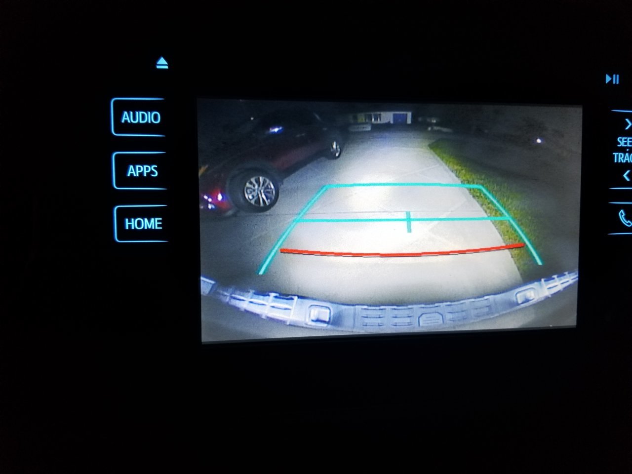

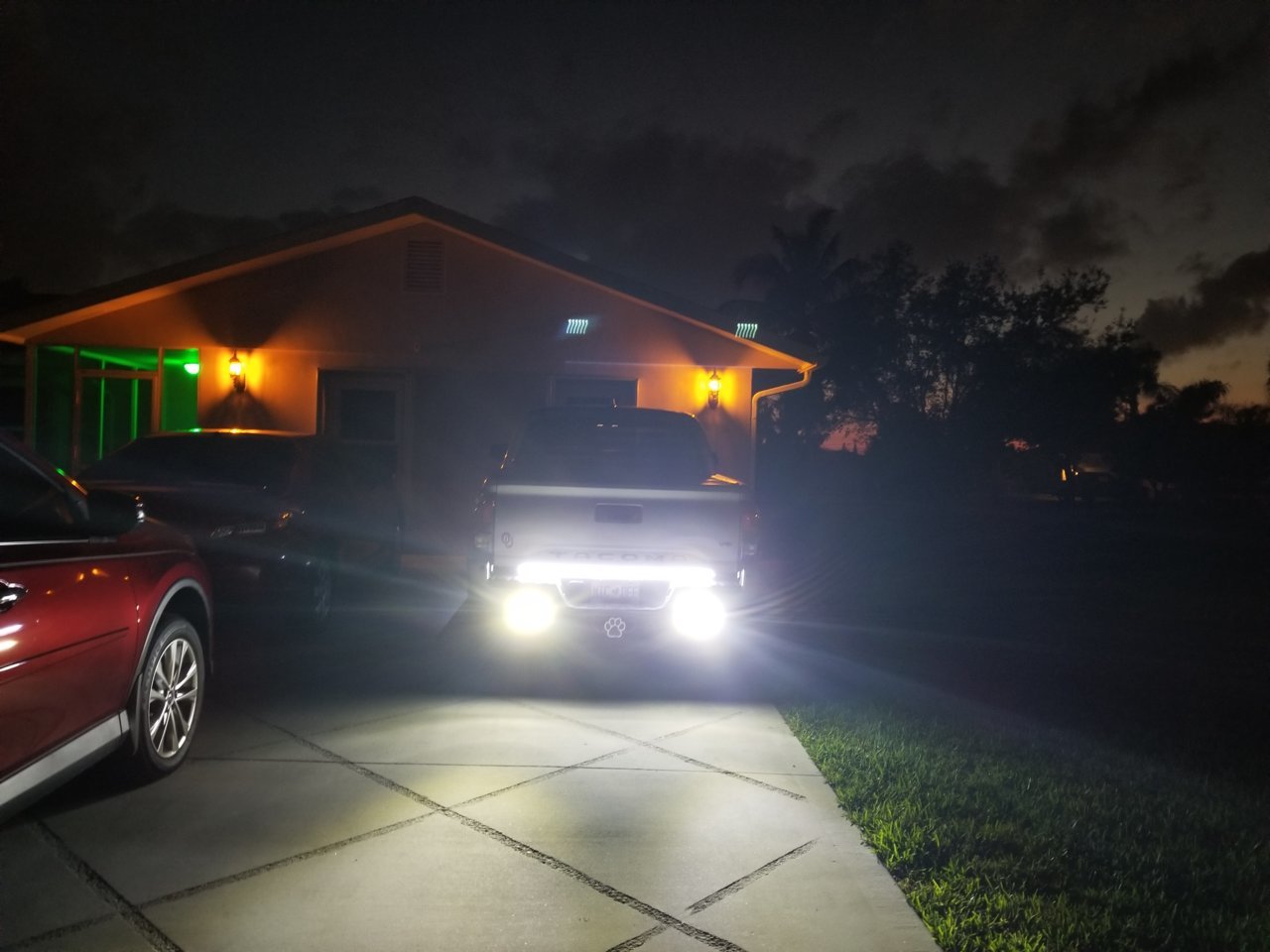

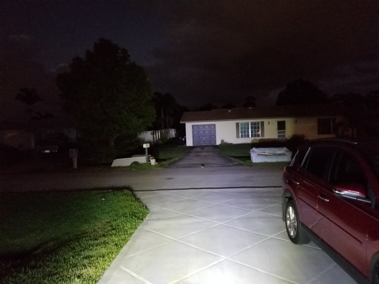

    Reverse output via camera stock passenger side, light bar driver's side.
    Both sides with light bar.
    Reverse light output from outside the truck.
    Standing a car length behind the truck.

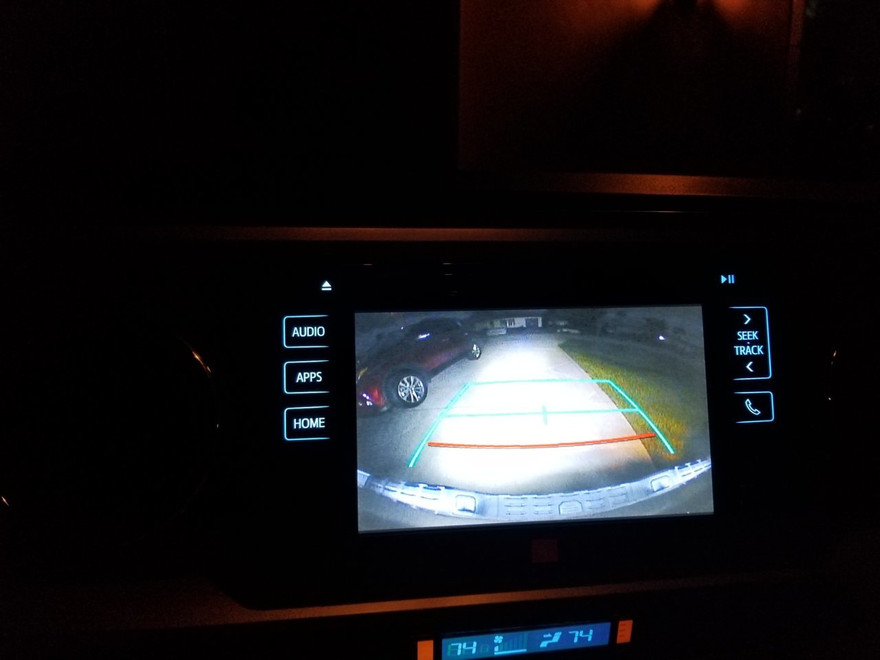

    I am not sure I am completely pleased with the position of the reverse pods. It is the OCD in me.:crazy: They have actually reduced the glare in the camera, I would assume this is due to the lights being positioned beneath the bumper. There is definitely a better throw, distance, of the light.
    The lights are level with the ground while the lower edge of the bumper is not. I am considering fabricating brackets to mount the pods. Currently they are on the rear most bolt of the bumper mount. The angle of the light pods can currently be adjusted up/down and left/right.
    If I were to make an "L" bracket and mount it on the inner bolt it would allow me to articulate the light bars on a third axis. The could then be adjusted to be parallel with the lower edge of the bumper rather than the ground. Additionally, it could bring the pods a bit father, 1/4" to 1" depending on the bracket and preference, under the truck. This MAY wait until I decide to do a LED conversion.

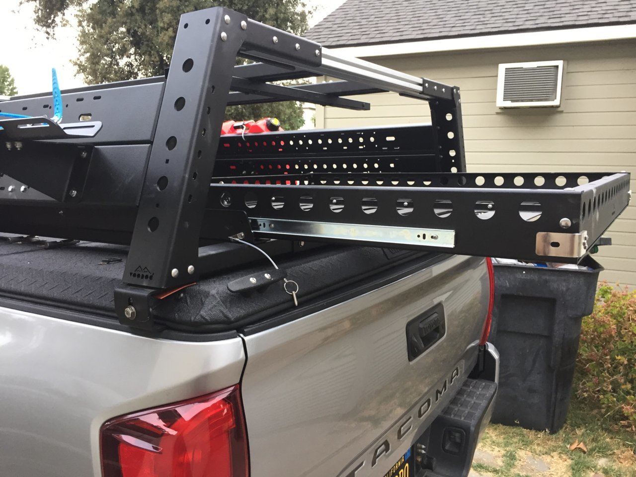

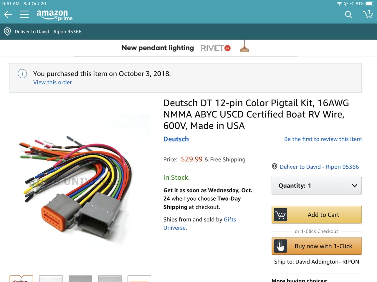

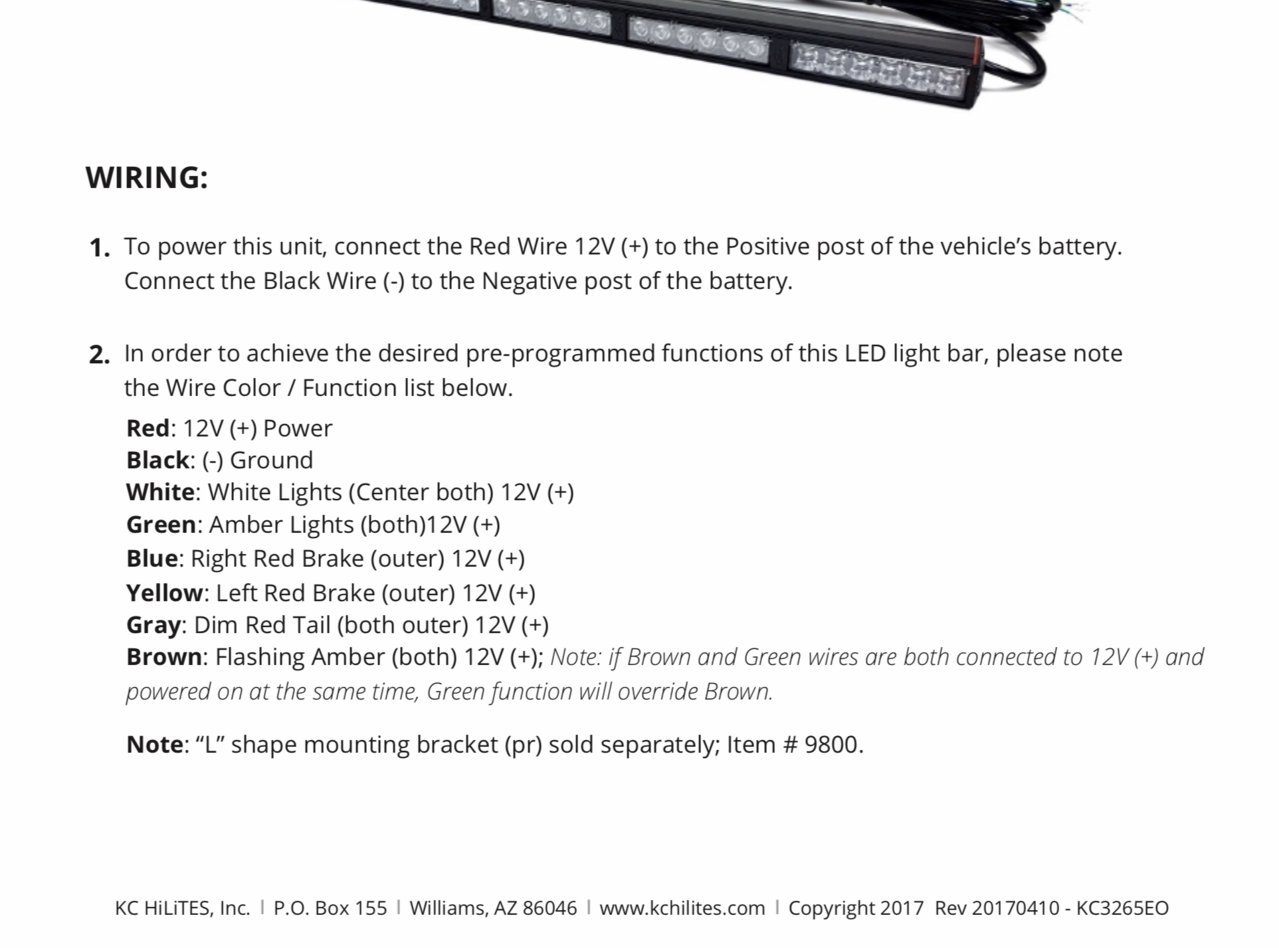

    Ok so a little off topic, but I have KB Voodoo rack that goes off and on from my truck. I am adding to it @KC HiLiTES multi function bar to serve as a third brake light and amber lights for off road dusty desert runs. The LED bar is SAE approved for street, how would I wire up brake and turn signal lights? I do many things well, but wiring diagrams are not my strong suit.
    The KC Hilites LED diagram is below, it has a single wire for red running lights to both ends, and one wire for left and one wire for right brake lights. I thought about using the amber lights as turn indicators but it only has one wire for both sides of the ambers. As you guys have discussed the Tacoma’s brake and turn signals are separate bulbs and halves of the tail light. I’m not interested in modding the OEM tail light set up, but how to make the LED brake and signal.
    HELP I NEED
    How do I wire the LED bar to give red running lights, brake lights on the ends, and turn signal indicators?
    If I tap the brake light for left and then for right of the LED bar then I lose turn signal, correct? Could I tap into the wiring of the trailer harness to preserve running light, brake, and turn signal flashing? Being LED would I need resistors for the turn signal function?
    My @KB Voodoo rack and I will be mounting the LED bar to the rear extruded aluminum cross bar
    Multifunction LED Bar
    Wiring
    I have this 12 pin plug to hook up the rack when it’s on, 8 pins for the LED bar and 2 more to power the cargo and area lights on the rack, and 1 power to my RTT cabin lights
