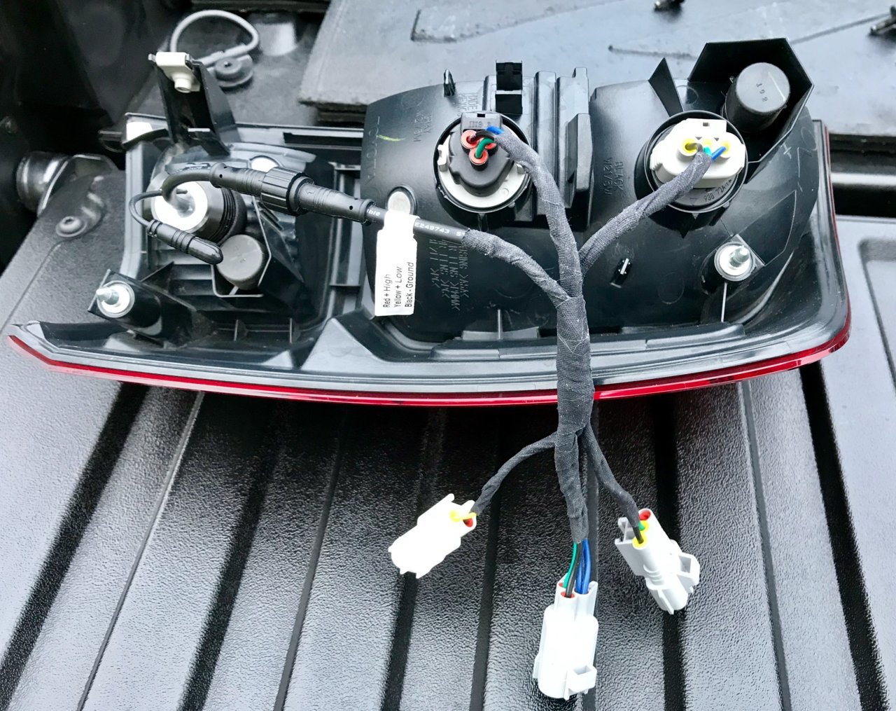

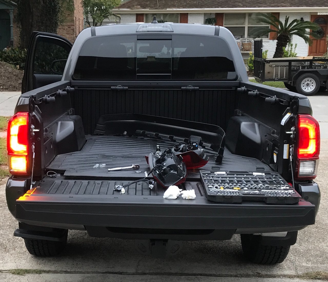

    I’m sorry it has taken so long, but changing trucks, travel and life have gotten in the way.
    Here is the switchback first harness installed.
    This is in operation... (Left Side).
    I used LED bulbs on left side, stock on right. This is running taillights, not brake/stop, which would be much brighter. Of course turn is switchback Triton V6, so is also white reverse in similar brightness.

    Sweet! I've already got my LEDs, tritons, and MESO adapters. Just need this. Are you going to make or sell some?

    They will be a MESO (@mesojdm ) product. He has everything to move forward, but he just has so many fires right now. They are coming!

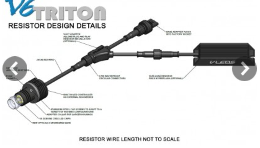

    Ok just wondering if you did. So this harness will have resistors for hyperflash wired in already?
    We got snow last night already! :eek:
  17. Nov 9, 2018 at 12:08 PM
    #717
    NoOne
    NoOne El Taco Guapo
    Feb 6, 2018
    #243575
    5,479
    Ø ©
    Gulf South
    2022 Tacoma DCLB OR (AT) - BC
    2018 SR5 - (Sold) 2018 OR - RIPieces 2022 OR - BluCrush
    No need for resistor with Triton V6. Won't need for Tail/Stop either.
