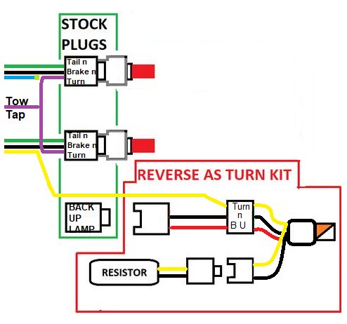

    Why? You are essentially combining TaaT and reverse/turn switchback. If your blink cycles are off it won’t look good.
    tonered and TC_Mic like this.

    Blink cycle?o_O Blink is controlled by same relay, it'll be in sync/unison. It'll be same as the "RAT" without the DiodeDyno thingies.

    What's the "tow tap"? That's essentially how my harness it, just with more plugs to make it plug and play.

    You’re going through the trailer combination circuit, you will have some delay. It just seems unnecessary.

    He’s using a trailer wiring harness/circuitry to access a combined signal (essentially TaaT).

    Hey, I look forward to seeing your finished project. Show me.

    that would look kinda funky with amber bottom and upper red flashing at the same time.
