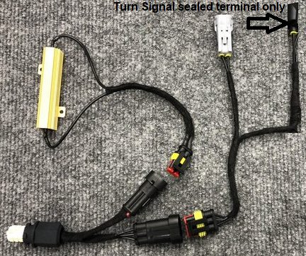

    Put in a stage 1 today on a local truck. Install took about 5 minutes and that’s with B.S’n. Only mod that’s been done were LED reverse lights.
    Harness length, layout, and bulb adapter were flawless. First, I left 1 side stock to compare. The running light—>brake light had a good distinctive change. The 7443 LEDS killed the stock halogens and the FULL “C” looked awesome. Next was the turn/reverse. The stage 1 reverse threw about the same amount as the drop in Led on the other side. Not much more I could ask for with the given parameters.
    Last was the turn signal. I’m very pleased with the color and reflection off the stock chrome bowl. Bulb depth is tuned perfect for optimal light coverage.
    The amber light has much more intensity (which is another big plus) because it does not get refracted going through a lens(like the upper red turn signal)
    I tested it without the plug in resistor for shits and giggles..already knew the outcome and yes it had hyperflash. Plugged in the 10ohm and fixed it with no problem.

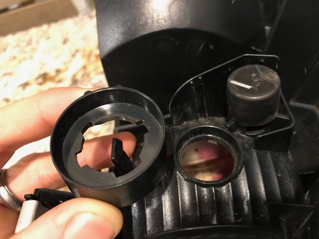

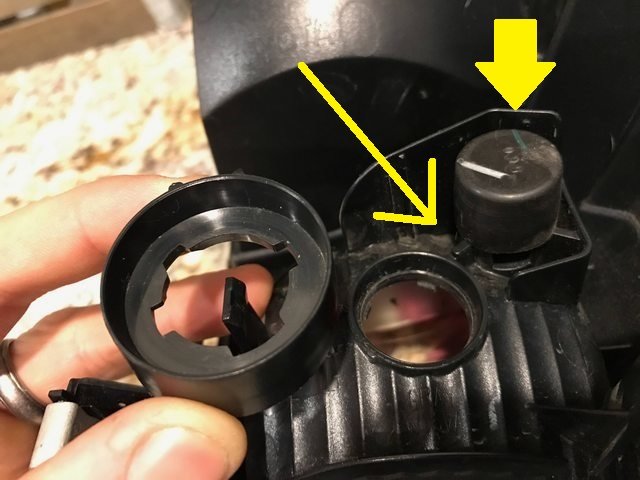

    A note for those who are doing the Triton v6 conversion:
    The large yellow arrow points to a "breather" cap that can and should be pulled off when starting this process and replaced after. This breather cap will put pressure on your adapter and create a mis-alignment while curing/bonding. It may also get in the way while using a step-bit to enlarge the socket hole.
    The thin yellow arrow points to a ridge that you will want to cut or file down to flush with the top of the bulb socket opening. if you do not, it will interfere with the adapter sitting all the way down, flush. This will create a mis-alignment during curing-bonding as well.
    Hope that helps...

    Just to be clear, the thin yellow line is pointing to the ridge at the 8 o'clock position of the breather cap, correct?
  14. Jan 31, 2019 at 7:30 AM
    #1014
    MESO
    MESO Major Modder Vendor
    Feb 16, 2015
    #148809
    16,294
    State of Jefferson
    2016 DCLB TRD HELLCAT SWAP
    Correct. I’m working on a full detailed write up as we speak

    How about your original (Version 1) minus the other light connectors (stop n tail, turn and tail) and only the sealed terminal for the signal tap, how much? Doing upper n lower STOP n TAIL, relocating TURN to BU lamp.
