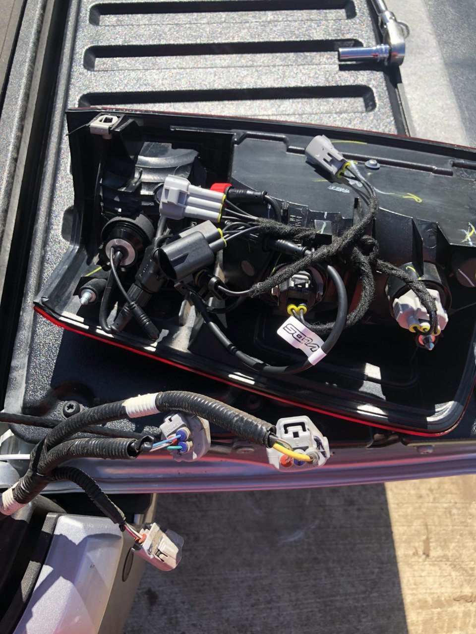

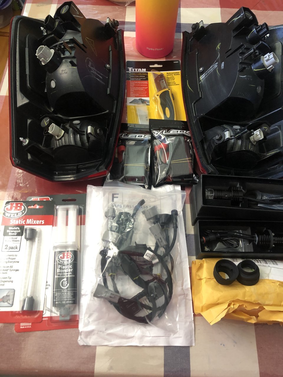

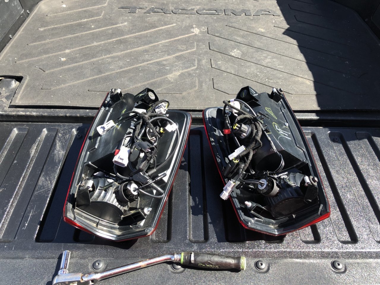

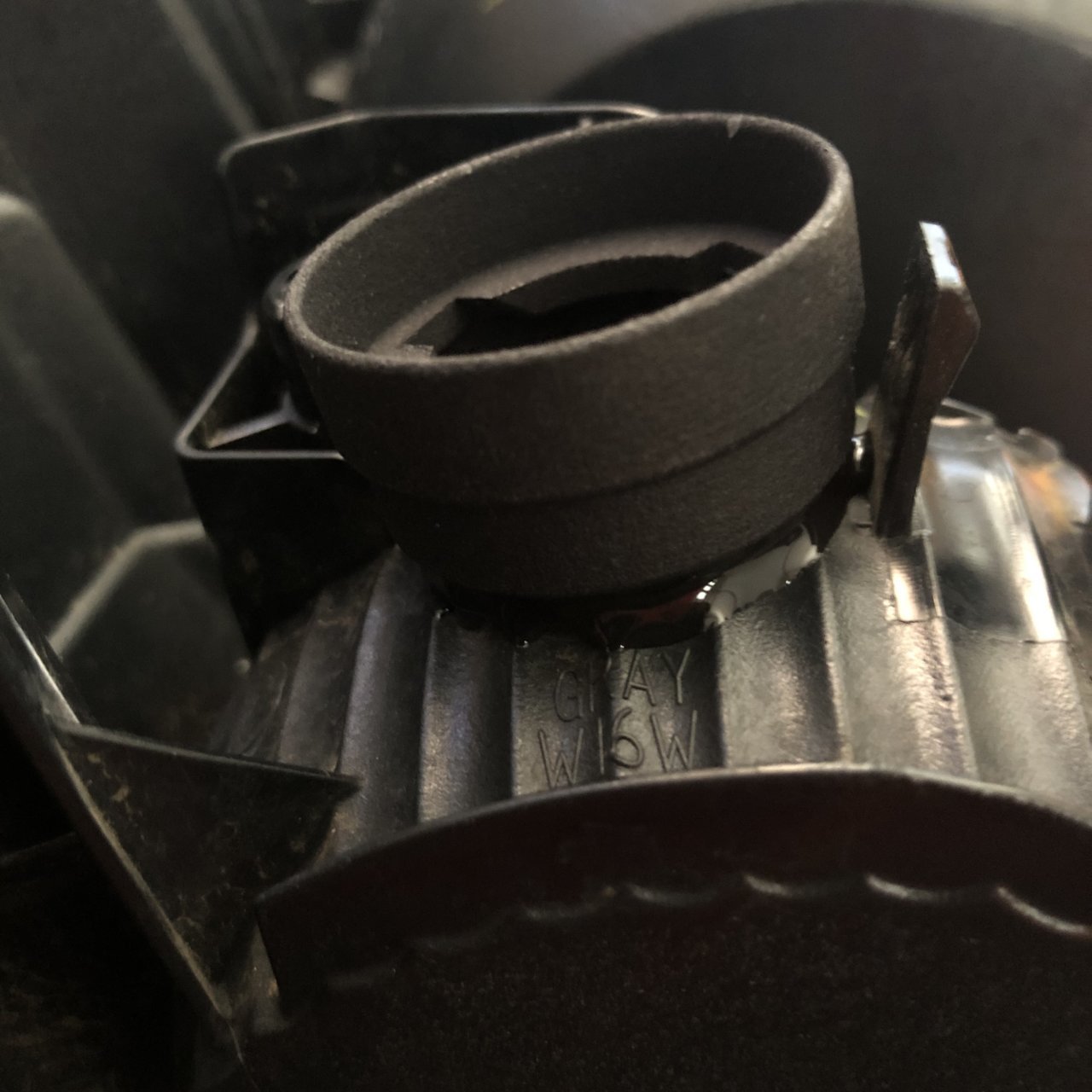

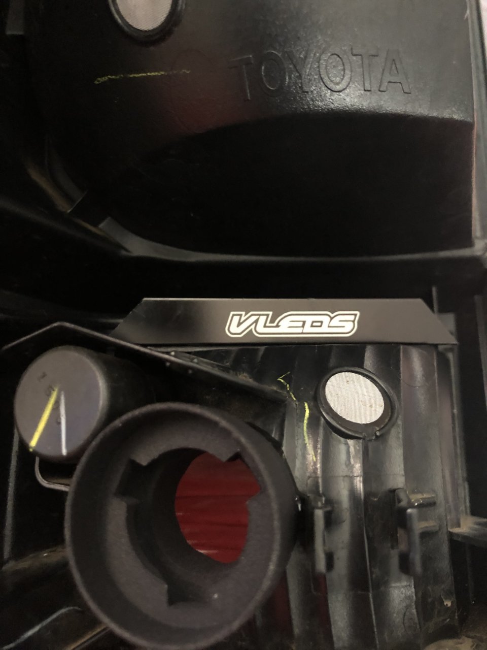

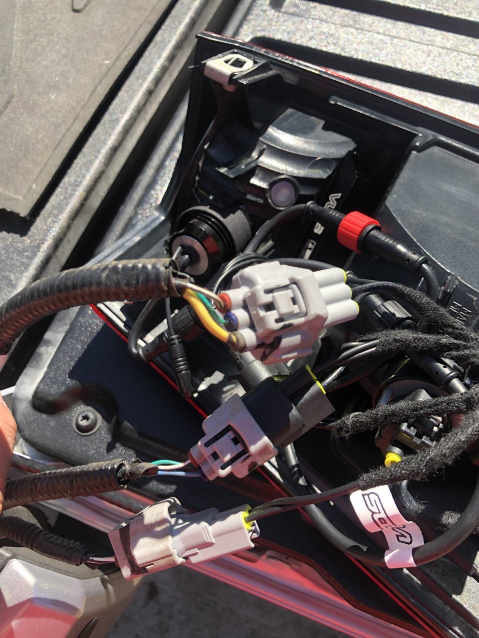

    Finally got the last piece of the puzzle over the weekend. Meso JDM Stage 2 Tail light harness. Been building this package since early 2018. 3F691E4A-20DB-49B0-A325-1744D4ECD8E7.jpg
    This harness quality is factory or better. Put it this way it’s legit as fuck!
    I didn’t have any fancy tools to open up the factory light socket. So I had to improvise the method of just using a razor knife. Here’s what I did to make it easy. And it’s up to you. But it was like using a hot knife cutting butter.
    I heated up the blade and carved the inner lip out so the new Meso JDM socket adapter will snap right in.
    Once it fits. Remove the adapter and run a bead of JB weld (I used plastic bonding tube in black) and push it back in. Allow the recommended drying time before twisting in the clad switchback bulbs.
    I installed the Vled resistor pack above the reverse light bucket. *** note - I had to remove mines after because it was not needed. You will know. When you test your blinker it will not work. I think it’s becuase I don’t have any other turn signal Led bulbs installed.***
    The harness is super straight forward. Plug and play.
    Only tools needed to remove the taillight was a 10mm socket.
    The factory harness plugs right into the Meso Jdm harness.
    It was super retarded easy! Plug it in and button it back up.
    You now brought sexy back into the newer Tacoma’s by adding them amber rear turn signal!!!
    Over the Meso Jdm Stage 2 harness on a scale 1-10 is straight up 11!!! Thanks again for making another outstanding product! I didn’t post a video of the lights in action becuase we all know already what it looks like as many have been posted here!
    Thanks you Stew!!! Now I need to do my headlight corner switch back! :) from Hawaii with Love!
