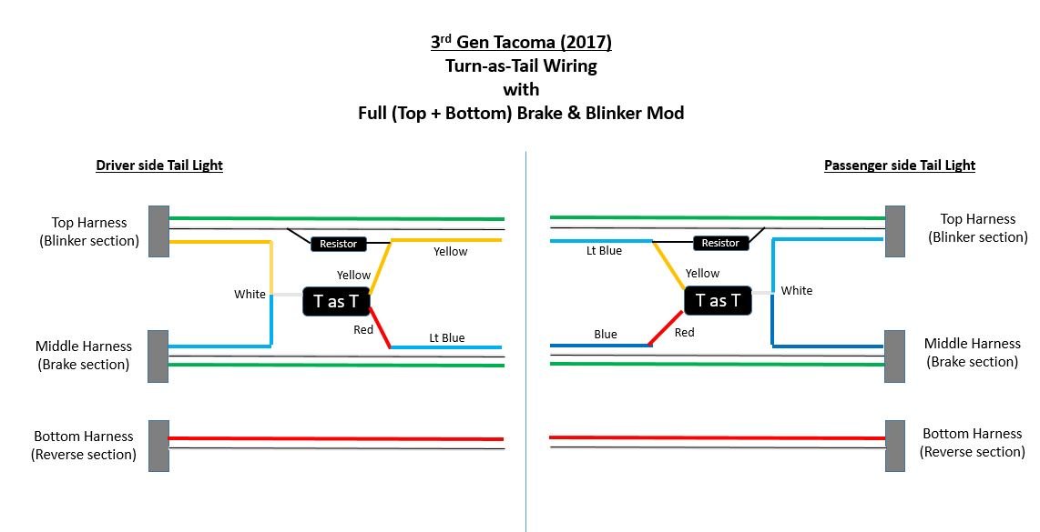

    I am toying with modding my tail lights. I much prefer to build an adapter harness (with male and female connectors) rather than cut or splice on the stock wiring harness. That way I can undo it quickly or troubleshoot without major headache.
    You can buy each of the individual repair connectors from Toyota at like $8 a pop. For 3 male and 3 female per side, that gets really expensive fast. Anybody aware of any cheaper source for male and female connectors that mate to these tail harnesses. A trailer T harness might be one source, but I haven't found any that look good reasonably cheap.
    Any suggestions? Maybe i can do it all from the 7 pin trailer harness. Haven't thought about that yet.

    are you jest splicing the 2 wires together?

    No, the black box in his wiring diagram is a diode dynamics tail as turn module. It takes the turn and the brake and sends each signal through to the bulbs, or leds if you install them in plce of bulbs.
    So the entire upper and lower portions of the tail lights are then blinker, running and brake; much like trailes and some cars.

    Ordered my lights and diode dynamics module today.

    Like TC_Mike says, they are being spliced into the black box shown in the diagram. The black boxes are Diode Dynamics DIY Turn-as-Tail (TaT) modules. You can see in my diagram that the color of the wires change color when it's close to the TaT? That's cause the wires coming out of the TaT black box are red, yellow, and white, and those are then spliced to the Tacoma wires (yellow, blue, or light blue)...so those color changes indicate where the splicing is happening.
    Also note, you'll probably have to add resistors as well...so you will need to splice that in as well. I updated my diagram with the resistors added.

    Did you notice that resistors were only needed when the headlights are turned on? They work fine when they're not on, go figure lol.

    I did notice this (once I finally got to drive my Taco again...wife had it most of the week while I was stuck biking to/from work). :rolleyes: I also noticed that it would happen when I was pressing on the brakes and then turning on the turn signal.
    There are some LEDs that do not cause the hyperblinking (I've seen a few reviews confirming this by other TW members)...but I'm not sure if they would also work without a resistor in this dual brake/blinker configuration with the Turn-as-Tail.

    I love the diagram, it really helps a noob with wiring. I do have question regarding using the trailer harness to accomplish that, has anyone figured that method out? Would resistors still be needed?
