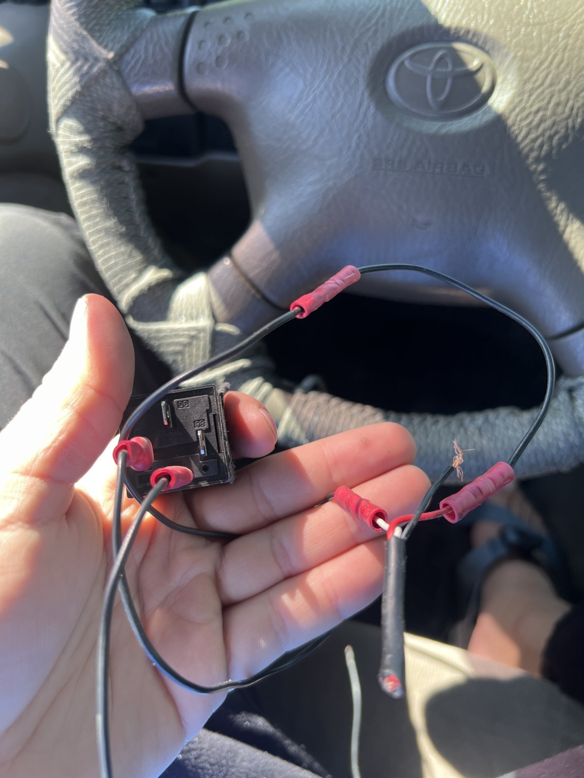

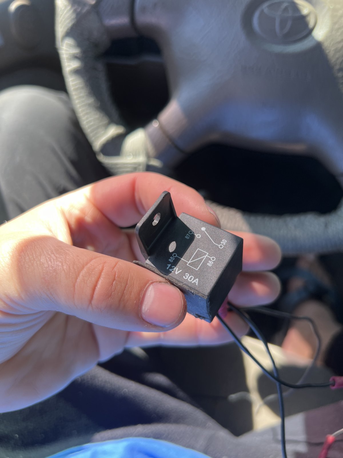

    Okay so I pulled this out of the interior fuse box. Definitely doesn’t look OEM and was connected to a wire that went nowhere. Nothing changed after removing it. I’m trying to remove every and all trailer wiring because I’m not going ever going to tow anything. When installing trailer harnesses do you splice wires with the tail lights? Wondering if there’s some faulty wiring because of that.image.jpg image.jpg

    Doesn’t look like an OEM relay and while no way to know for sure what it’s from, probably some kind of aftermarket light or something.
    When I’ve installed trailer light wiring (non-oem) it’s been plug and play except for running a ground wire. I’ve never had to splice into a harness, that doesn’t mean someone didn’t.
