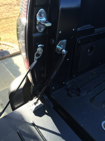

    Your 2017 has a tailgate assist from the factory, I'm adapting the 3rd gen set up to the 2nd gen

    I just removed the ez down tailgate assist POS sending back to Amazon

    Anyone know if the assist pistons will work with a tailgate that has a steel reinforcement top?

    I dont think they work that great even on a regular tailgate

    I have a Relentless Fab Tailgate reinforcement plate (aluminum) on my ‘15 DCSB. My wife has a hard time opening the tailgate and we use it quite often. Saw some great ideas in this post!
    Great idea man. Are they still working well for you?
    Thank you for posting the part #’s!
    Did you try one 1st and saw it wasn’t enough or you started with 2 from the get go?
    Also, is it harder to close with one dampener installed? Or 2?
    Thank you!

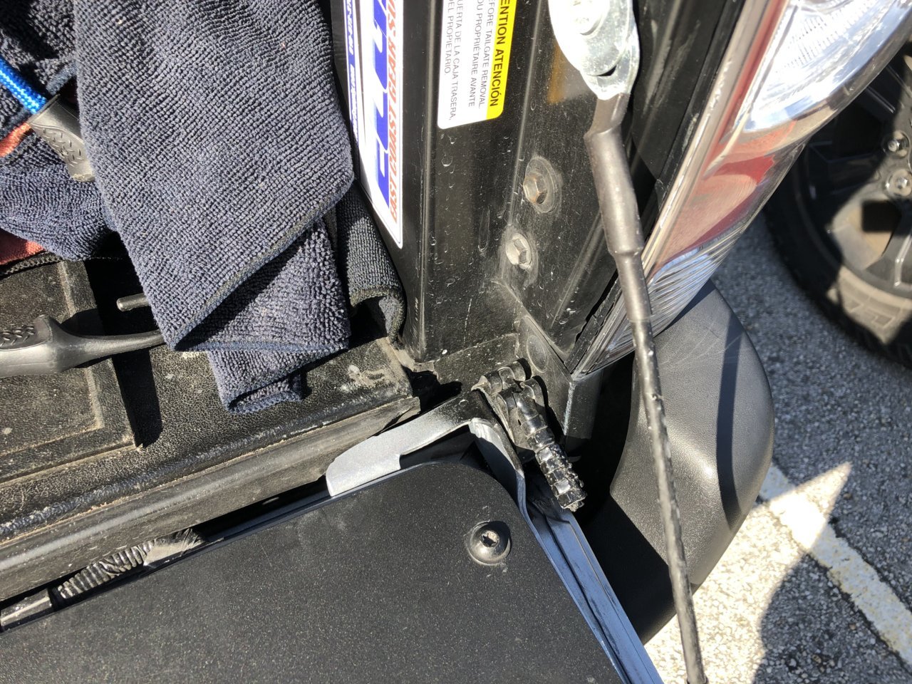

    Mine uses no oz strut, it utilizes the 3rd gen assist parts, works perfect

    That sounds like it will work great! Do you have the part #’s handy? Also, is there a write-up on this? I’m not a mechanic but “fairly” handy.

    Mine was working good for a while, then one day i dropped the tailgate and the screws pulled out of the tailgate. I was none pleased. Going to look into the 3rd gen on a 2nd gen one.

    Its alittle awkward but will go on and work

    True, I did the two pivot point brackets. The bracket that was bolted to the tailgate, had to use sheet metal screws. Not sure if i could get some nuts sqeezed in the tailgate. Guess I haven't tried. Maybe next spring. I installed some bed stiffners so made less room for the bracket on the bed side. I have to reevaluate. Feel like I'm drilling too many feakin holes.

    The 3rd gen to 2nd gen tailgate assist mod does not require any holes to be drilled, you have to enlarge a couple holes that are already there, and they can't be seen anyways. Also uses factory 3rd gen parts with the exception of the hinge

    I did the 3rd gen damper conversion Christian sells - love the functionality with my heavier than stock tailgate.
    Be aware the install is a bit more than a bolt-on - you should watch his video to understand the cutting/grinding/drilling required. I pity anyone that tries to do it without a 4.5" angle grinder. :sawzall:
