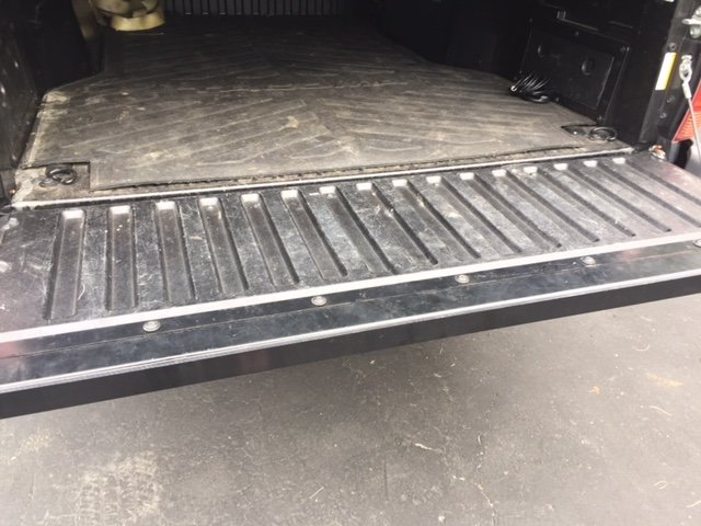

    I swapped a couple of emails with Chad the day the truck went into the body shop and had my replacement cap three days later to install when I picked the truck up. The new smooth powder coat matches my base model bumper VERY well. He's not lying when he says to get the gasket material as high as possible. I thought I had it high enough, but it just wasn't. I have just a tiny bit sticking out, but I'm not going to worry about it.
    Hands down, whatever shop that Chad is currently using for his powder coat seems to know their stuff. I've had it on the truck since May and haven't gone easy on it. I've abused it with firewood, sailing gear, paddle boards, bikes, and coolers and the powder coat and it's holding up great!

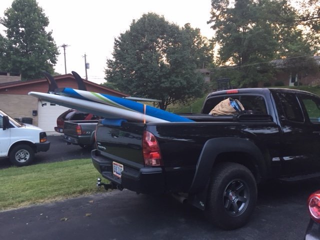

    It's handled the weight of our paddle boards like a champ, where the OEM plastic one was getting pretty wobbly before. The pool noodle is just there to protect the boards.

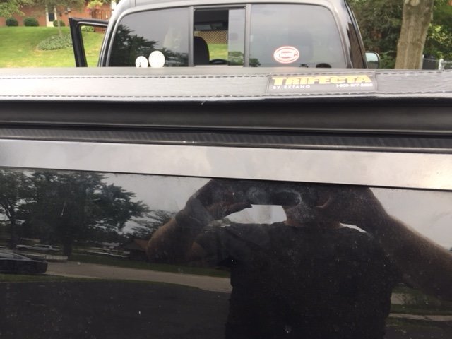

    I had issues with my tonneau cover sealing, so I used some automotive adhesive and 1/4" delrin bar to make a top plate. This is the stuff that they use to hold badges on, so it's not going anywhere.

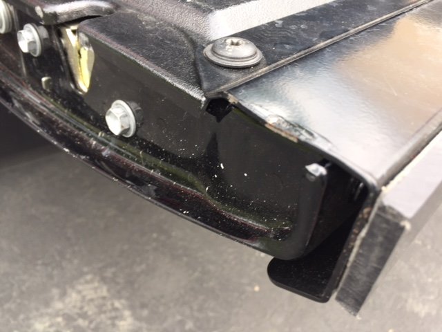

    The only issue that I've had is that it seems to keep banging one of the bed bolts on the left side of the truck and that's caused a little dent. Honestly, this is probably because I didn't center it well enough putting it on.

    How large are your paddle boards? I just bought a 10’6” one. I don’t have a rack installed so I purchased a removable soft roof racks, but I felt very uneasy driving down the freeway (at 40 mph). Someone suggested I transport it in my truck’s bed, but I’m worried it will stick out far.
    Any suggestions?

    My wife's is 9' and mine is 10'. They seemed pretty solid at 65 mph with the tips tucked under my tonneu and a strap over the back. I found the tailgate was leaving indentations in the bottom of the boards, so I put the pool noodle under.
    I've got a 6' bed, so that only leaves me with 4' hanging over the tailgate.
