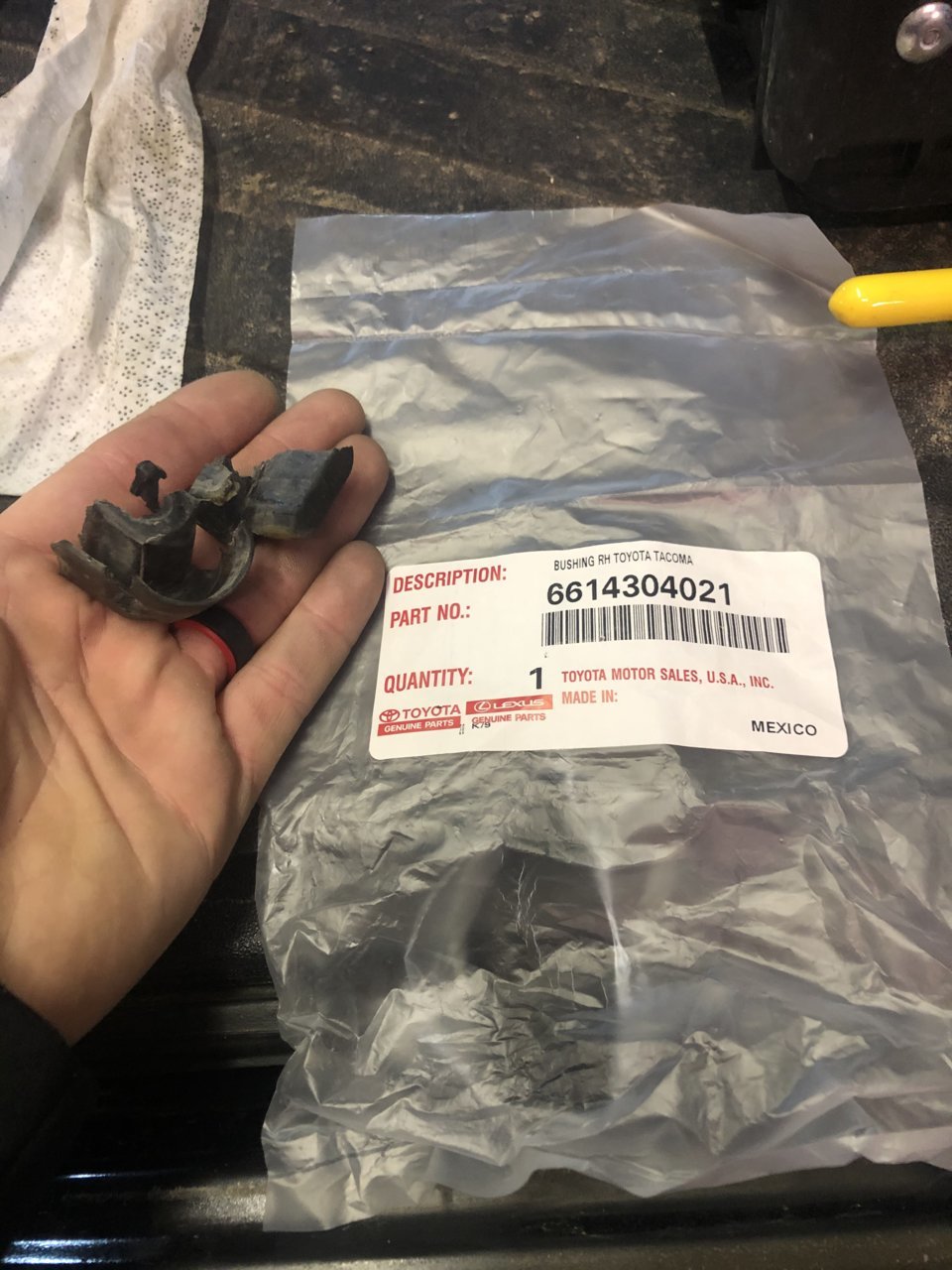

    I’m sure this has been posted before, but figured I’d say something anyway. There are no original thoughts anymore.
    Tailgate damper failed earlier this week. Been running a Mobtown plate for awhile now, so I’m guessing the extra weight may have contributed to its failure.
    Looking at parts diagram and the thread on here about the issues on the early 3rd Gens. Wind up at the dealership Parts dept, asking what the Damper costs. 2 parts that total over $200. Leave, deciding not to panic buy parts just because something is broken.
    Finally find the time to take the tailgate off, and all that’s broken is the plastic piece in the hinge.
    $5.96 later it’s fixed.

    200 bones ouch, I recently discovered this myself.

    Thanks for posting the part number. I think there are also 3D printed versions floating around that are supposed to last longer.
