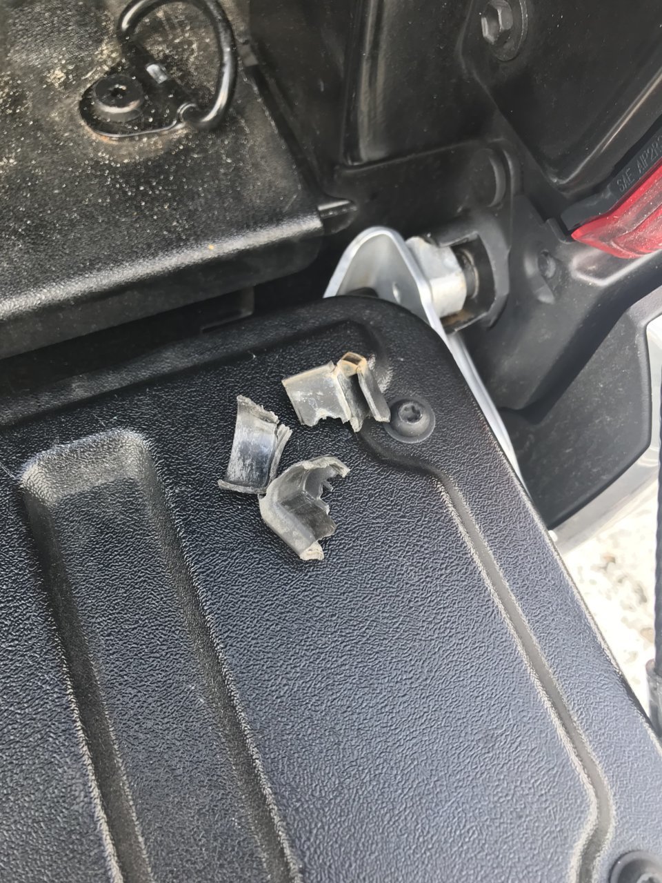

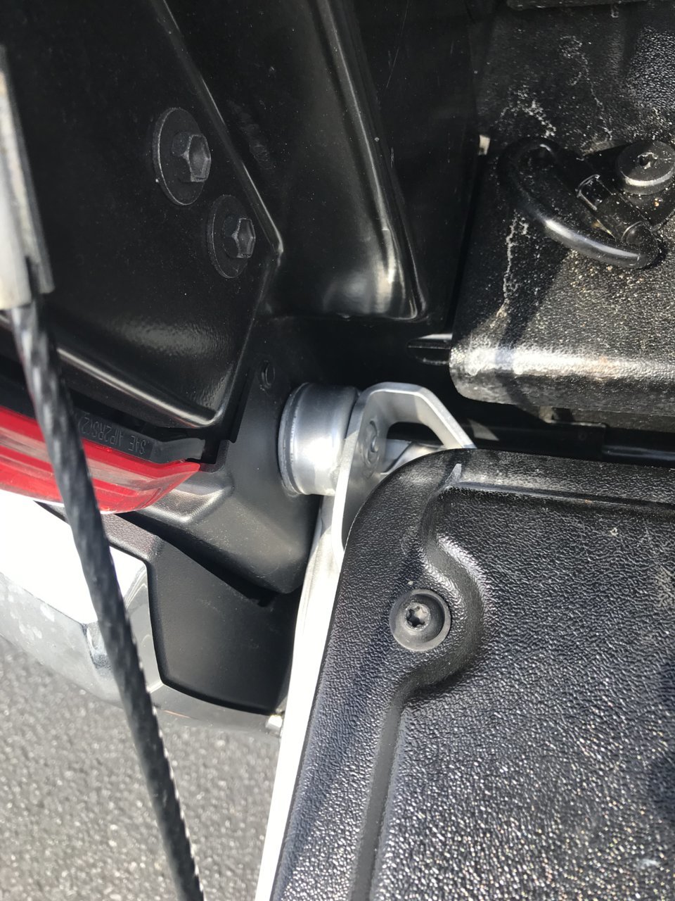

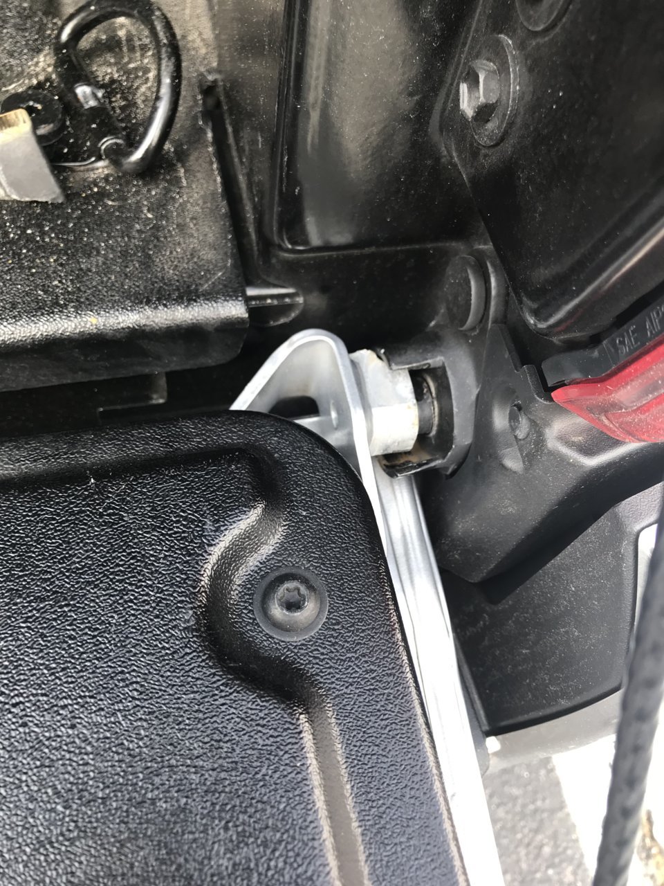

    Part of my tailgate broke at the pivot point and now the latch does not catch when lowering the tailgate. Easy fix? Or should I take it to the dealer for a specific part. Thanks! First picture is the good side second picture is where it broke.
    DustStorm4x4 likes this.
  2. Mar 10, 2019 at 12:25 PM
    Lunabird
    Lunabird Well-Known Member
    Dec 17, 2015
    #172467
    323
    Easy fix. Just get a new damper from the dealership

  5. Mar 11, 2019 at 11:58 AM
    Deacon Blues
    Deacon Blues Well-Known Member
    Sep 7, 2017
    #229363
    1,468
    Colorado
    2017 SR5
  6. Mar 11, 2019 at 12:00 PM
    sandyTrd87
    sandyTrd87 Well-Known Member
    Sep 27, 2015
    #165297
    343
    Socal
    Bilstien 5100's x4 Dobinson 448 springs, rear 2inch AAL
    i dont see what broke ?
    also get a tailgate lock to prevent theft
