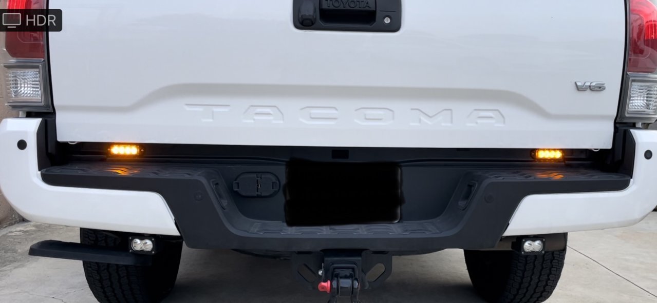

    This is what I did and I like this better then the light bar. Only have signal & brake connected. Running light not connected because the LED I choose is too bright.

    Almost every time I see those long “light bars” underneath tailgates on trucks, some bulbs are usually burnt out and just looks bad/cheap.
    So many of them are off centre too haha. Hard pass for me.:)

    This is actually not bad.

    Which LEDs are these? And how did you wire it up? This looks great

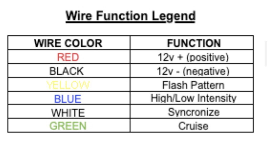

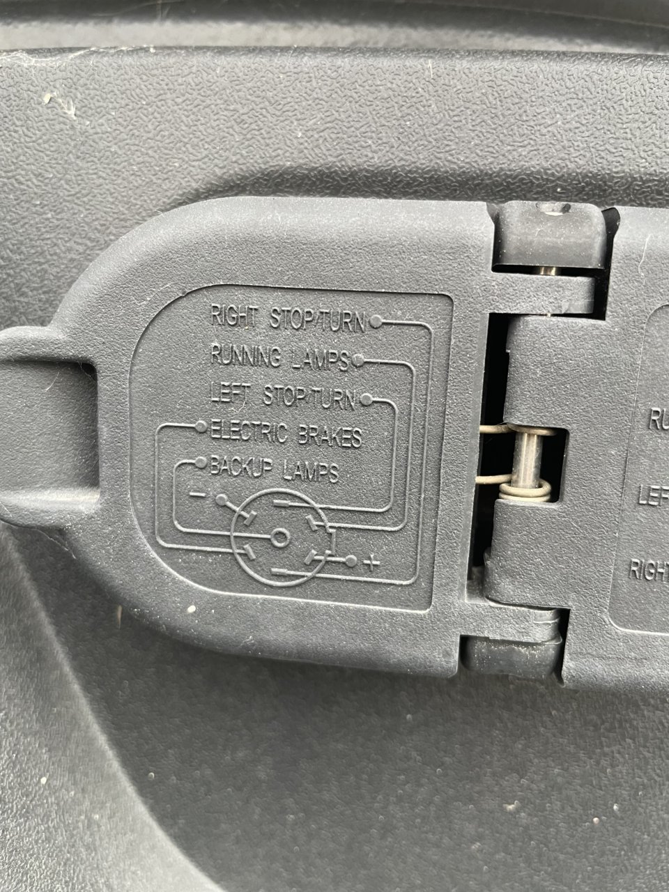

    Wiring instructions is pretty simple. At your 7pin/4pin tow connector, it has everything you need to connect your LED to it. I disconnect the connector behind the bumper and connect it there. If your light is a low current draw and you are connecting it to the 7/4pin connector, I don’t think you will need relays. Left LED positive to left stop/turn, right LED positive to right stop/turn, LED negative to ground. If it has a running light connect it to running light.
    This is what I used:
    Edited: I removed the link because that company suck. 4 lights lasted only 2-4 months each. I now use the Federal Signal 4200s.
    I recommend you get something else if you like running light, just a regular LED. The way this LED is design, the running light will have the same brightness as the brake & turning. So if your running light is on, you won’t see your brake or signal on the LED because it’s constant on(your oem light is still function like normal). This LED is not design for this purpose and that’s why I didn’t connect the running light. I’m happy with just signal, brake, & strobe.
    Wiring for this LED: both LED red to positive, both LED black to ground, left LED green to left stop/turn, right LED green to right stop/turn, both LED blue to switch & relay for manual strobe (optional), yellow is to change strobe pattern connect to a momentary switch.
