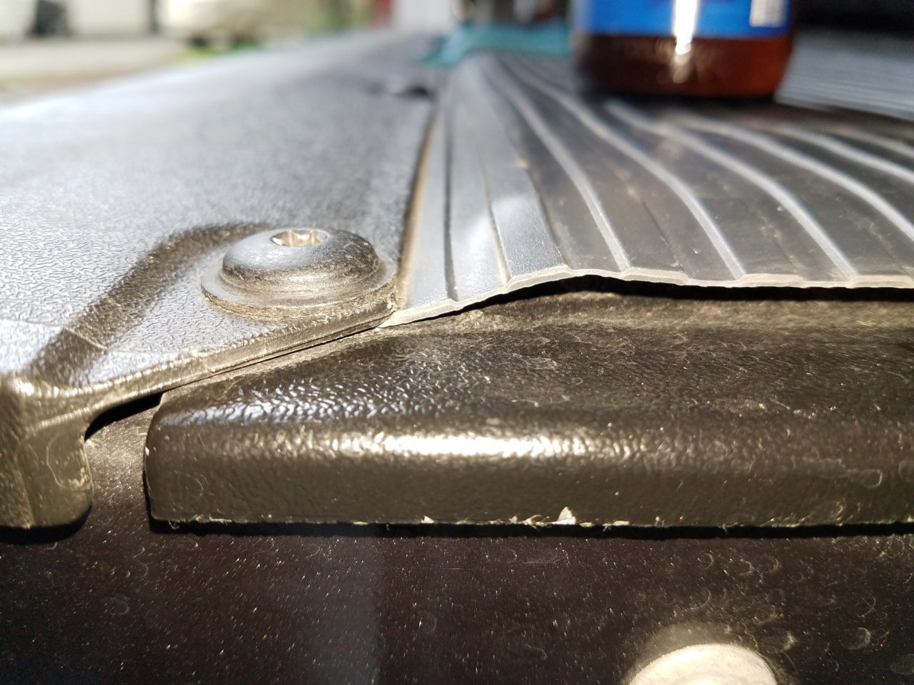

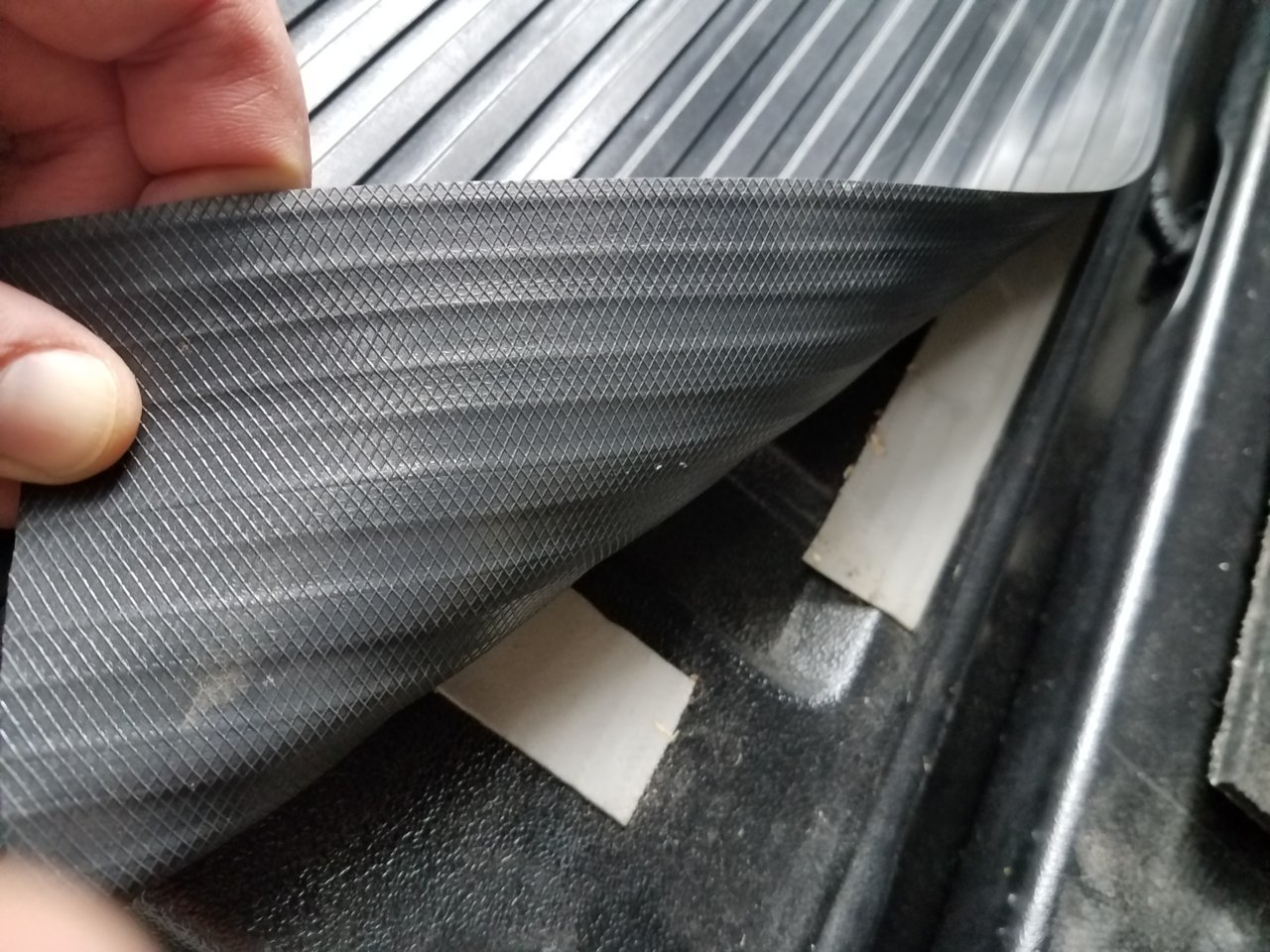

    I tucked it under the lip and then used outdoor double sided mounting tape on the other edges.

    The material extends an inch or two under the plastic cap and the screws go through the material.

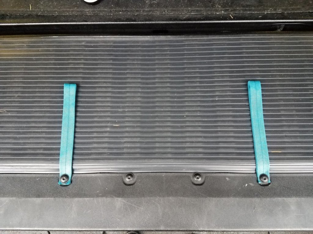

    What do you use those blue straps/handles for?

    The make it easier to close the tailgate when I camp in the back.

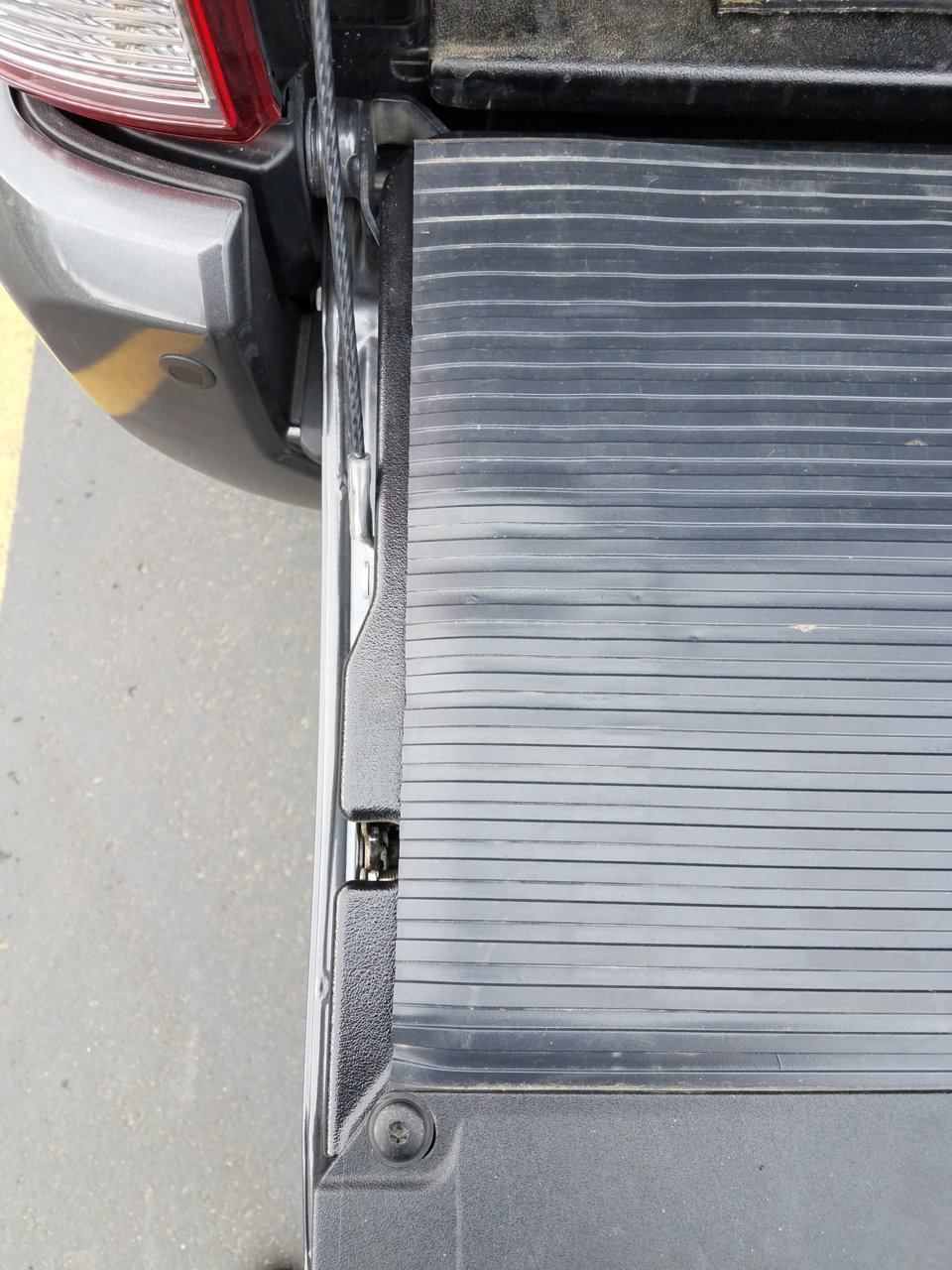

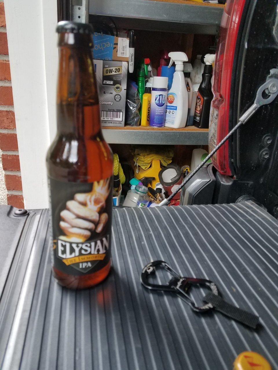

    Here's a couple more showing how it is installed. Makes it less slippery too and holds the beer in place. I've had this on for two years now.
