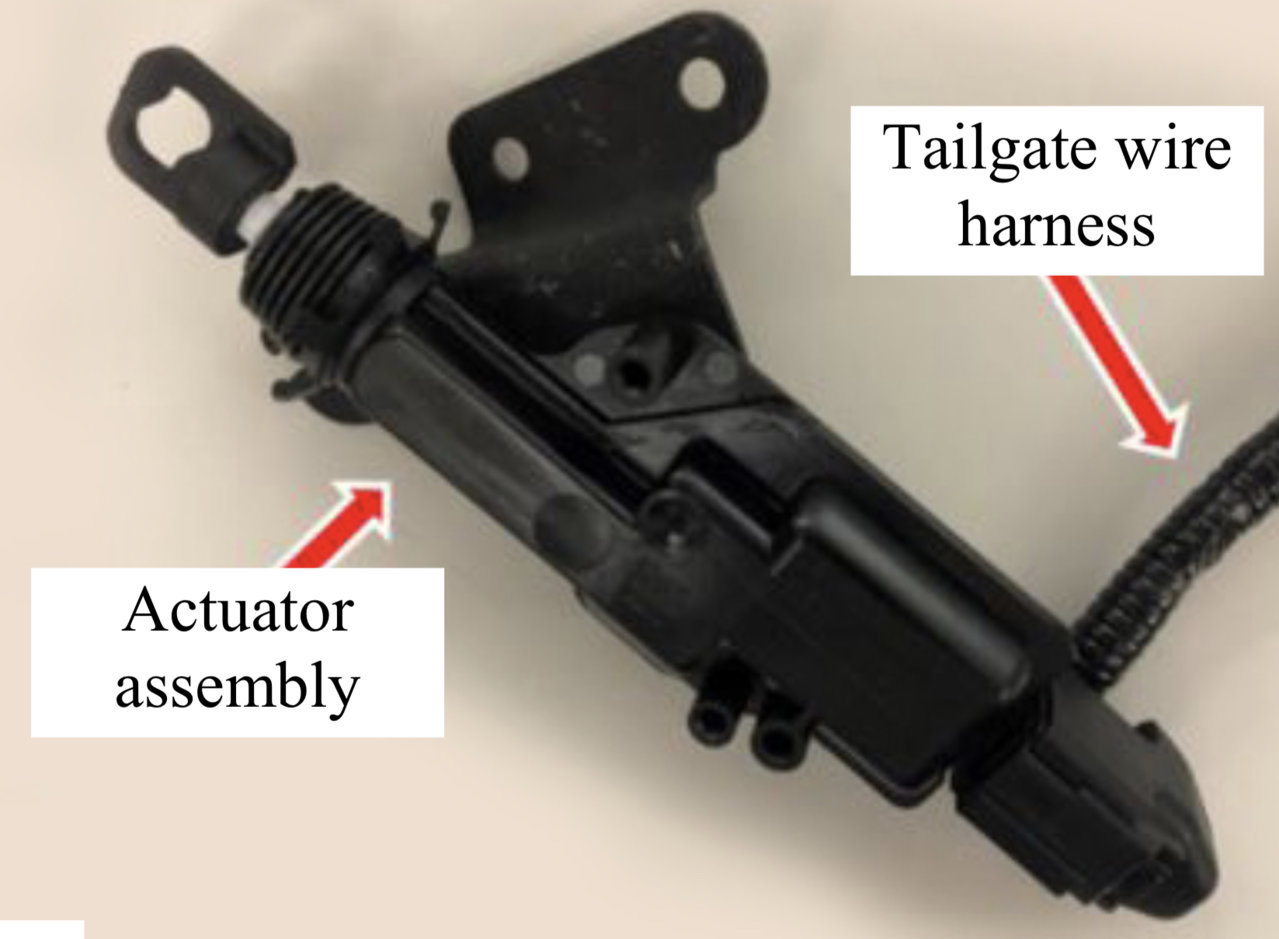

    Is the actuator base metal for the Toyota kit? I think the one that @KTJO 4x4 sales is aluminum, if im not mistaken.

    Yeah, it’s attached to a black metal base.

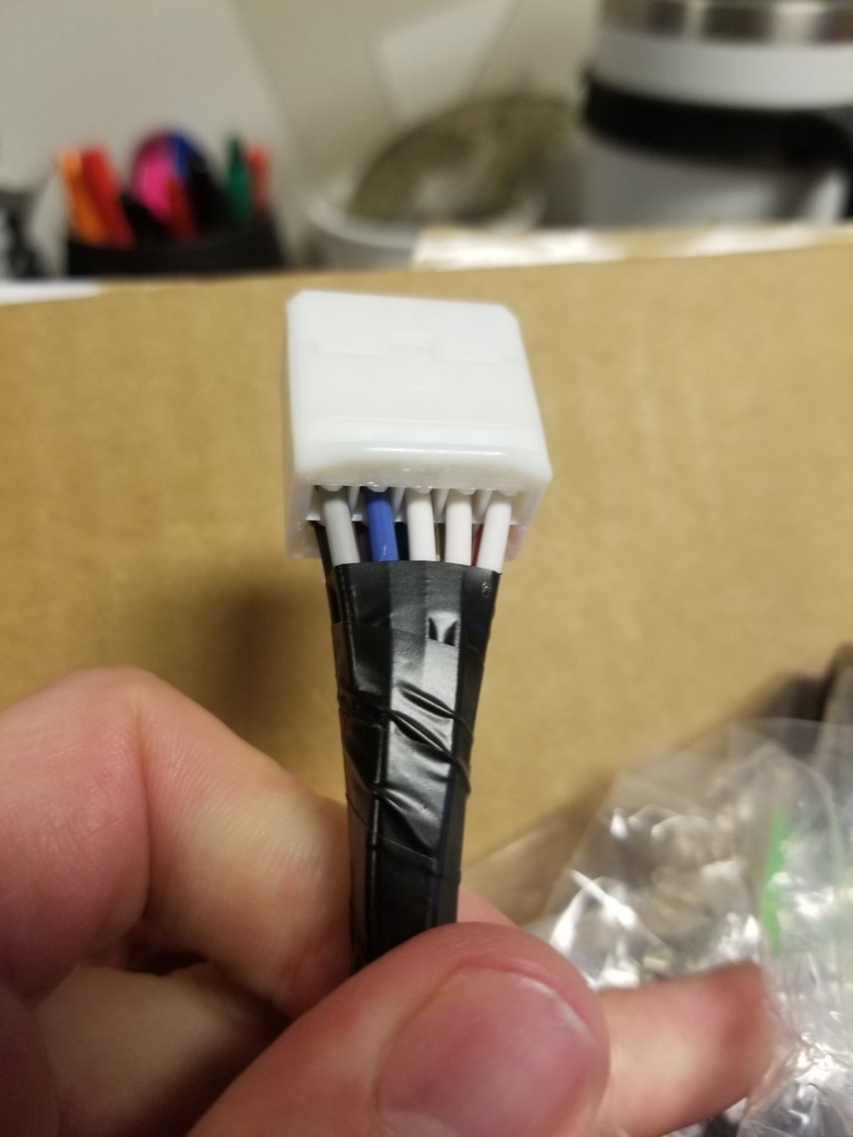

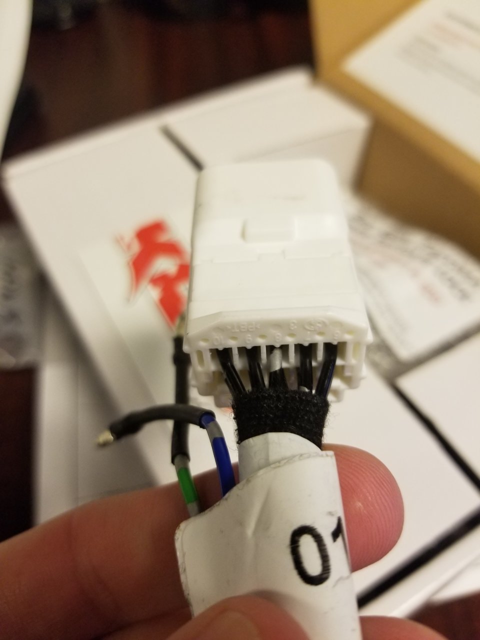

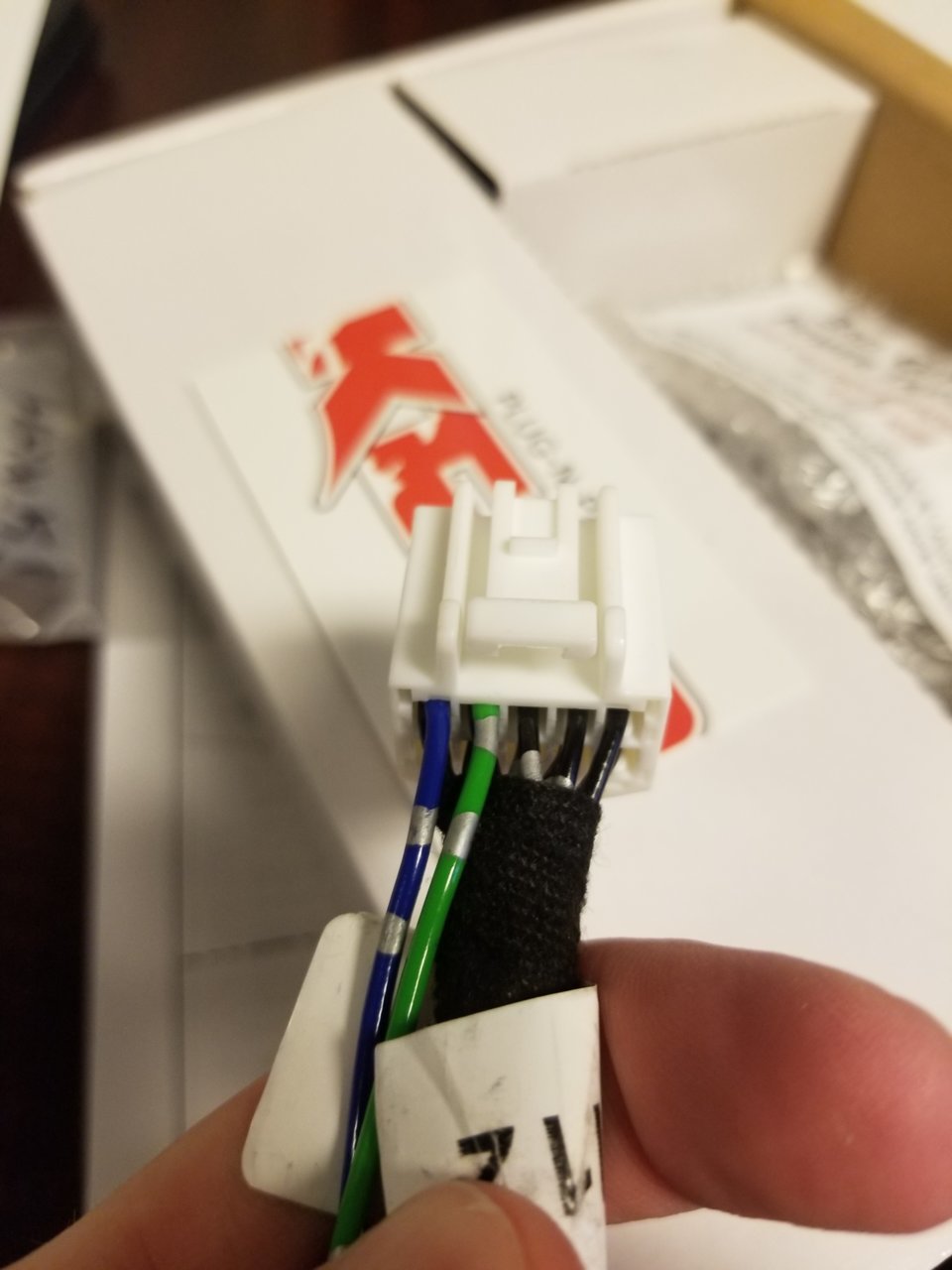

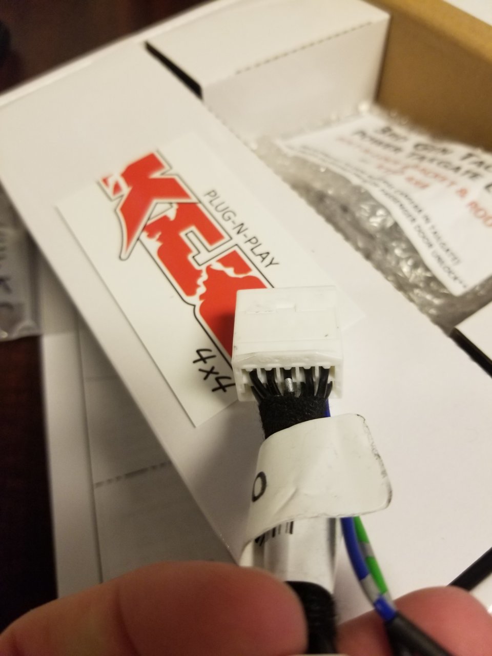

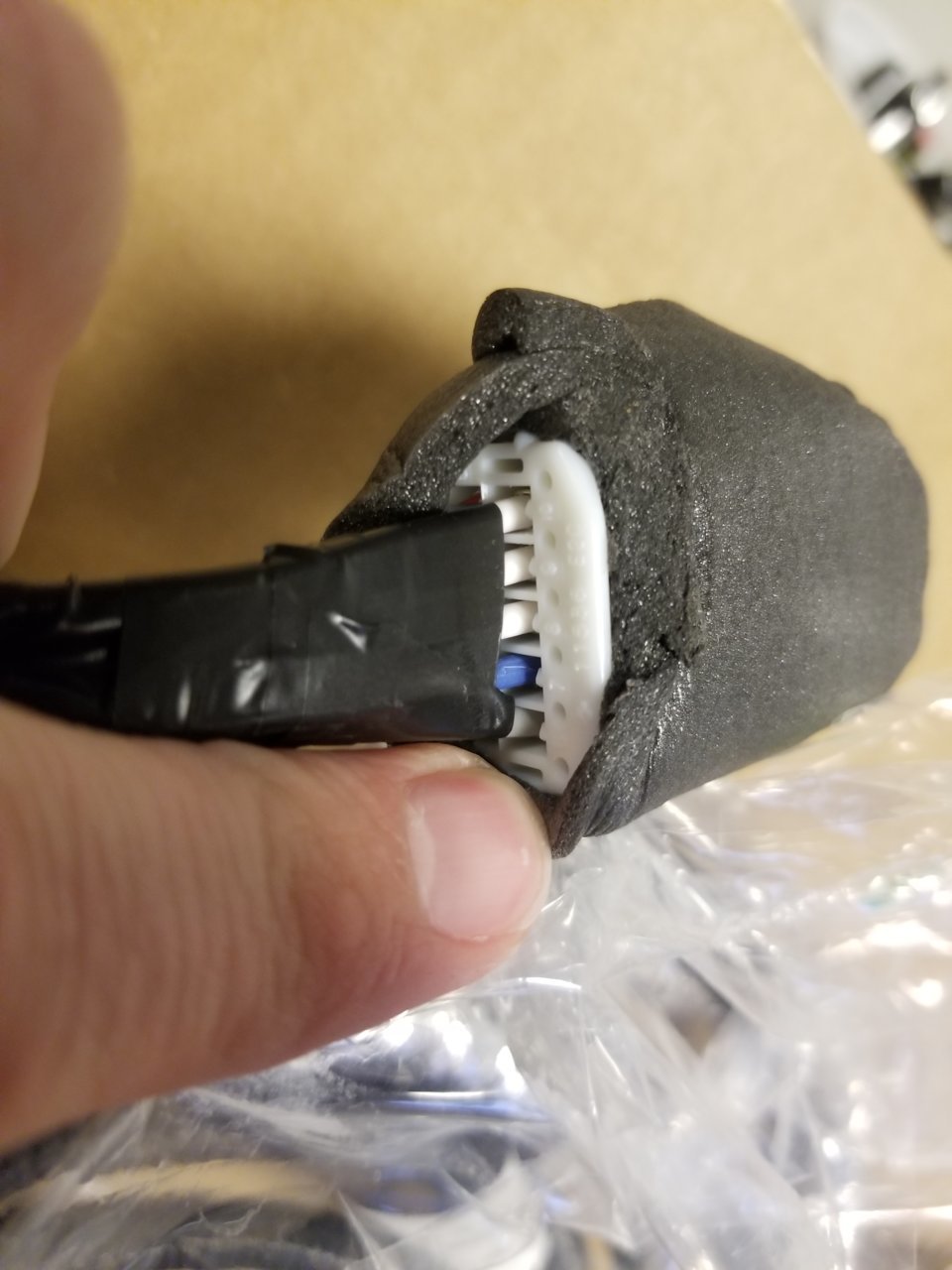

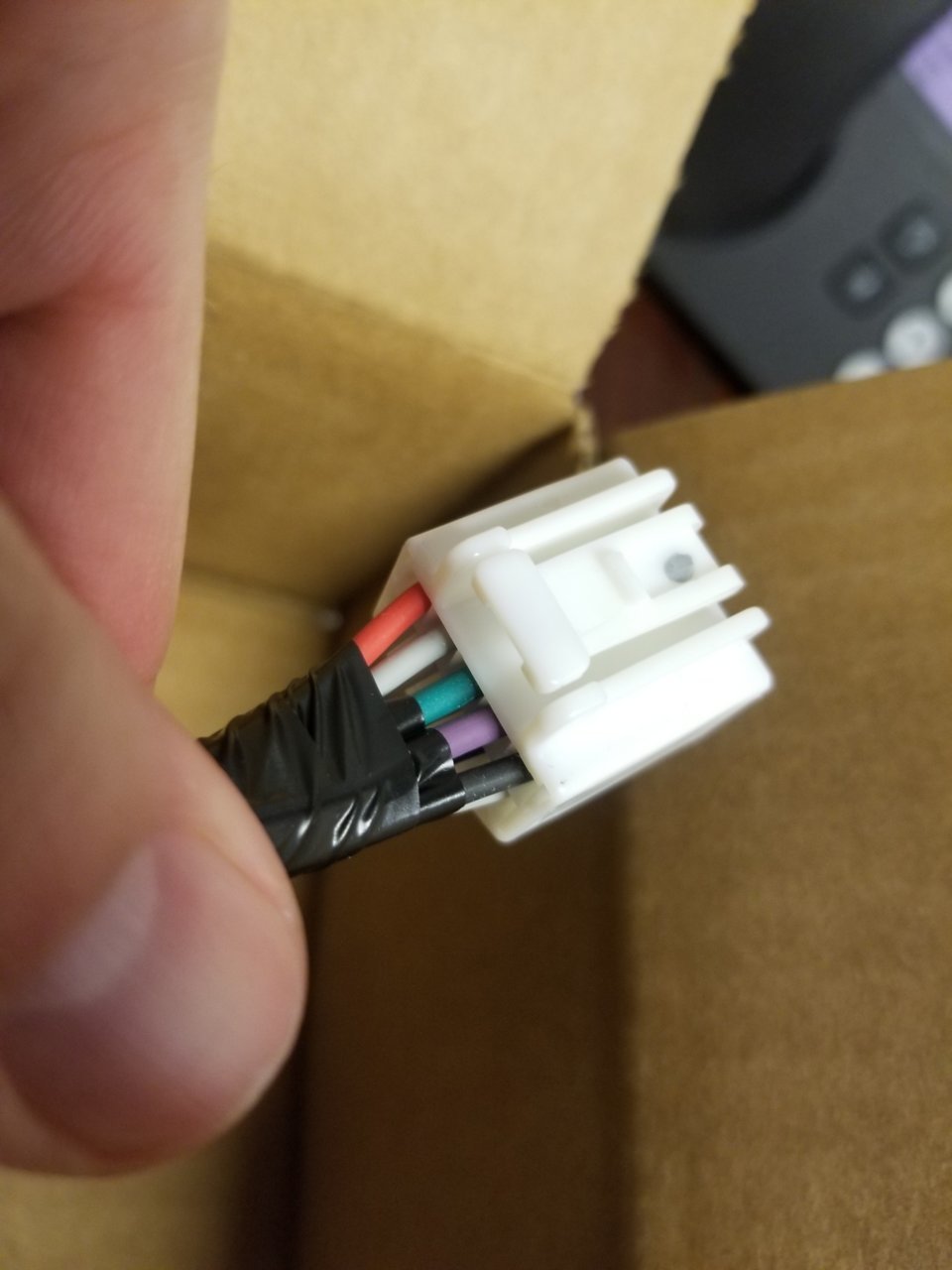

    Just received my OEM tailgate lock actuator kit. Below are photos of the OEM wiring connector (at the kick panel) and the @KTJO 4x4 wiring connector. Someone more savvy than me will need to say whether these are equivalent. Otherwise, I'm just going to plug the OEM kit in and see if my truck explodes. FYI, the OEM solenoid wiring is red and green.
    OEM male connector front and back
    OEM Female connector front and back
    KTJO 4x4 male connector front and back
    KTJO 4x4 female connector front and back
    bigmw likes this.

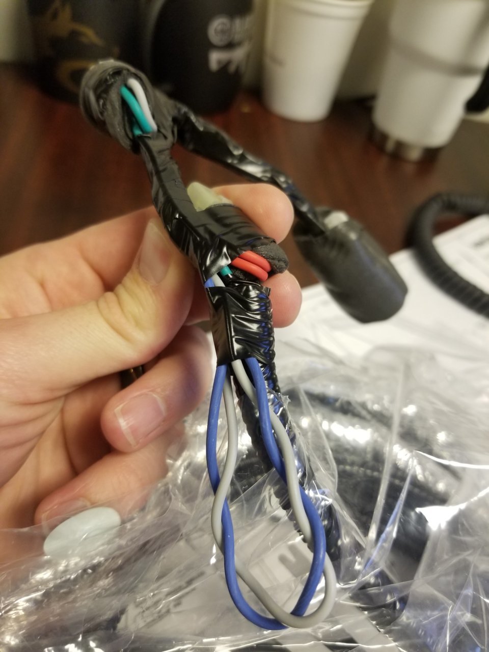

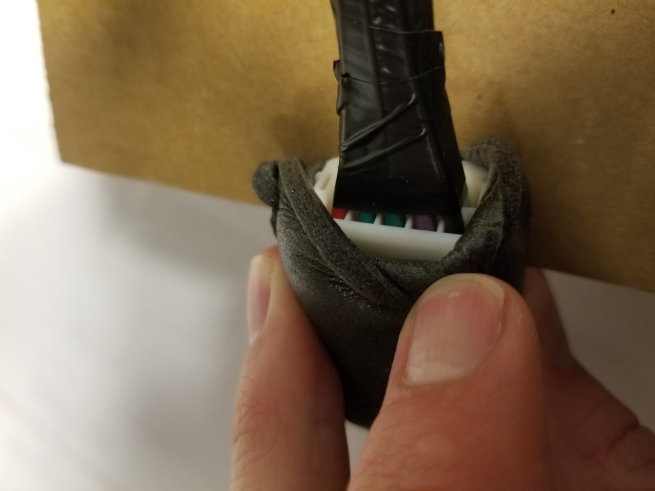

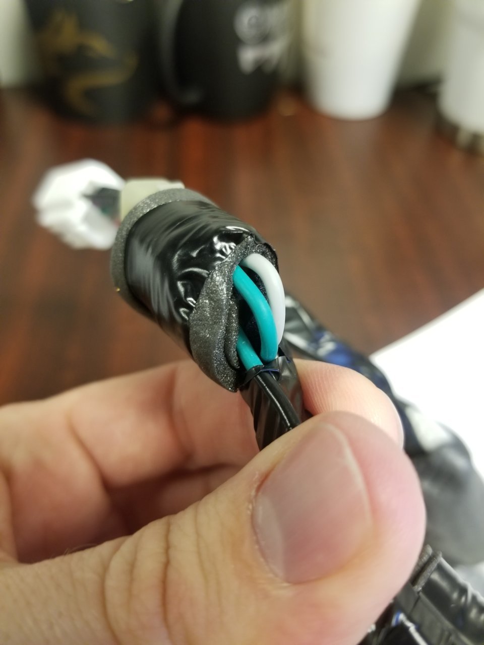

    Also, if I haven't provided enough info above, let me know and I'll take as many pictures as I need to.
    It appears that there's some wire color trickery that's taking place at the (2) inline fuses
    bigmw likes this.
