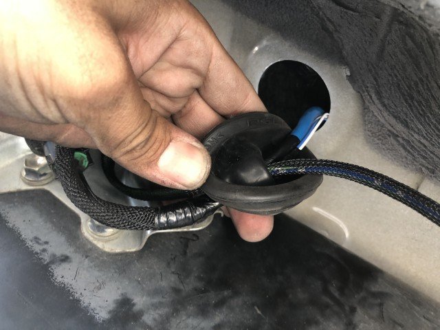

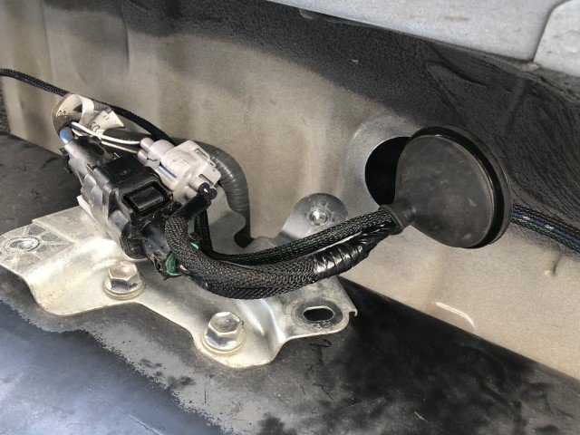

    Why don’t you just remove the grommet and install the harness inside the exist grommet like this
    Why do you need a brand new grommet? That’s nice they provide a new one, but it kind of seems like it’s unnecessary and money spent that doesn’t need to be spent.

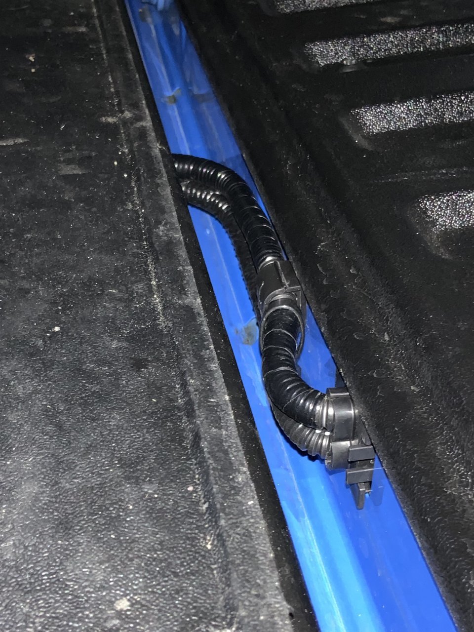

    The 2020 Tacoma doesn't have a harness going through the existing grommet under the passenger seat so you'd have to cut that and then re-seal it if you wanted to re-use it. In fact, that's exactly what the pre-2019 OEM "pop'n'lock" kit recommends doing in Toyota's install guide. The newer OEM kit is easier to deal with. That OEM kit includes the grommet already sealed onto the replacement wiring harness so all you have to do is run the harness through and pop in the new grommet.
    The kit also includes a replacement set of double-clips at the tailgate that seamlessly attach the new harness to the existing tailgate harness without having to cut open the existing harness and run wires through, etc. The OEM kit truly is a "plug-and-play" solution.
