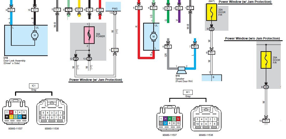

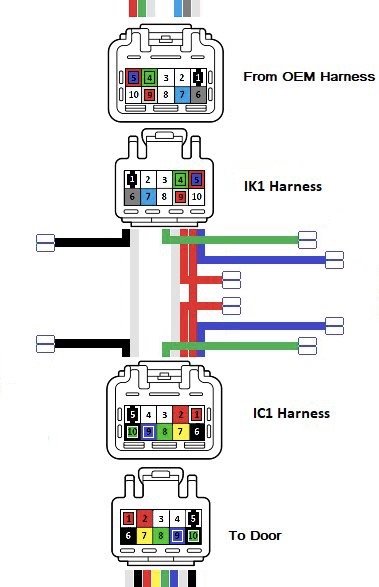

    Hi Katie,
    I used a voltmeter to check continuity of the (2) solenoid wires to the pins in the plug. The OEM kit and the @KTJO 4x4 kit both have the same pin arrangement. So the 2019+ OEM kit should work on all of the 2016+ Tacomas. I'm pretty sure this has already been confirmed, but I figured additional confirmation wouldn't hurt.

    KTJO 4x4
    KTJO 4x4 Well-Known Member
    Oct 10, 2016
    #199424
    3,884
    Katie
    Oregon
    2017 TRD OFF-ROAD 4x4 DCSB BARCELONA RED
    Nitro 4.88 Gears OVTune 1.05 91Oct DirtyDeeds Exhaust
    Yes. They all have the same Pin Arrangements except for this that have Window Jam Protection vs No Window Jam Protection. I posted that difference above in a previous post that you quoted. Pin 9 vs Pin 10

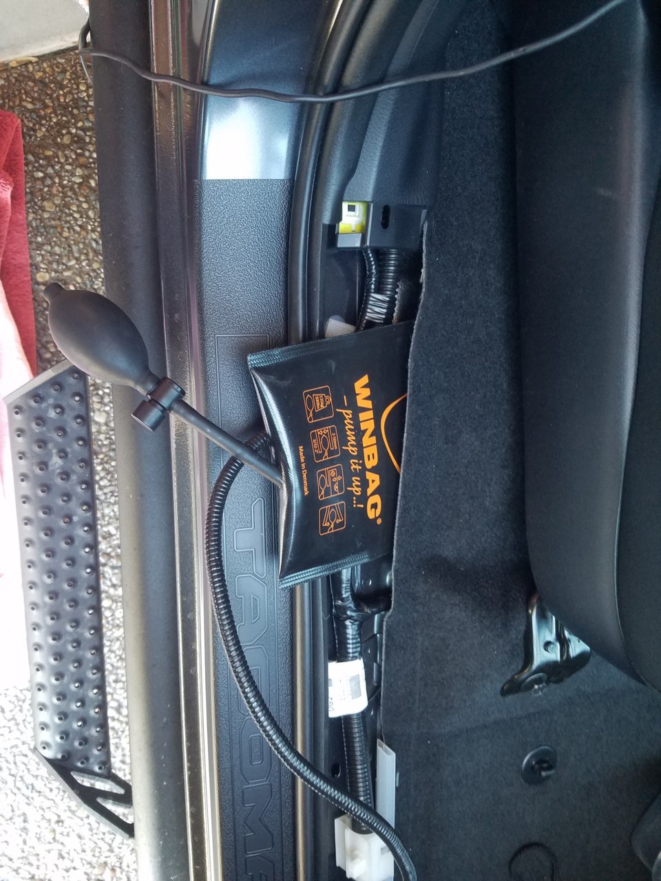

  15. Dec 22, 2020 at 5:04 PM
    #95
    Kennyk
    Kennyk Well-Known Member
    Dec 18, 2020
    #350023
    82
    2021 MGM Tacoma TRD Sport
    Just installed mine on a 2021 using these instructions. Only issue was lifting carpet under the seat to get to the rubber grommet. Until 20201222_140222.jpg I remembered my "winbag". Stuck it under the carpet and pumped it up. Best $10 I have ever spent.
