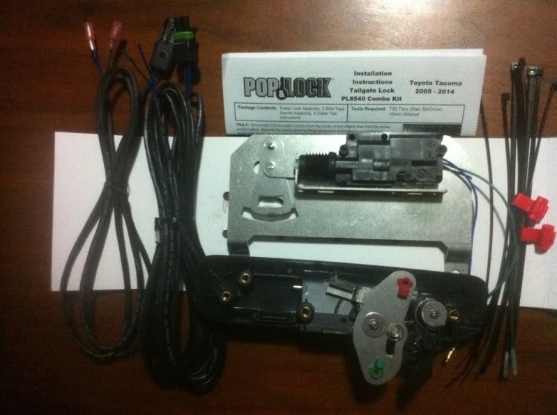

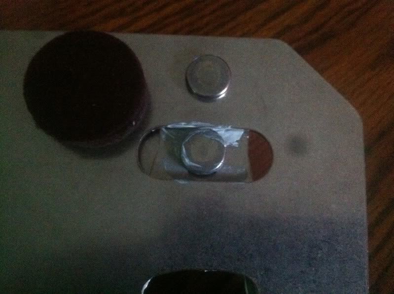

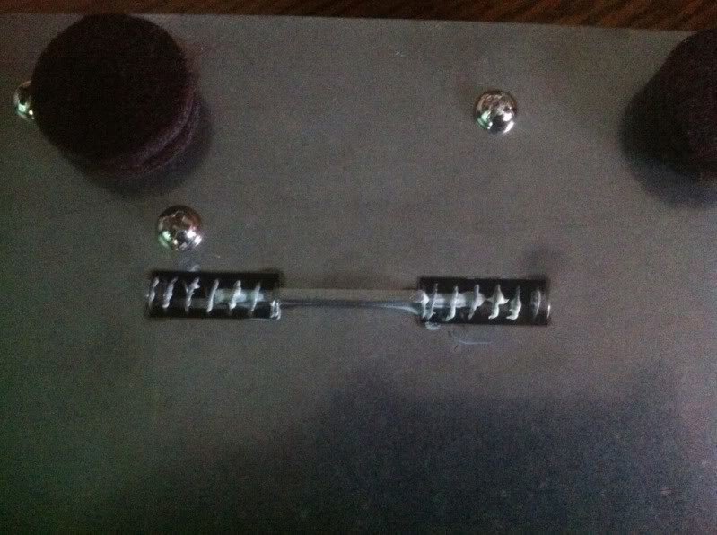

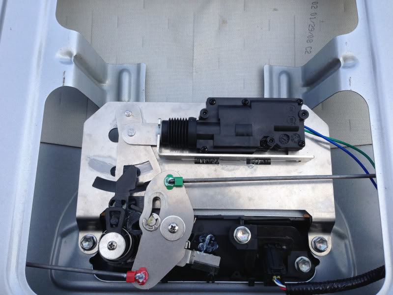

    So as promise I finally got to install the PL8540 combo kit. Took me about hour and a half. Took my time and made everything as if it were stock. Part that took the longest was routing wires from the tailgate, underneath the bed and through the cab. Everything else was pretty easy.
    Before installing the kit I prepped it by adding grease on all moving parts.

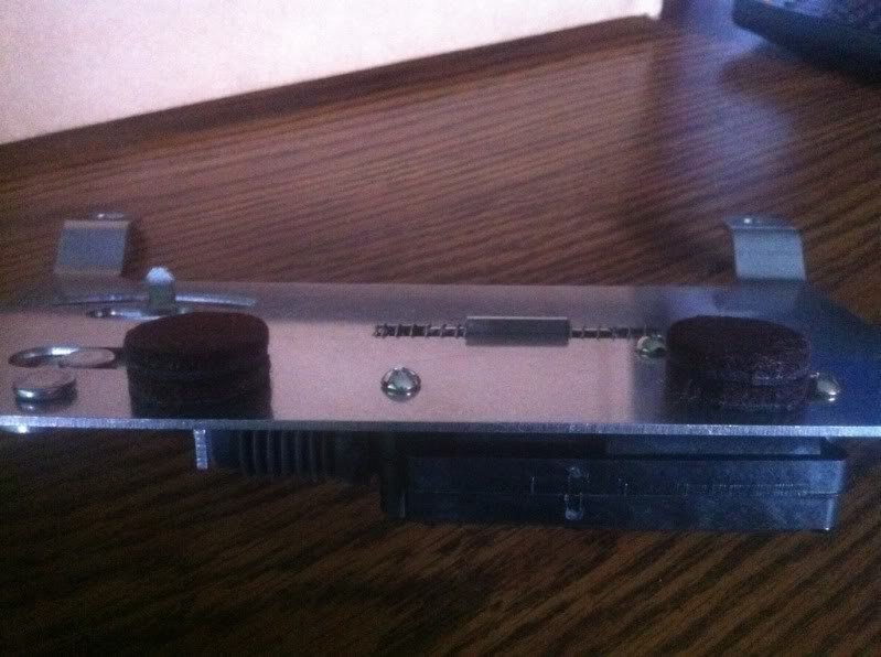

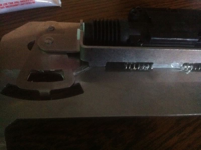

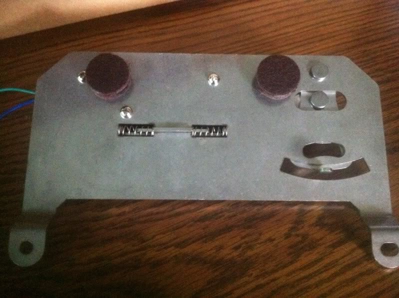

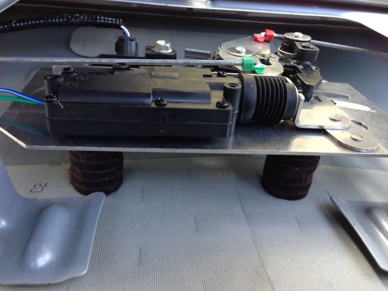

    Added this felt pad on the underside of the actuator plate. You'll see towards the end on why I added it. Got it from a local hardware store.
    E093D1D8-7AC4-45E7-8DA6-F8A7C26CD1E6-588_f7ad3c97cb272cac975c24113b30fbec0296e863.jpg
    603ABBD9-3B5E-4108-B661-A85F0D6B36D5-588_ba27657ae66831694ca43c937f64ae706eb9a647.jpg
    4682F7AF-38C1-4FA3-A2AB-FB3F20FF0A7E-588_6fb0b10718ecacf5cabd0079af0d396593584fa1.jpg
    I'm not gonna go into the step by step installation, because everything is pretty much on the installation instruction. Pretty explanatory.
    Here's the actuator and the handle installed.
    1fb549771d72710cc6a734329d37c025_zps64e6_1cae323a07c8c861b81a295bfe595f507d7c4315.jpg

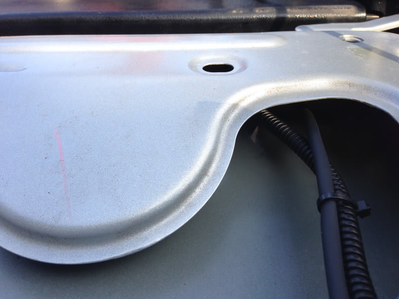

    The reason why added those felt pad is because of this. There's nothing supporting the plate besides those 2 bolts from the handle. It'll probably rattle or something and put pressure on those 2 bolts. That plate and the actuator actually has some weight to it. Used 6 pads on each side. Perfect enough.
    181187d301848c1bb6b288bbd64b7c66_zpsdd07_ddf309afc2d2978d37cee6128601e0267f0a06f8.jpg

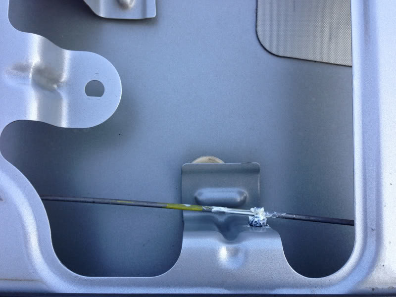

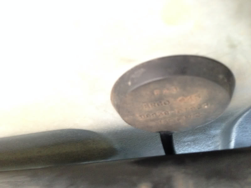

    One thing I did different than what the instruction didn't mention was re-use the clip that was use before flipping the latch rod. All I did was drill a hole and then reinsert the clip. Works as a guide for the rod. Also greased it up so it can move easily.
    The black clip was originally from that premade hole top left.

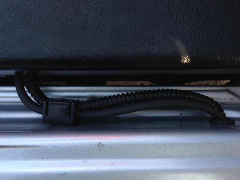

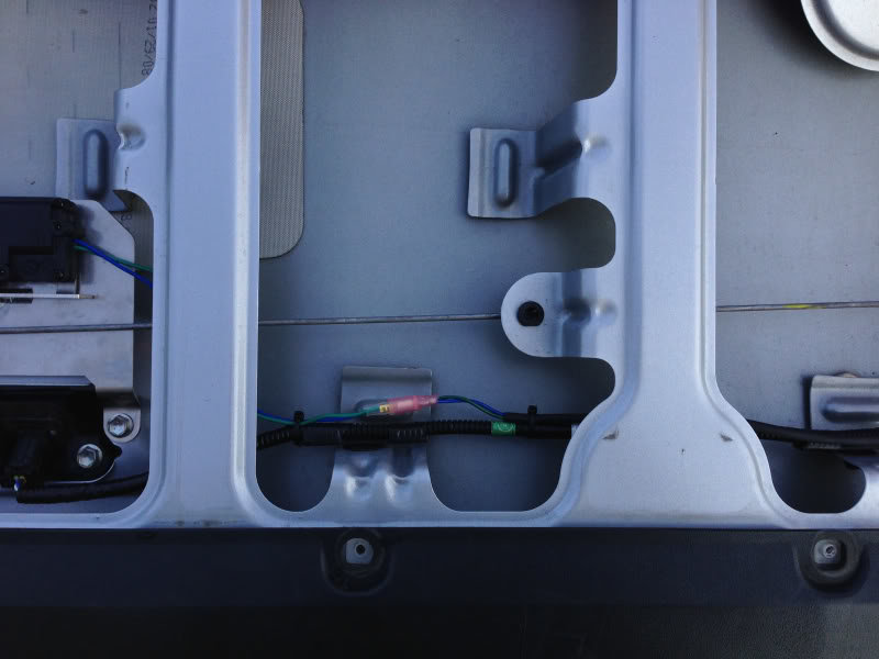

    Routing the wires. Pretty much followed the route with the tailgate camera loom. Installed the stock camera about a year ago.
    bbc3b82f40d165475db8f1b2dbd2addb_zps960f_d98a04aa3a0c29d5049b062584d795fc1355287b.jpg
    Going out the tailgate.
    861cb8e12092fb77515a16138585642e_zpsc112_4a89765ef6ed35cdc9ca5ea191650b6c000a8d08.jpg
    1b66765df9cdf519d1f6ba4d06bd531b_zps2751_f71aded327398e69ef6d4a662158c99ceca90d9c.jpg
    Coming in under the bed.
    4193c9f0d400a559a24dfb2a1f9c17a5_zpsba6b_b50f8186569025f7c02548c3c79fa82e3eec5777.jpg

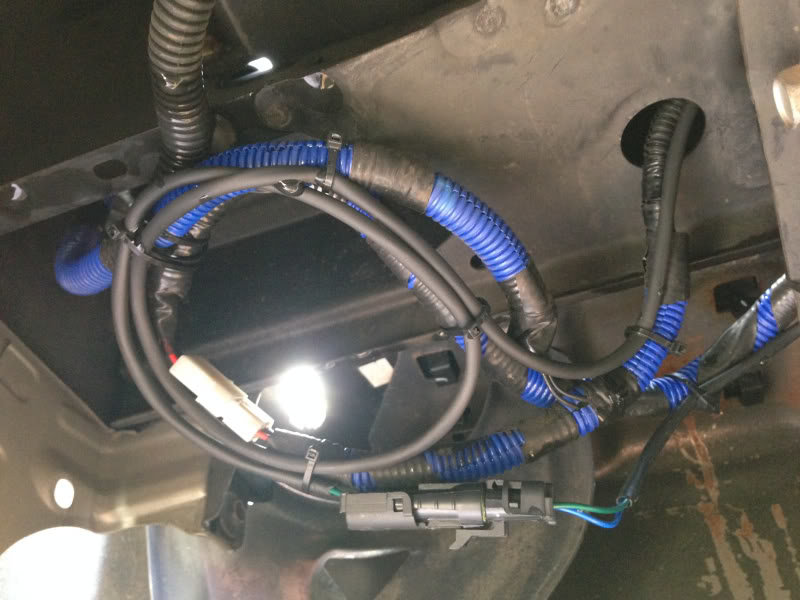

    Had a lot of slack so ended up just leaving it like this. Black plug is the pop and lock and that white plug is for the camera.
    fa7048bbacb6c73c3a1aad0aa0cfd22a_zps12e3_e0aba672fc9d5c82cbeab22412e5149f52bc4eb9.jpg

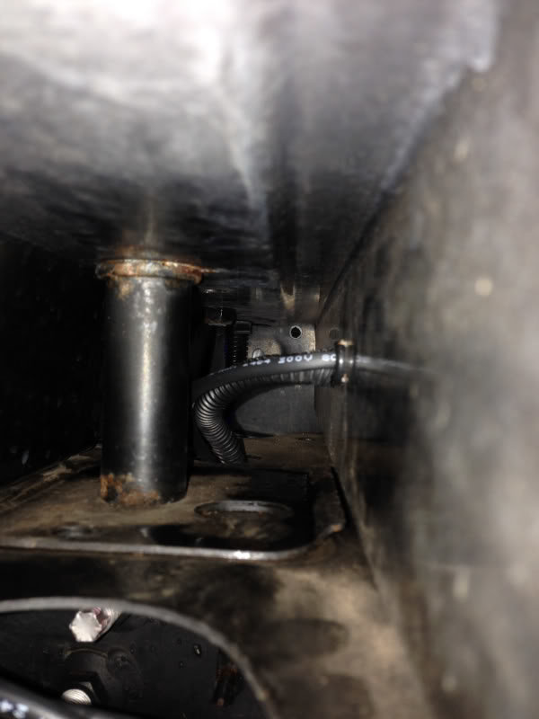

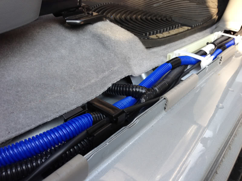

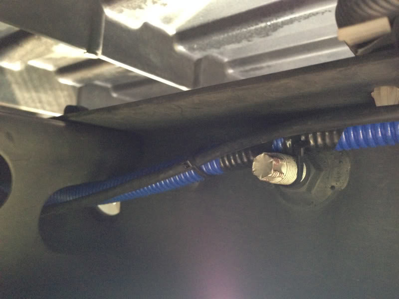

    Routed along side the frame.
    0b8b99e1066bffc1e6632d785bc6366e_zps999a_b46bde5827366502603f937b0759bfb14d1997e1.jpg
    c1aff8210e9841c9e00c3a6b1cb4ac9b_zps5e01_e98ac989dfb08b5277f366a16bb460d526775a85.jpg

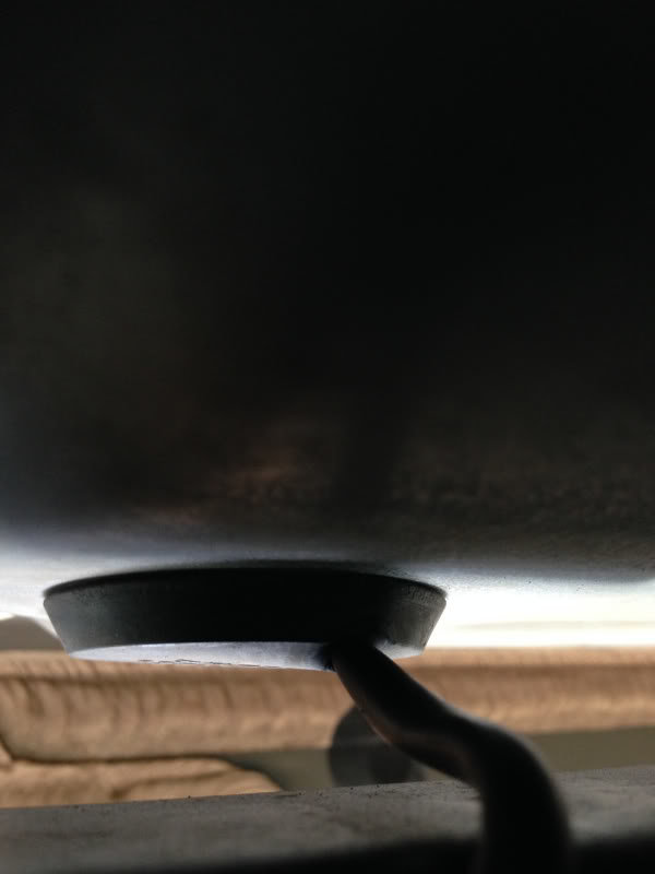

    Through a rubber grommet.

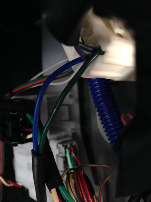

    I didn't like tha fact that I had to use taps to tap into the wires. So I ended up just unplugging the plug and taking the pins off and just combining the pin and wire together and just putting it back on the pin slot. Works fine for me.
