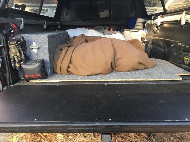

    I went to my local plastics place and bought a remnant that was slightly larger than the area on my tailgate that I wanted to cover. It’s like cutting board material. They cut it to size for me and I used a PVC deburring tool to round the edges. I drilled my holes into the tailgate cover (I left it in place), countersunk the plastic then used stainless steel screws to secure the piece to the tailgate. It works great for sitting on, prepping food and cooking, etc. and best of all it doesn’t hurt my older knees like the corrugated factory piece. Sorry, no pics as I’m out of the country.

    Picture a large cutting board sitting on the tailgate and that's what it looks like. LOL It's thick enough that it doesn't fex under my knees when crawling into it; it doesn't interfere with closing the tailgate or weigh much though. I actually used plastic primer and plastic paint to paint it black. So far it was holding up better than expected but if I redo it I'll probably just dye it black (I didn't think about dying it until after I'd already started painting- :homer: ).

    Not exactly the picture I was asking for but it's what she sent. LOL You can see what are it covers though. I was thinking I'd countersunk the screw holes but I guess I just used stainless trim washers since the material is thin; I didn't want to add much weight. Maybe that'll give you some ideas.

    Thanks for the photo. This looks like a great solution. Gives a nice even surface to work on and crawl over without banging up the knees.
