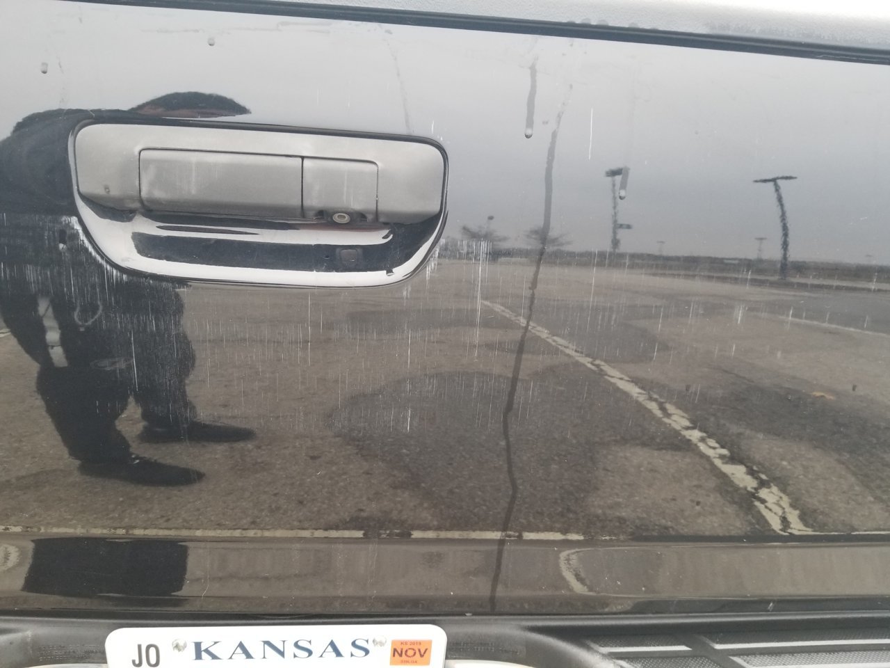

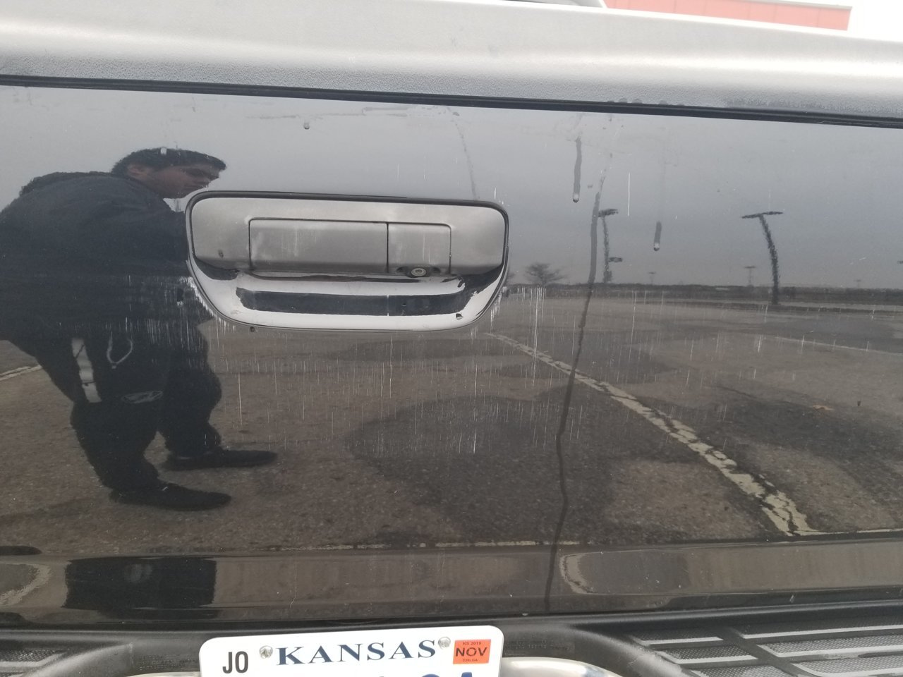

    So I got these starches when someone closed the garage on my truck. Should I try to repaint it myself or get it professionally done, how much do you think it will cost. Thanks20190214_162949.jpg

    Just had my tailgate repainted in oregon... cost me 275

    It doesn't look awful but pics can be deceiving. I would wet sand and then buff just to see if you can get it all out. If that doesn't work then I would just have someone else do it.

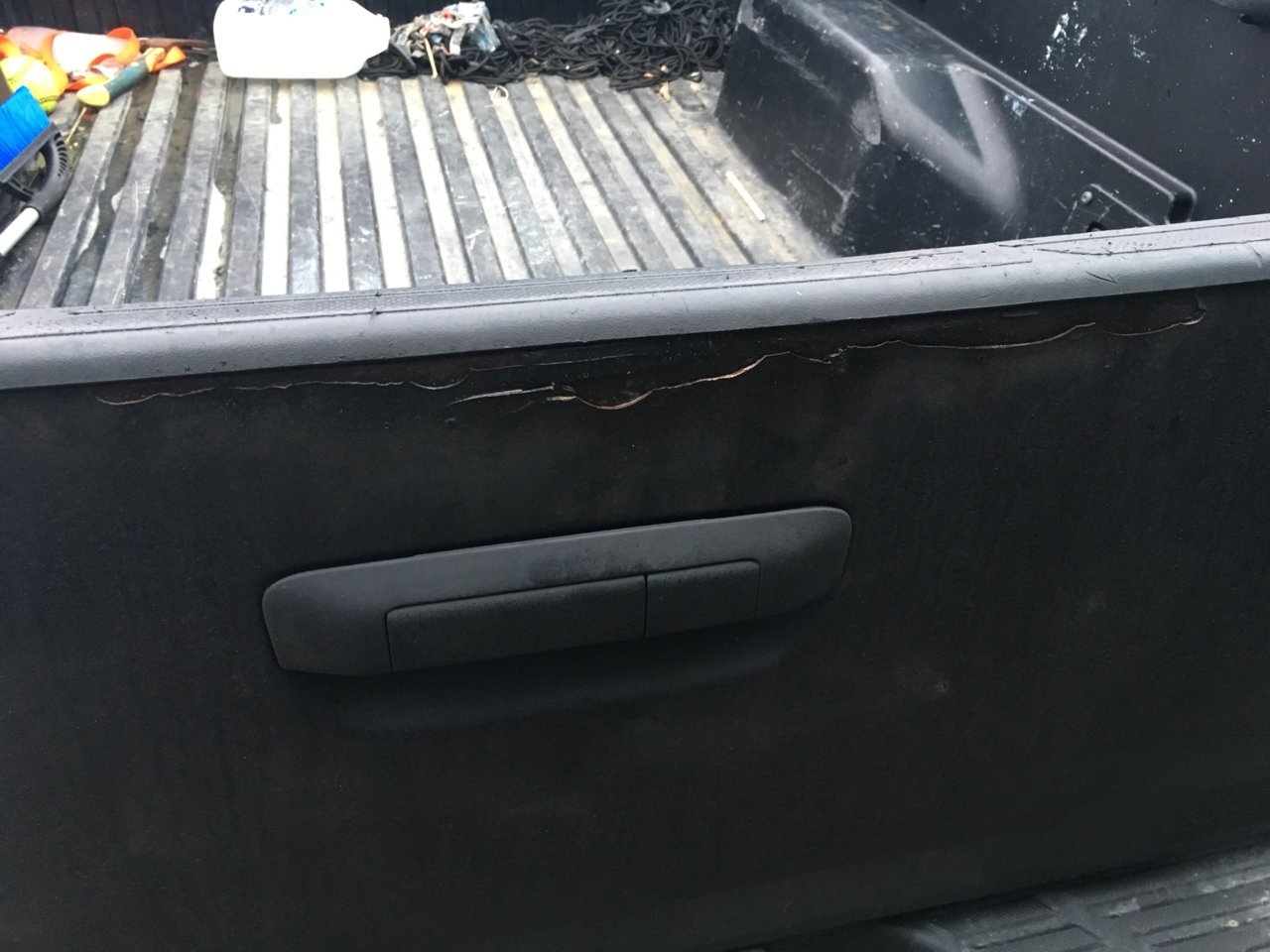

    You think thats bad? have a look at mine, it has the classic bend from too much weight, and a nice amount of paint cracked from said bending :D

    About 200-300
    Make sure it's a good well know spot.
    Colors fade after a while

    As someone who has done paint correction for 10+ years, you may be able to get a DA polisher, some Meguiars M105 and M205 and make that look about 80% better. Then use a small amount of touch up paint arround the corners.
    The harbor freight DA is pretty good for the money if you use a 20% off on it. Get the pads from autogeek. The velcro on the harbor freight pads aren't great.

    Have a pro do it. Equipment to do it yourself would be costly.
    My guess is $500 to repaint.
    If you can catch the scratches with your nail you can’t buff it out. But if you can’t you probably can buff it out. A local detailer can quote you. Its hard to tell just how bad it is.
