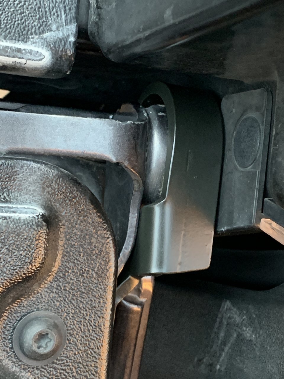

    Here one on my truck or you can go to the Anti theft device thread, there is a few there15612301028822817662978766895682.jpg

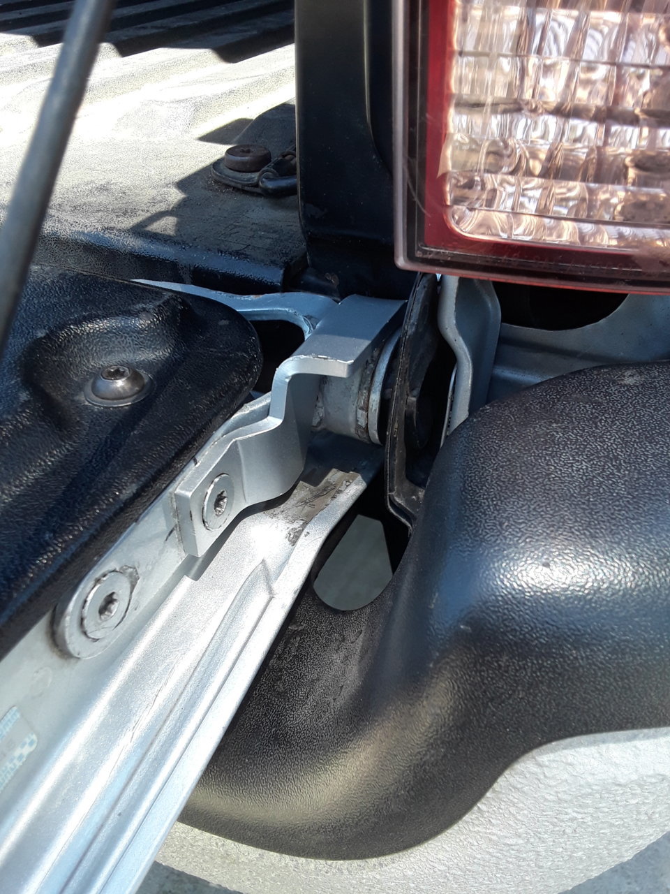

    It fits, however mine didn't fit tight enough. It could be moved up and down, so I JB'd the inside of it and the end of the locking screw. If somebody wants the gate bad enough, they could get it, but It's going to take them a while.

    Christian06 tailgate bracket is what I have on mine.

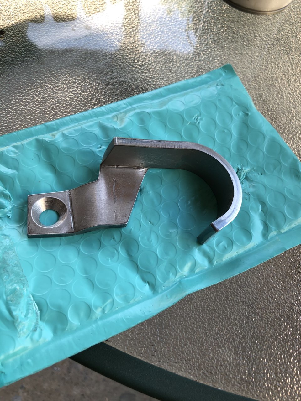

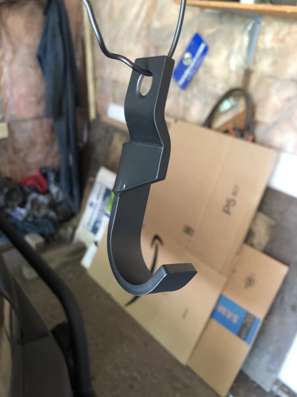

    @christian06
    Got my bracket today.
    It’s beefy for sure.
    Also very well done.
    C87A7266-A743-456A-89B4-4CCBFEF75F6D.jpg 4948BAE6-243A-467F-931E-7E79BC043568.jpg
    Sand and paint just have to install when dry.
    Thank you it was easy doing business with you:thumbsup:

    No prob, maybe we'll do it again sometime as I'm always making something or another.

    Had a hard time getting my ratchet and torx bit in there as the bumper caps was in the way. They’d need to have a allen style torx to get it out or rip the bumper caps.

    I was checking to see if I had the tools needed after letting chritian06 know I wanted one.
    Looked like I didn’t until I raised the gate upwards.
    The torx becomes more accessible or so it looks.

    I needed to raise the tail gate off the hinge to even get to the bolt. Tailgate has to be on the hinge to fit the device in. I was able to squeeze in a thin ratchet with the torx bit but had to align the torx bit with the bolt to even squeeze that in. I also used blue loctite followed by silicone sealant on the bolt head to hide the torx slot.

    It just takes some jimmying to get it all in place. I picked my tailgate up, kinda loose fit it on, than put the entire assembly in and tightened it down.

    Yes its alittle tight but I personally test fit each and every one before it goes out the door, I just want a good product with no returns. Thx to all for your support.
