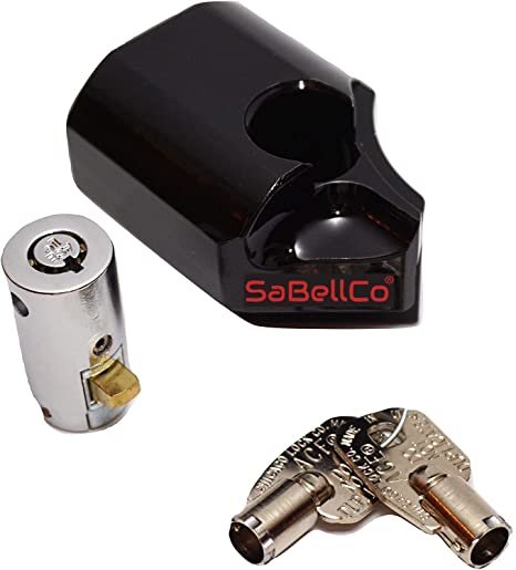

    Has anyone tried this one? (for 3rd Gen)
    SaBellCo 2016-2022 US Made Tailgate Lock v2.1 - Anti-Theft Lock - Black - for Toyota Tacoma

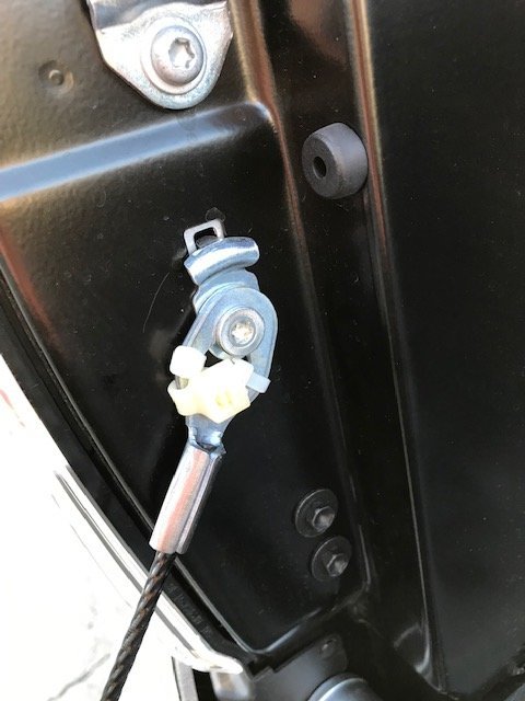

    This thread is recent and has links to the most popular tailgate theft-prevention products and tips on the diy deterrents. I use a hose clamp that requires a key and washers on the tailgate cables so they also cannot simply be lifted off.
    Nothing is going to stop someone who is determined to steal your tailgate, but the diy methods are simple, cheap and add extra steps to the process of tailgate removal. Anything to make your truck a more difficult target will prevent opportunistic thieves
