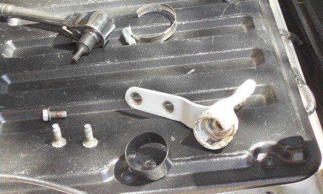

    Use a piece of steel exhaust tubing to sleeve over the hinge. Cut from an exhaust tubing adapter bought at the auto parts store for less than $3.00 - takes a hacksaw and tools - very little else.
    Mine has been on there for over 7 years - has marks where some dumba$$ thought they could beat it like they do a hose clamp. Fill the screw heads with JB weld so they can't disassemble it like you did.......
