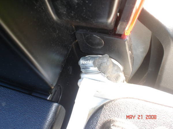

    Spend 39 cents to protect yourself. Our tailgates literally lift off. I used a hose clamp to make sure nobody could take my tailgate without a screw driver. It might not be very secure but it would triple the time needed to get my tailgate and the effort alone will deter most thiefs. And its actually quite common for tailgates to get stolen off our trucks.
    Look where the tailgate meets the body.

    yeah im gona do the hose clamp here in the near future i also picked up a pop and lock for $20 to be more secure

    I had a tailgate stolen from my old S-10. It sucked, luckly I found one in a junk yard with the same color. After that I used a hose clamp and secured it with .040 lock wire and put JB Weld over the worm drive of the clamp. Did the same on my Tacoma 1st day I had it home. Along with a cable lock for the spare and a rod in the track of the rear sliding window.
