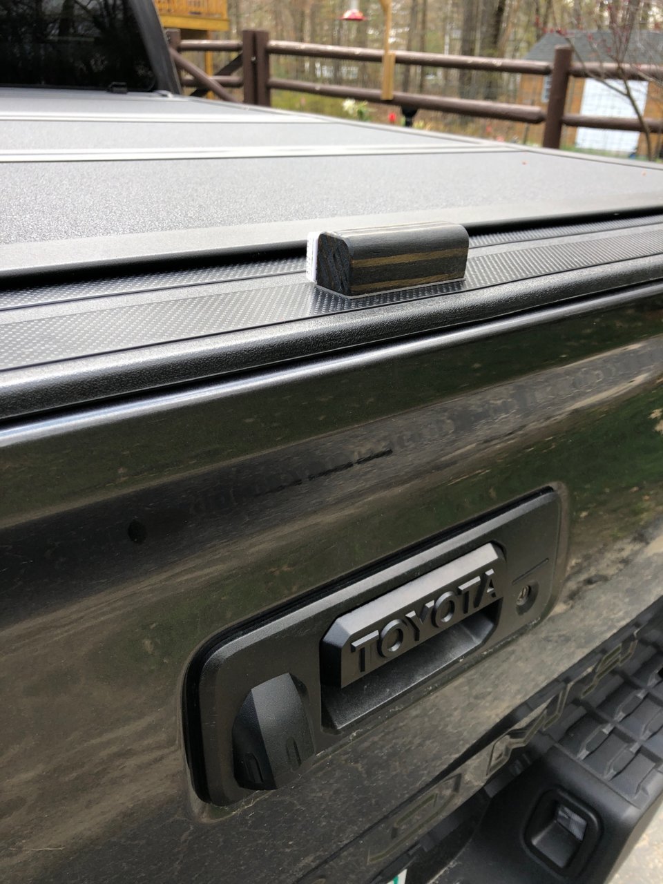

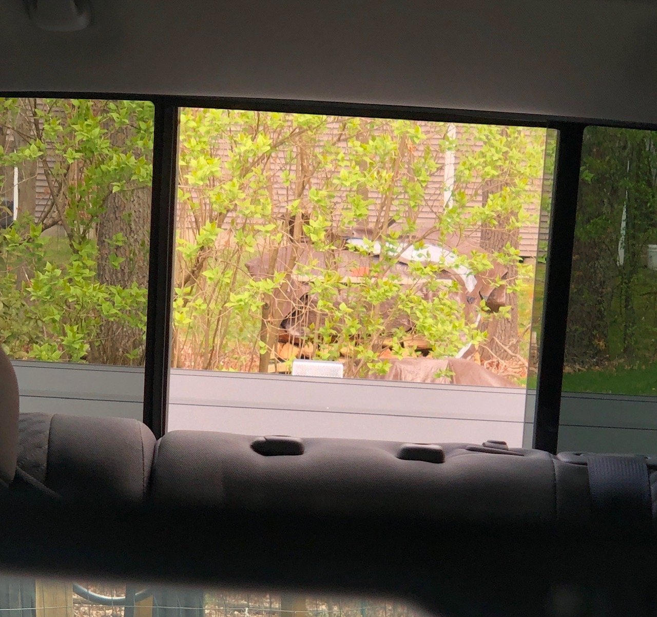

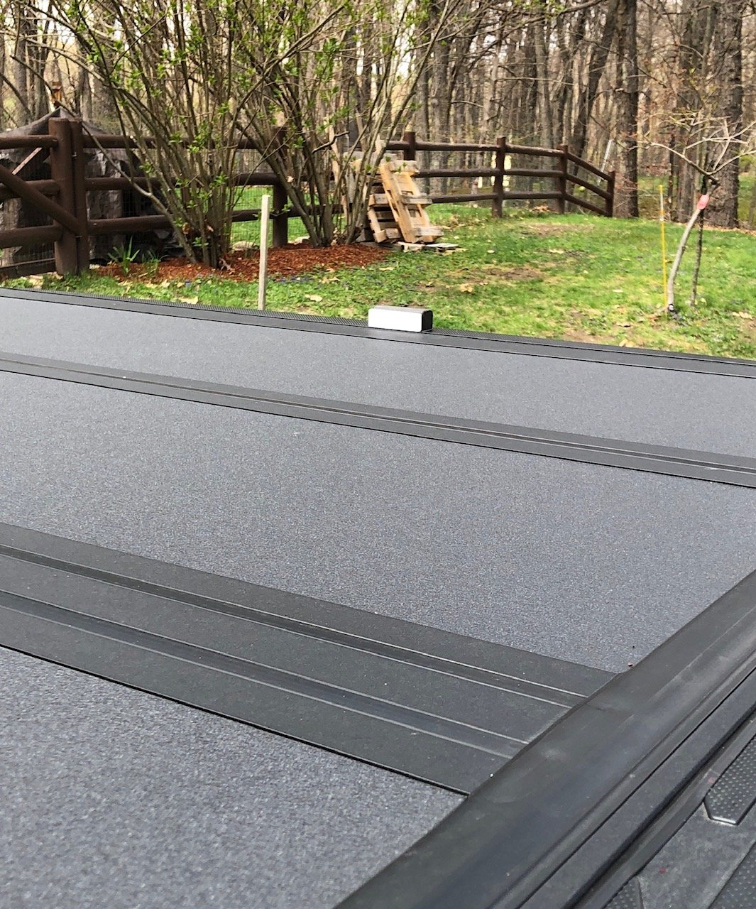

    Well this is my version of a tailgate up indicator, no wires, switches, l.e.d., just simple stupid. upload_2023-4-26_16-35-53.jpgupload_2023-4-26_16-35-53.jpgupload_2023-4-26_16-35-53.jpgupload_2023-4-26_16-35-53.jpgwell this is what I came up with after several attempts on paper. The body of the indicator is pressure treated decking scrap. It measures 3”x 1” x 1” sanded and stained black, then sealed with linseed oil. The reflector is from Amazon, two in a pack for $6.95, they measure 3” x 7/8” x 1/8”. It has a adhesive back, I used Gorilla heavy duty double sided tape to stick it to the tailgate. So that’s it, less than $15.00. Mounted dead center on the tailgate. The cover is a BakFlip, really low profile which helps.

    If you don’t put it in reverse you’ll never know, I guess everyone is a critic, if you have a bed cover your in the blind. So keep it simple, stupid. KISS

    looks good to me. i question if my tailgate is up or down by the time im on the interstate. id prefer to not throw it in r at 65 mph either.

    I think it's clever. I've driven off accidentally with my tailgate down in my lifetime on older trucks that didn't have reverse cameras. Even with the Tacoma it could happen since 99% of the time I back into my space so it wouldn't be in reverse until I got to my destination.

    That's very clever Tac2021, thanks for the tip. I think I'm going to do this to my truck, too. This is more convenient than stopping and putting the trans into reverse, which I have done a few times to check my tailgate.

    Is that Pressure treated?
