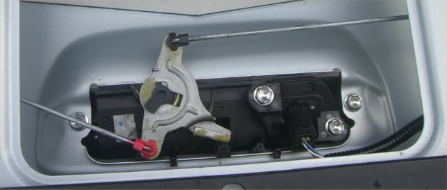

    Did you grease the latch or the handle mechanism? The handle mechanism is underlubricated from the Pop N Lock factory and needs a few squirts of white lithium grease (applied from inside the tailgate) to operate smoothly.
    Did you install the Pop N Lock yourself? Did you follow the guide here? http://www.tacomaworld.com/forum/2n...-pl5300-2009-tacoma-cam-install-tutorial.html
    Are the red and black plastic rod bushings in good shape?

    I installed it myself... but I followed the instruction and the youtube video by PNL.:(

    the whole tailgate system is under-lubricated from the factory. open the tailgate up, and lubricate the latch, and where all the rods go and what they hinge on, the little plastic guides, latches ect... use lots of grease. i had to fix my 2012 myself about 6 months into ownership and its hasnt given me a problem since.
