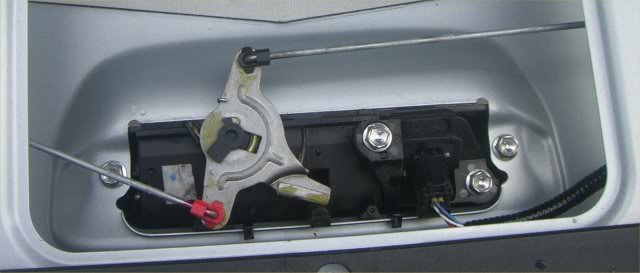

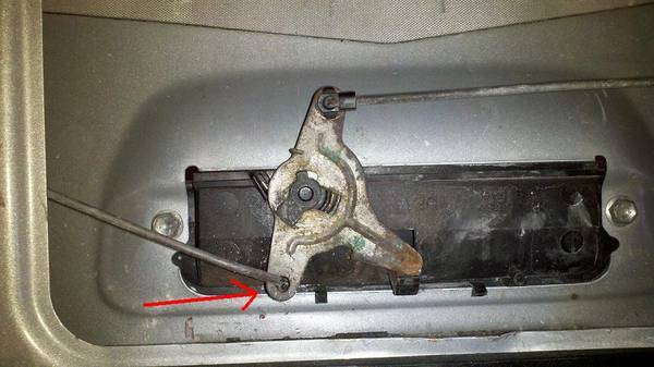

    Thank you for the help. I found that that the problem is a homemade "fix". I lubed the problematic latch, and found it was working properly. I followed the heavy gauge wire and found that it's too loose so that when the handle is released it doesn't close the latch. I got it working for now, but it looks like I'll be replacing the handle itself soon.
    This is how the inside of the handle should look:
    Unfortunately, this is how it does look:

    Ahhhhh yes. You are missing that lil', red, doofremus-hemus that holds the rod end. Perhaps someone else was in there first and damaged the link or just lost it out of carelessness. Hope the new mechanism isn't very pricey.
