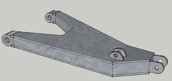

    so as some of you know i like to build my own stuff for my truck and a couple days ago i got the idea that i could make my own lt kit so this is what i have gotten designed up. [​IMG]
    tell me what you think

    looks good... im guessing you have the proper tools and everything to do it with? If so go for it and post how it turned out

    yeah im slowly aquiring those tools i want to get the design just right before i start making it

    best of luck. the design looks good!

    It "looks" beefy, but your gonna need an "X" structure inside (inbetween the plates) to eliminate flex/twisting forces. Also, maybe eliminate the bend what the lower shock mount is. Make the unit straight. Just my $0.02. :)

    What are your choice materials?

    thanks chris and i plane on using 1/4 steel plate would anyone know if the 4wd and 2wd spindles are the same or are they different on this truck

    Interesting. I agree with Chris on the lower shock mount.
    If you have access to a water jet, it would make for some very clean and precise cuts, you wouldn't have to worry quite so much about both sides being symmetrical. You could also churn 'em out if you ended up mass producing the LCAs. Good luck with the project!

    4x4 spindles are the same as the Prerunner, but the 4x2 (5 lugger) is different.
    1/4" plate is pretty heavy, have you thought about useing some good Chro/mo tube, and making a "trellis" type design?

    i dont know how to weld chromoly ive read that you need to heat treat it and such and what do you mean by trellis

    Triangles. A triangle design is VERY strong. For example.....Make a "V" design from the frame mount to the spindle, and put an "X" in the center of the "V". It would be bullit proof.

    How about Tube arms and plates around it. I'm In the same boat as you. I have access to a Plasma Arc CNC, Tig and Mig welder.

    i personally like the boxed look but it still in development stage

    The design you have is solid, but your gonna need some internal braceing...."X". And make it go straight to the spindle with no bend. ;)
