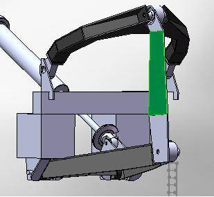

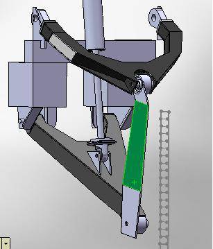

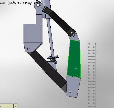

    In that model I've got the hiems all the way in to uca I'm going to slide them out a bit then ill tweak the spindle for final corretions on the bump and droop then ill start doing the bump steer ill have to have full hiemed steering with that travel. Do you have yourr truck caged I'm going to have it fully caged and would eventually like to run bitd every once in awhile

    I was wantin to run bypasses and coils but I don't know if imm going to be able to fit the two in there I might be stuck just playing with the spring rates for awhile

    That looks pretty good, but it doesnt look like you have much caster built into the UCA's....

    I've still got alittle bit of work to do on the spindle still with the uca back completely againt the hiems I can't adjust any of that so once I get them spaced in the program ill be able to fine tune that's just to get me in the ball park

    i think i misunderstood you chris i thought you were talking camber. the upper and lower uniballs will be directly above each other and from what ive read that should be neutral castor. alot of guys say 6 deg of caster is good. but ive seen alot of rigs that are neutral caster as well so ill play with what i got and see what comes out of it

    Neutral caster could probably be good for a car but for anything off-road I'd add some caster.

    ill add a couple degrees of caster by sliding the upper back towards the cab since its all going to be hiemed and uniballed it shouldn't bind at all

    Are you going to put some tilt on the the upper for anti-dive? It helps keep the front end up when your on the brakes

    i havent decided yet the way the frame is it wouldnt be hard to put it slightly tilted

    Actually, Most cars have much more caster than trucks.

    ive done alittle bit more of research on the anti dive. ive found the racing comunity to be somewhat devided about anti dive. some say use springs and compression from the shocks to counter anti dive some say build it in im still undecided about this
