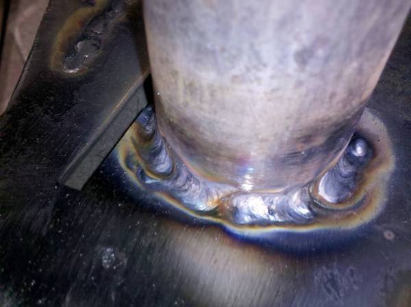

    put the main hoop in and seatbelt bar havent welded them in yet but waiting for a buddy to help hold in in place.
    also did some tig welding still not great but i dont think its that bad

    If you tigged that, it looks filthy.
    Next time, after you grind the metal clean at the joints, wipe it down with acetone right before you weld it.
    Let acetone evaporate first. Then weld it.

    yeah that was a practice piece of metal its not the cage i was just foolin around to see if i could do it

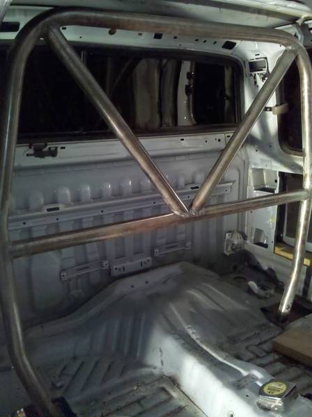

    got some more work done check it out
    heres the full main hoop with the x bracing
    had to take out the side windows out for better welding access
    and finally removed the front windshield
  13. Dec 24, 2011 at 8:37 PM

    it has been a good christmas this year. i got more work done on the cage heres some picts
    the passenger a pillar from the front
    the same a pillar looking across the cab
    and where the a pillar goes through the floor to the top of the frame
    heres both pillars from the front
    both pillars through the cab
    from the other side
    i might catch some flak for how close the cage comes back to the pedal area
    but i think i fight just fine in it
