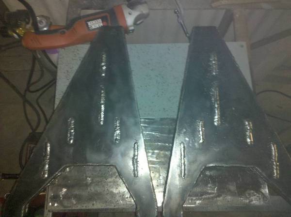

    sweet i think it should be wide enough for the coil and bypass

    what i got done tonight one complete arm

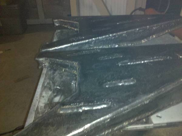

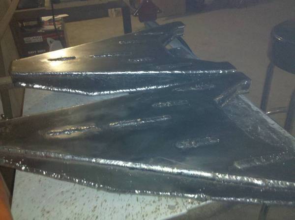

    thanks chris i need to find a way to clean up the metal alittle more but i think it will work great.

    looks good what weld process did you use

    A wire wheel on the end of a drill should work well.

    or a grinder with a grinding wheel knock down the starts and stops and get rid of all the splatter balls dress it up nice. i tell all my guys that weld for me to take pride in their work and make the next weld look better than the last. but thats my opinion . other than that looks good keep up the good work.
    sorry if it sounds like if im nit pickin . its what i do at work weld supervisor and ndt tech

    to both of you i appreciate the suggestions that was at 1030 last night though and i was ready to pass out im going back over it to clean it up today

    i used a lincoln 140c. using 75argon 25 co2 and .030 wire. welded only an inch at a time then welded somewhere else it was painstakingly slow

    I use a Soft grinding disc to clean the metal before I weld. Or lightly grind it with a hard disc.

    how much longer is that a side from stock? 4.5"?

    about 4 i still have to cut out a semi circle at the end for the uniball. but i dont have the bushings on yet either
