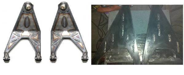

    heres mine compared to camburg

    what do you guys think for shocks... fox 2.5 res 10 or king 2.5 res 10

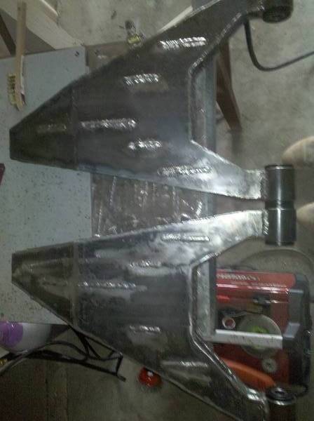

    got one set of bushings on. stoping for food. will post picts soon

    ok here they are with the bushings

    i vote kings heard nothing but good things

    i know kings are awesome but what i dont get... is that they have race shocks and prerunner shocks... and so far no one can tell me the difference
  12. Jan 18, 2010 at 7:34 PM
    #112
    mikesdoublecab
    mikesdoublecab LT Chase Truck
    Jun 15, 2008
    #7334
    7,246
    Mohawk Mike
    Glendale, CA
    01 Tacoma DoubleCab V6 Prerunner
    Engage Offroad long travel front and rear with some fat tires.
    race shocks, 3 inch shock body... better performance in high stress and heat... typically for full blown race trucks and folks with daily rigs who want the bling factor and have more money than modesty...
    prerunner shocks, 2 and 2.5 inch shock body... typically for most long travel trucks and prerunners...
