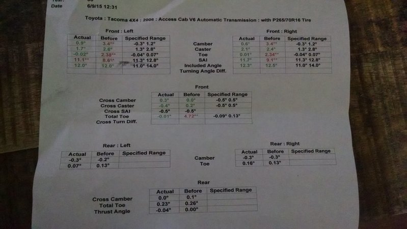

    Hey guys, I just got it back from the shop. It rides great... at low speeds. When I jump on the highway it dives whichever way the road is leaning towards. Kinda makes for a frustrating ride. Can you guys take a look at the alignment specs and point out any possible causes? I'm thinking the caster could be higher, but since it's only a 2" lift I wasn't sure. And what's up with the SAI being different from one side to the other, and out of spec... is that OK?

    Caster is still within spec but low for a lifted truck. It would have been better if they left it alone. I'm sure they can get that back to the 2.5 range with stock uca's. I know when I did mine, whenever caster is adjusted, it affected camber.

    Oh I installed LR UCAs. They should have plenty of adjustment room.

    With LR UCA's, they can get that caster to 3 and camber to 0. Some shops don't know how to adjust the LR uca's so I adjusted mine myself on the alignment rack.

    They're set at +2 right now. I don't think the shop will mess with anything but the stock adjusters. Should I set them to +3 and bring them in like that?
    Also, I'm getting rubbing in the back of the wheel well. I've never had that before with the spacer lift. It seems like the tires are set further back, is that typical of the SPCs?

    You're getting rubbing on the back due to low caster. With the LR UCA's set to +2, they should be able to get your 2.5+ on caster adjustment. With stock UCA's I still had casters at 2.1 with zero camber on a 1.75" 5100 setting. When I switched to 885's and LR's, I was at the +2 (standard setting) and had 2.7 caster setting. Camber and toe was at zero.
