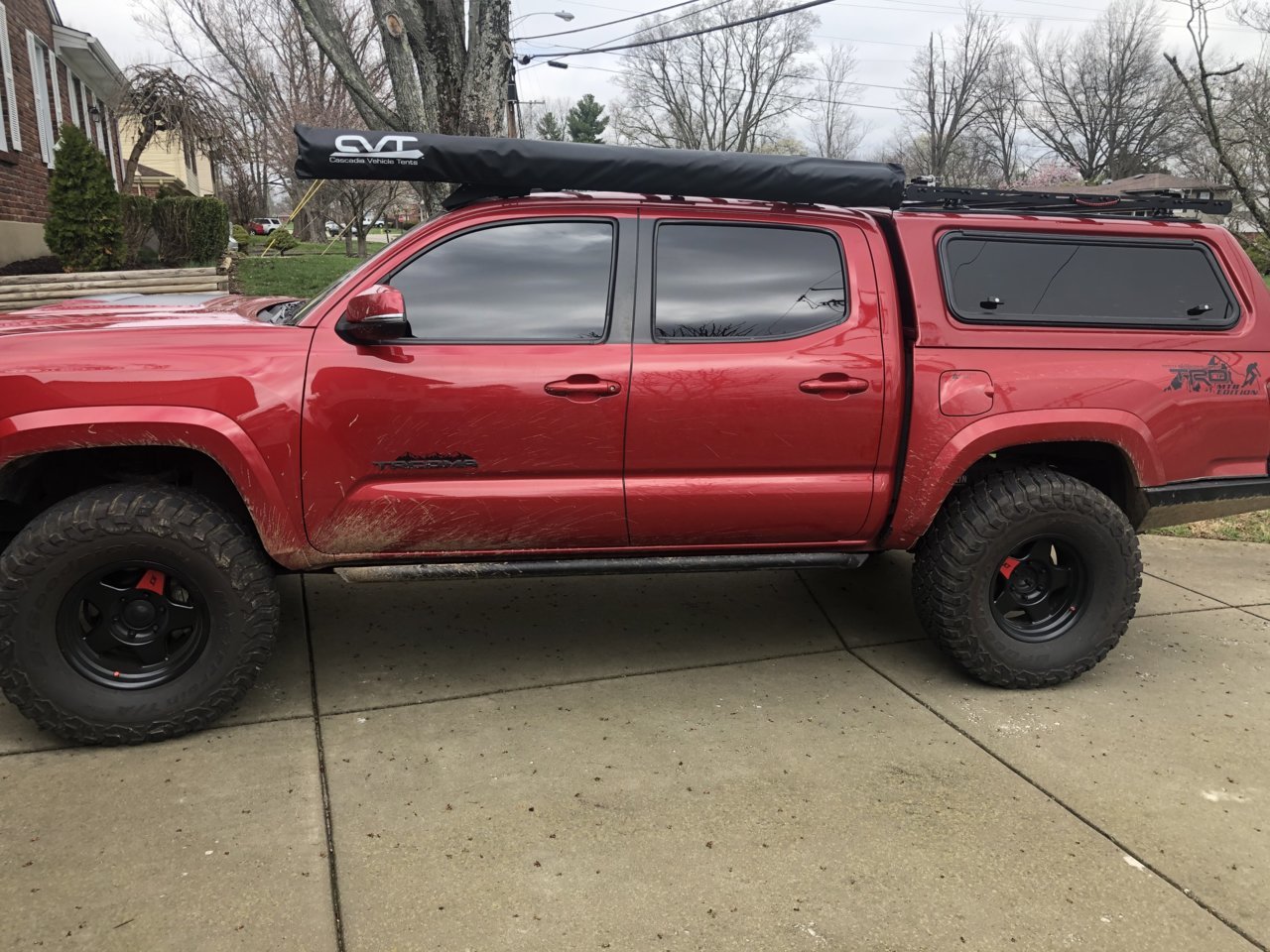

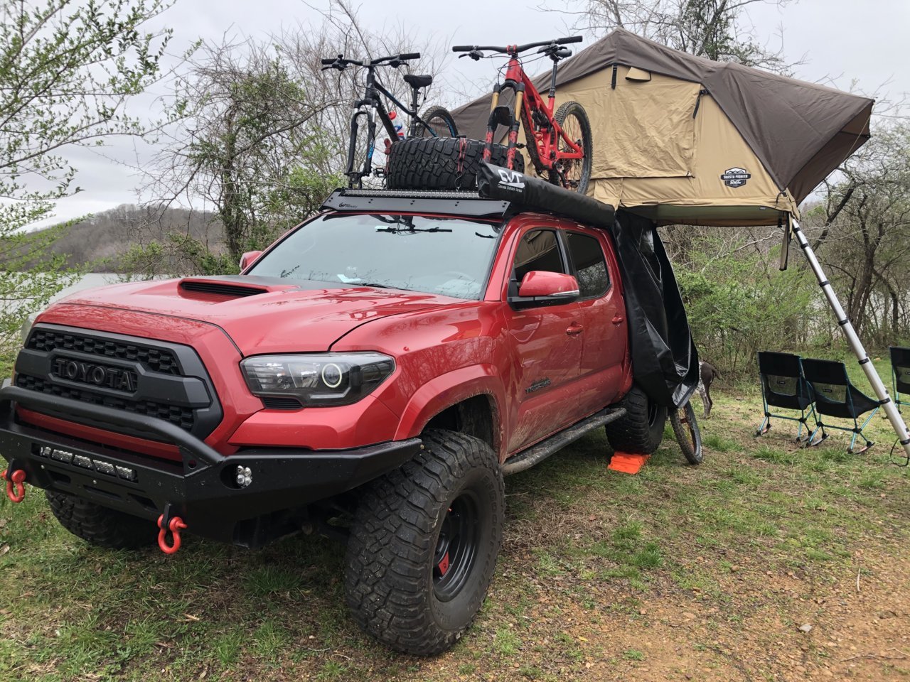

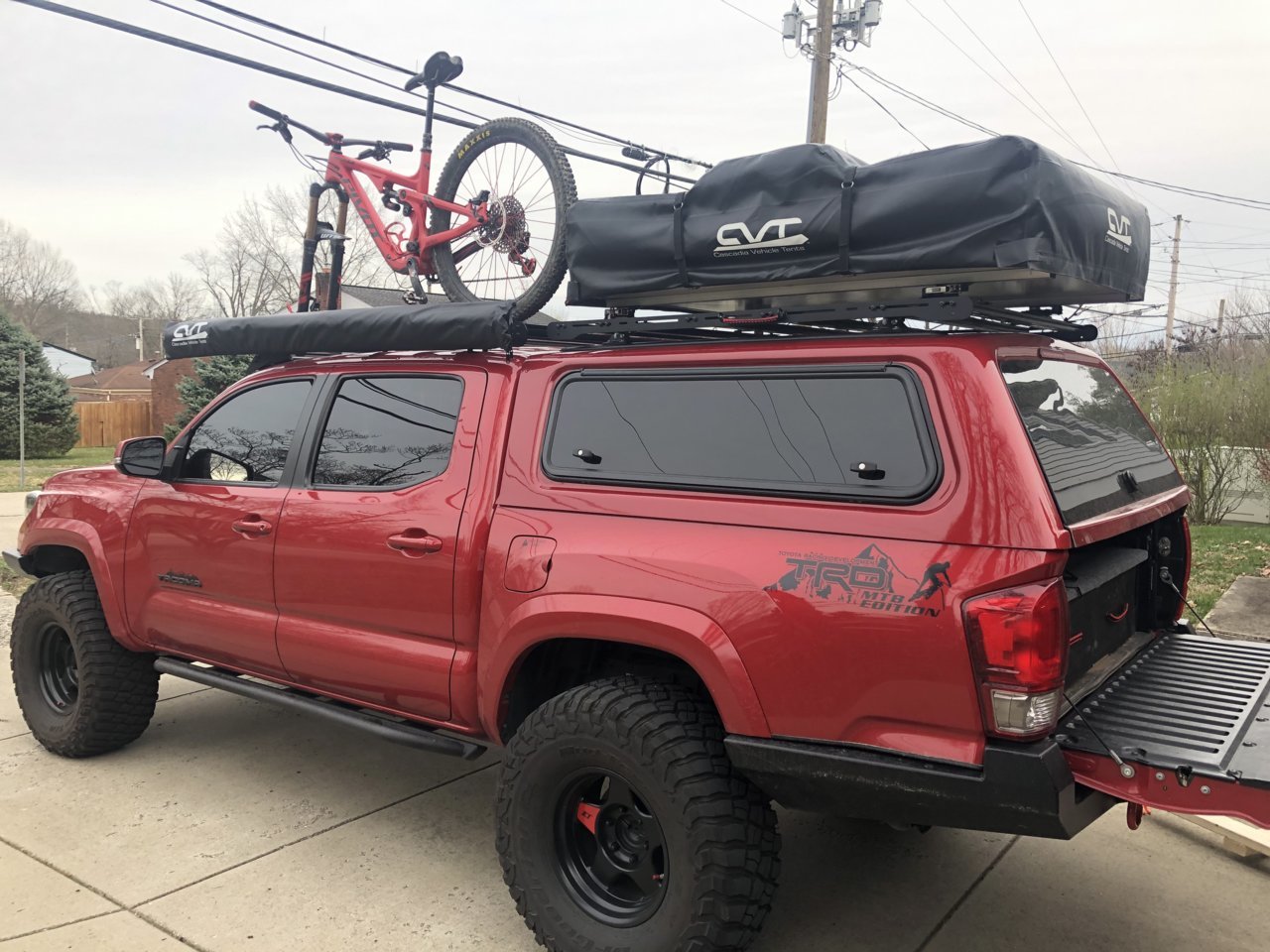

    Here’s some pics of my km3 315/75-16 on scs f5 16x8 -25 if this helps.

    Haha need to beef up the rear after adding the topper and rtt for sure. I have quite a bit of reverse rake when loaded up.

    ^ Not usually a fan of Red, that truck looks awesome! ^

    curious if you’ve had an issue in the front at all with the offset and 315s - that’s my only concern. She’s a slow pig no matter what tire size with 2.7 lol (for my rig).

    Ive got ~72 K on the truck and ~15 K on 35s. I was on 33s before that for ~40 K miles. No issues with front end or suspension. Had to trim some at the back of the wheel wells, do a cab mount relocation, get an alignment, and regear to 5.29s but other than that it was pretty painless.
