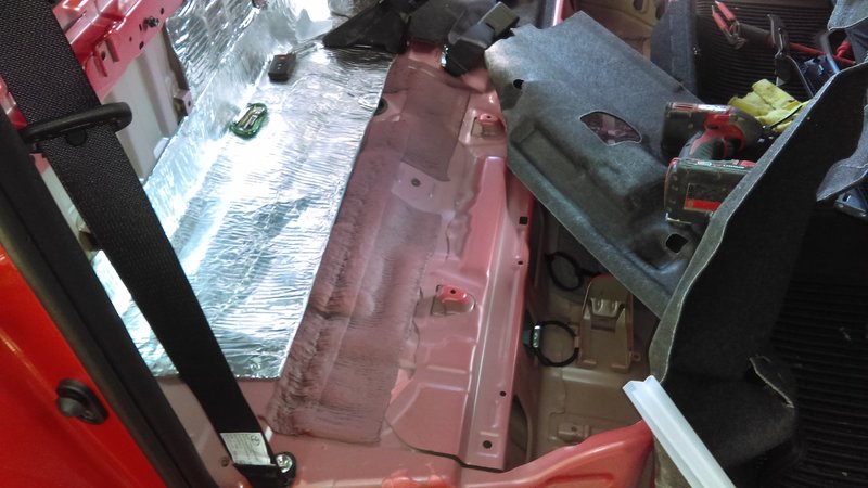

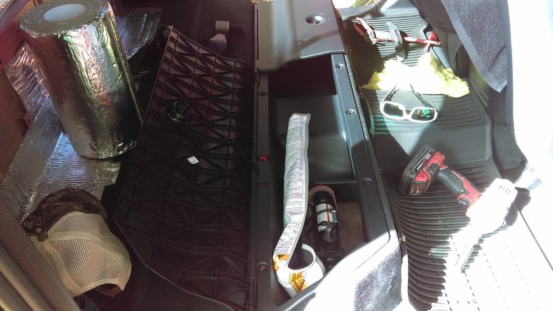

    I started with the backseats, and rear doors today after work:
    Garbage, paper cones.

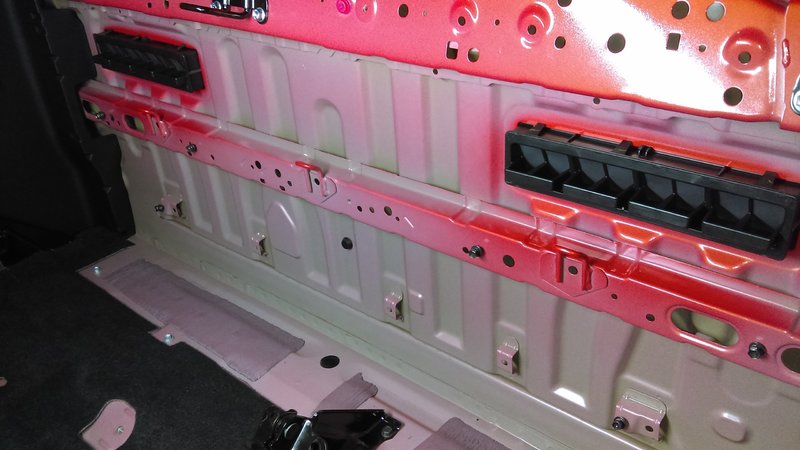

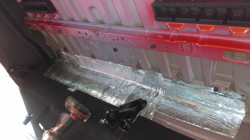

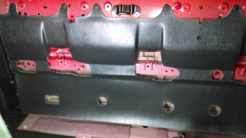

    I may have gotten ahead of myself, but oh well...
    Ive still gotta pickup some dynamat, or similar sound deadening material...

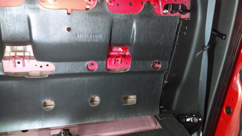

    Heres what they used on the rear wall for insulation:

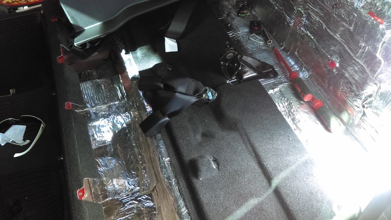

    Now I need DynaMat.... Prep'd.

    No wonder I get so much road noise from the back of the cab!

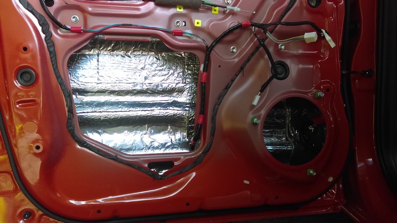

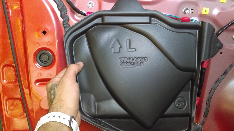

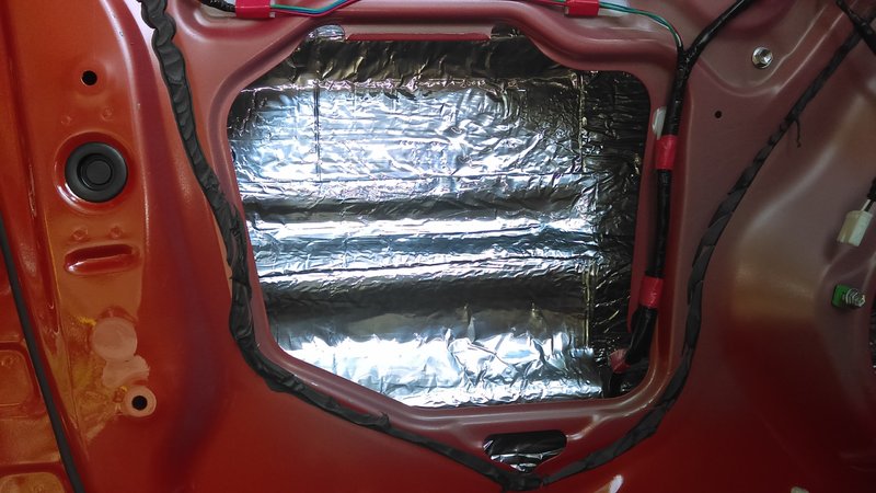

    Started with the drivers side, rear door. Checkout the stock sound blockers:

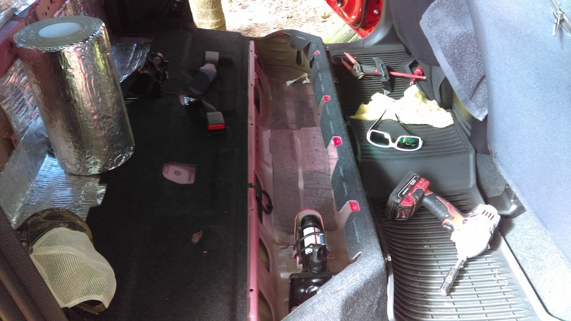

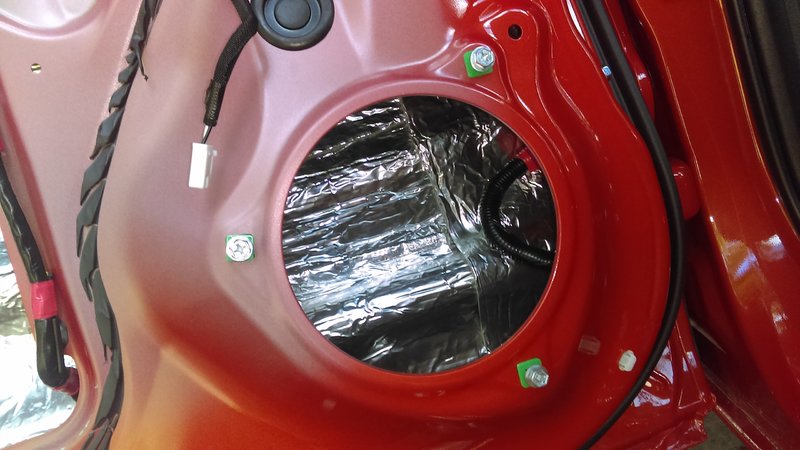

    ...getting under the rear seats storage bin:

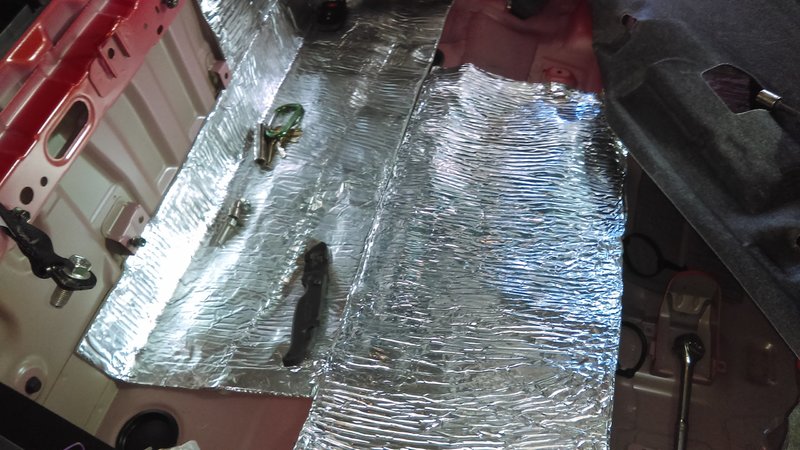

    Doing up the rears floor:

    Heres the storage bin lined. Its dark now, I will hafta put the bin and jack back in first, in the morning...
