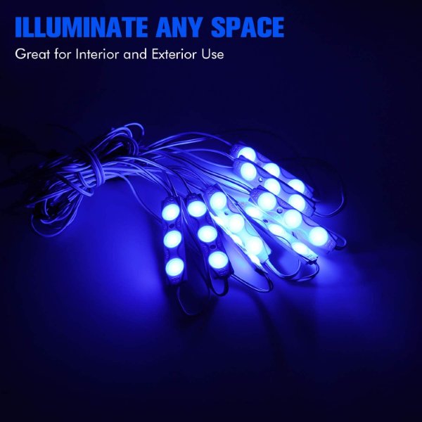

    I'm thinking of using these led pods for bed lighting:
    They've got adhesive on the back for sticking to the underside of the bed rails.
    Anyone know of a good tape to use for sticking the zip cord between the pods to the rails so that it's not seen, doesn't droop or get snagged by anything, etc.?
    I know that duct tape gets pretty ratty looking when exposed to the weather over time. Would be nice if this tape came in black.

    Those and zipties are how several of the packaged bed lights come. No tape will hold up as long as 3M double sided adhesive will. If you buy the one's I linked they will fall off in short order but more premium ones come with higher quality adhesive.

    I have a bunch of those. I peel the adhesive off and put some VHB on there instead. Never had an issue with them coming loose.

    The ones we have at work are made by Panduit. There's no way that adhesive pad is peeling off the mount. I *think* they apply the pad while the nylon is still warm/soft from molding, dunno'. When you stick the mount to some clean surface, it feels like it's really on there and isn't going anywhere. Come back in a year and your wires are all over the place and those mounts are just dangling. Just a tiny bit of super glue applied right to the adhesive pad though, and...
    I'll keep that option open for the bed lights, if I can find some smaller ones, and doing as you suggested with the VHB. Thanks.

    Tesa tape the wire to a long flat piece of aluminum or a rod and screw that to the bed.

    That or something similar is a possibility, too. I think I just need to get the lights, put them where I want them, then figure out what to do with the wires.
