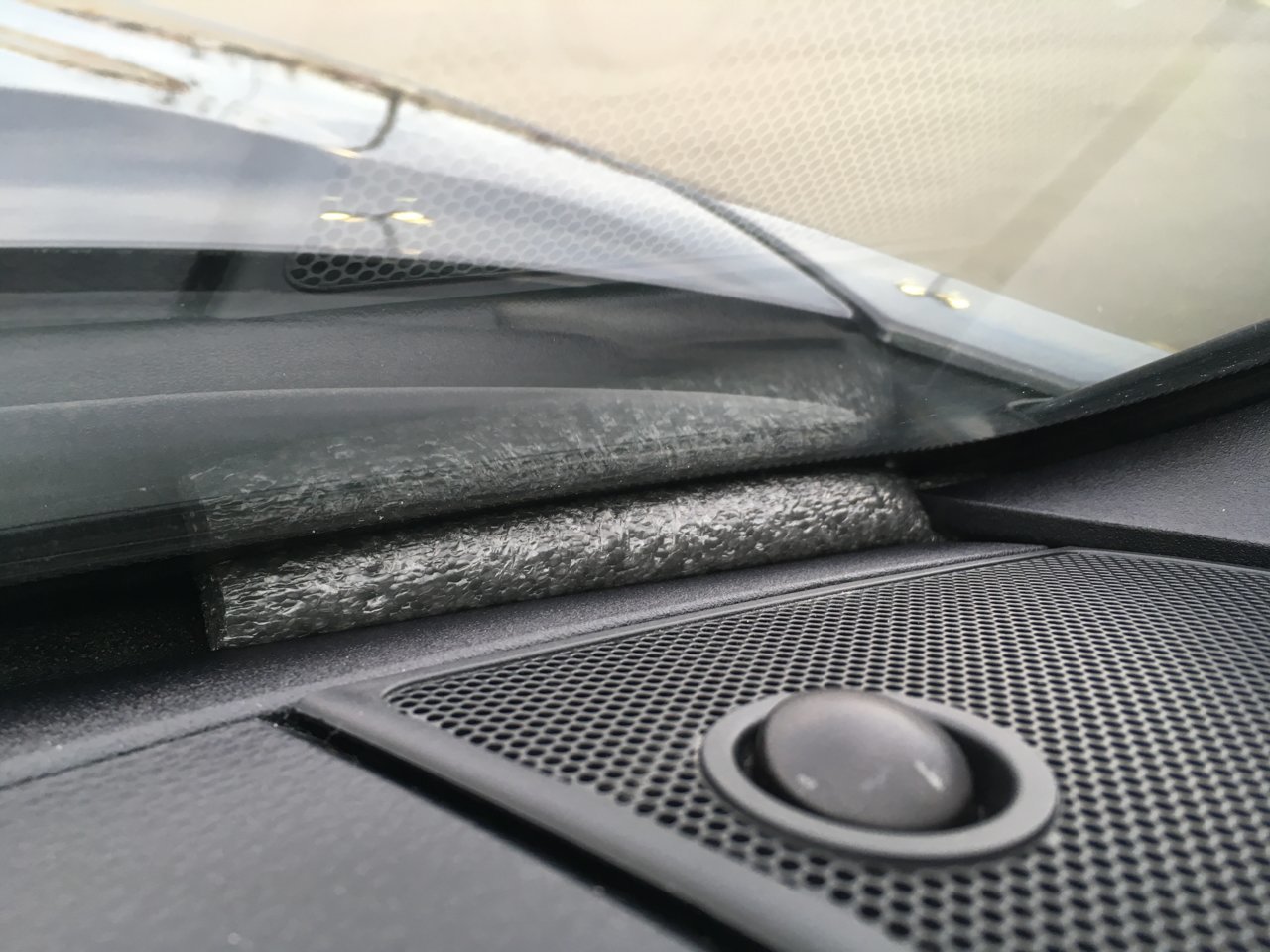

    After my last attempt to felt tape every possible place that joins another, like the light sensor where it clips in and redoing the sticky foam tape along the APillar and felt taped the Pillar tabs at the base. I also felt taped where the tweeter bolts down, put it all together and didn’t hear a thing all day. (I also kept the radio off). The next morning, it was a chilly one and half way to work and very much enjoying how quiet the ride was, I threw on some Boston AND THE DAM TICKING NOISE CAME BACK IN FULL GLORY!!?:frusty::rant:
    I got home that evening and pulled the tweeter and bought some 3/4” foam rope and stuffed 3 layers of it down where the windshield and dash meet and it’s been 3 days now and no ticking! I don’t have the tweeter there and don’t really miss it even with the radio on but it’s quiet.

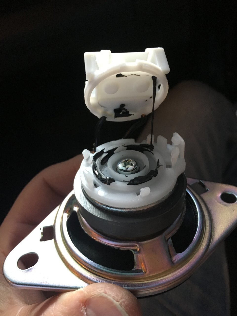

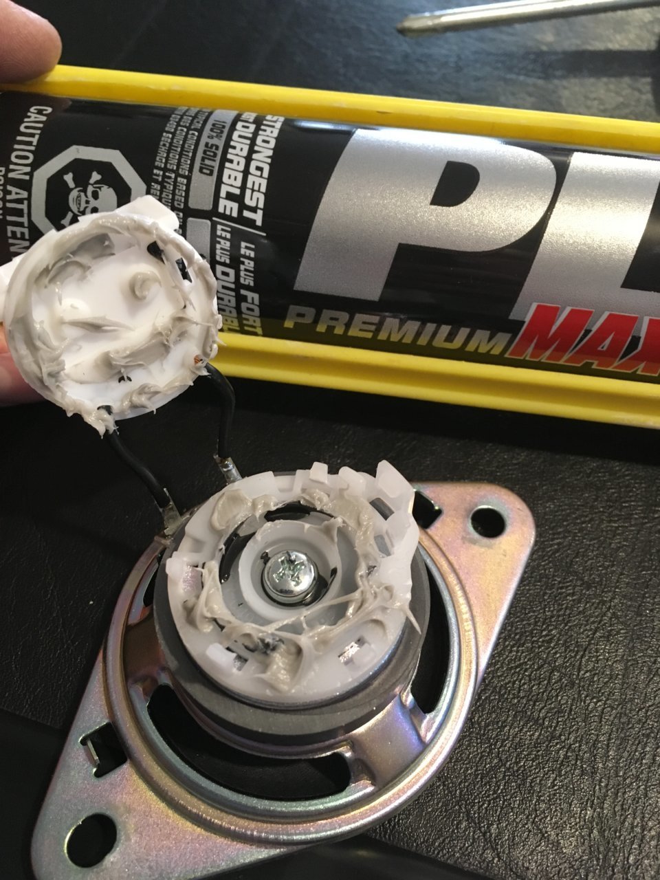

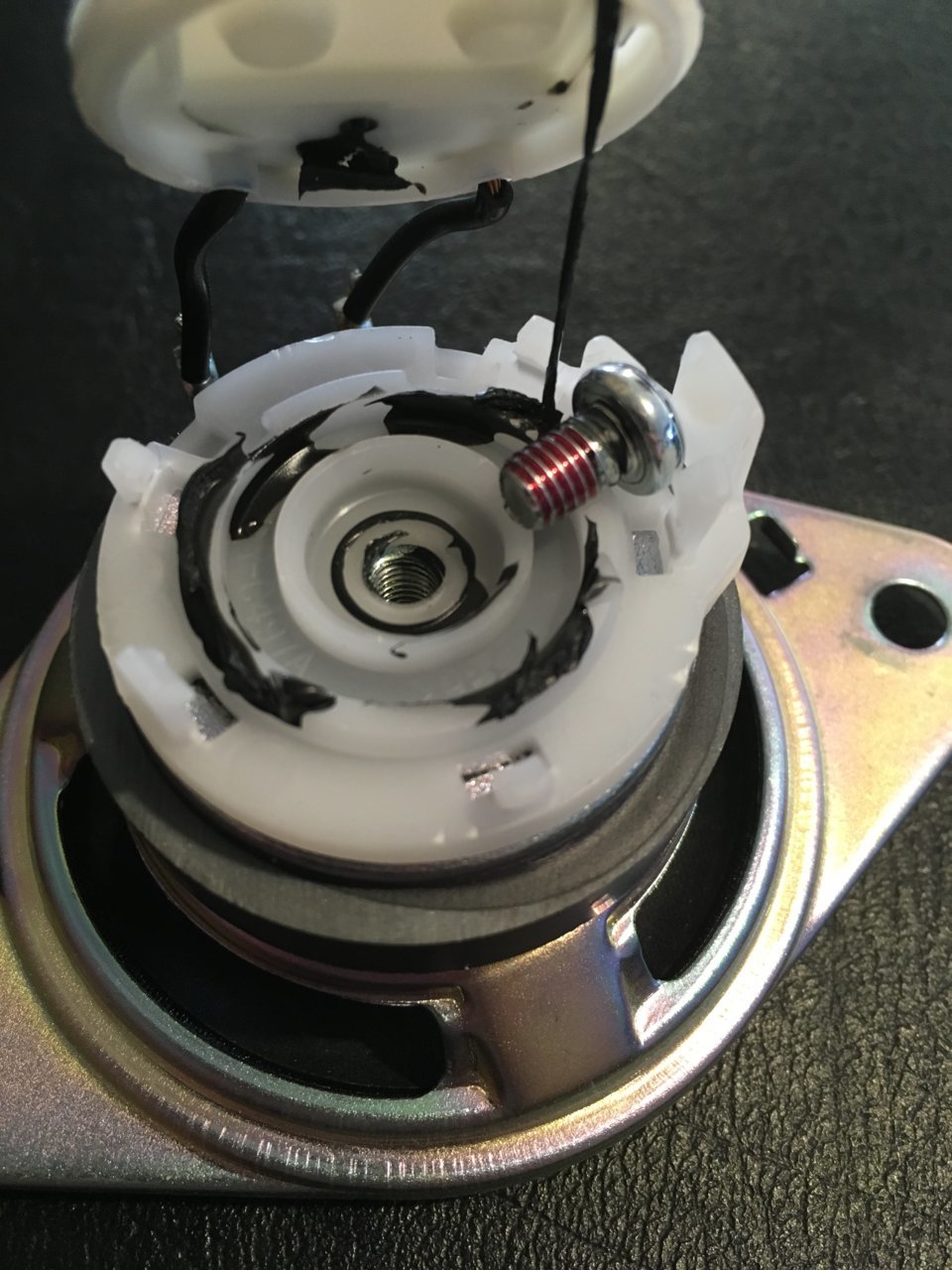

    So today, my 4th day of silence, I decided to install the tweeter but first I took it apart to see what could possibly make ticking noises. The back of the tweeter has a white plastic cap held on by tiny little plastic hooks. I carefully pushed back on these hooks and pried the cap off. There is some black adhesive poorly installed and lacking in quantity. Basically non of the adhesive was holding anything which left the plastic cap to vibrate ever so slightly causing the little plastic hooks, maybe just one, to vibrate and tic. I cleaned out the black crap and glued the sh#t out of it with PL Premium MAX, (24 hour cures hard) also put a drop of perminant locktite on the screw under the plastic cap and put it back together. In my case, the last time I installed the tweeter, it went back to ticking when I turned the music back on and continued even when off. So I’ve isolated the noise to either these little plastic hooks or it’s the windshield adhesive at that corner which I stuffed with 3/4” foam rope. I’ll give the glue on the tweeter cap a chance to cure hard for 24 hours before I turn on the radio. If the ticking doesn’t return, I will remove the foam rope from the space I stuffed it. Update you all later!

    After taking out the 3/4” foam rope from the corner of the windshield and dash there’s been no ticking noise. Gluing the back of the tweeter together was the ticket. I drove around the night before, all day yesterday and today’s long commute to work in the cold proved no signs of ticking from that corner. As far as I’m concerned, it’s fixed!
    I believe getting a new tweeter on warranty won’t fix the manufacture poor adhesive problem putting it together. Either upgrade the tweeter from some other make or take it apart and glue it up. This nightmare is done.
