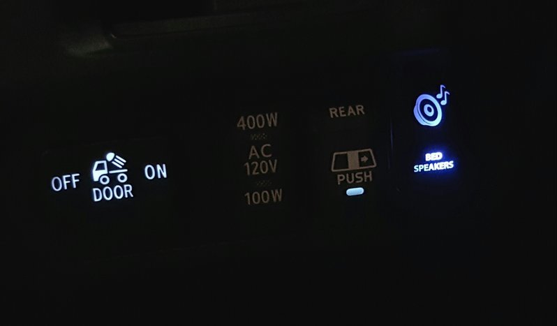

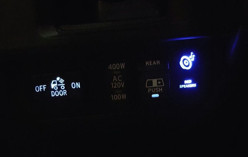

    I finally got around to lighting up my switch. I decided to get the Posi-Tap connectors and really like the. I connected the red 2 #3 wire coming off my switch to the green wire on the cargo switch and the black #4 coming off my switch to the tan wire on the cargo switch. It functions just the way I wanted it to. Lights up with the rest of the switches, Dimes with the odometer dimmer switch, and the top part of the switch lights up when active. It also turns off when the rest are off. The top picture is with my bed speakers off and the bottom picture is with them on. 20170109_164917.jpg 20170109_195214.jpg 20170109_195131.jpg

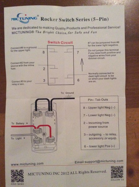

    I went pos extra to green and neg extra to tan. I have the mic tuning wiring harnes and switch

    Holy shit... i royally fuked up! I put the jumper to the dimmer positive. Which caused the parking lights to be on always

    In this diagram I have to put a separate wire to the dimmer pos(green) from 6. And a separate wire from 7 to brown. And I get dimming
