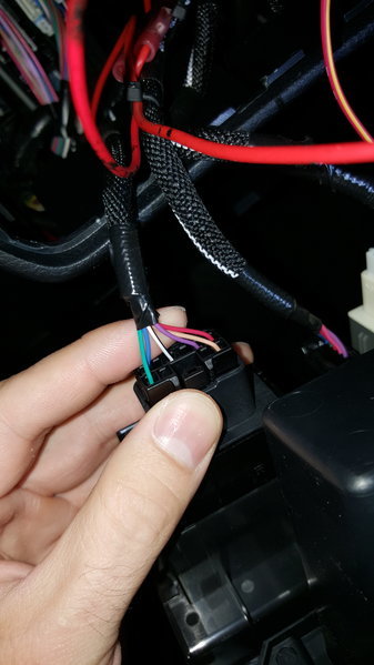

    Pulled the dash apart today to replace the center switches and while I was in there stripped the tape back from the AC control llumination wires so I can tap them below in the switch area. The flyeyez instructions are pretty much all you need for this. While I had access I checked and the dimmer switch on my 2014 does indeed use the green-green/white for the dimmer circuit.

    I measured the corner wires on my 2016 tacoma. Wires green and light brown. The brown one shows a variable voltage, positive, that responds to dimmer changes. But when I connect to that I get a "check charging system" warning on the console display behind steering wheel. I get the impression that the +/- dimming lines are not ground-based, so connecting to either of those creates some sort of unexpected current back to the controller, hence the warning. I'll just tap panel so will give up dimming. Or tail.

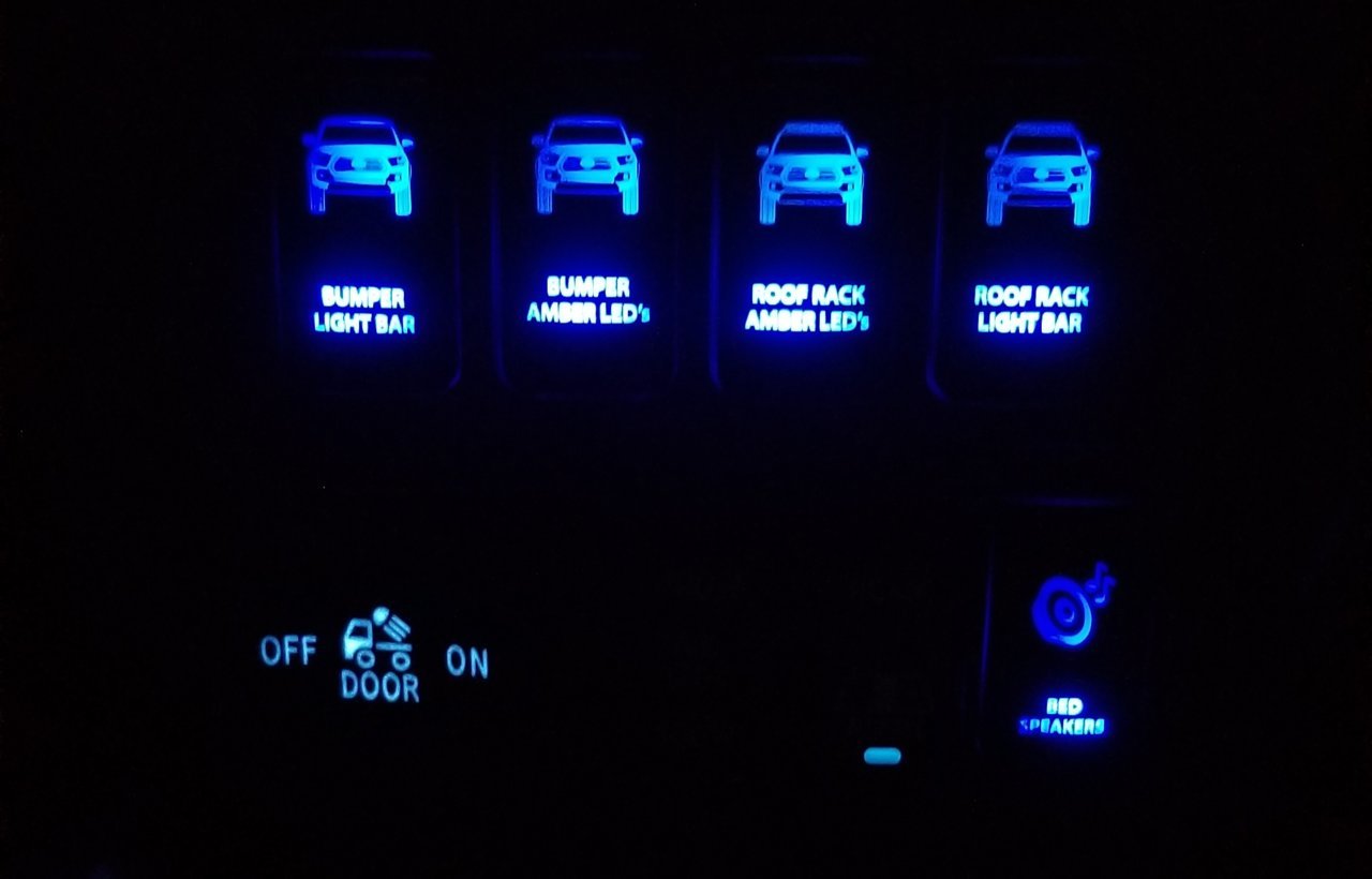

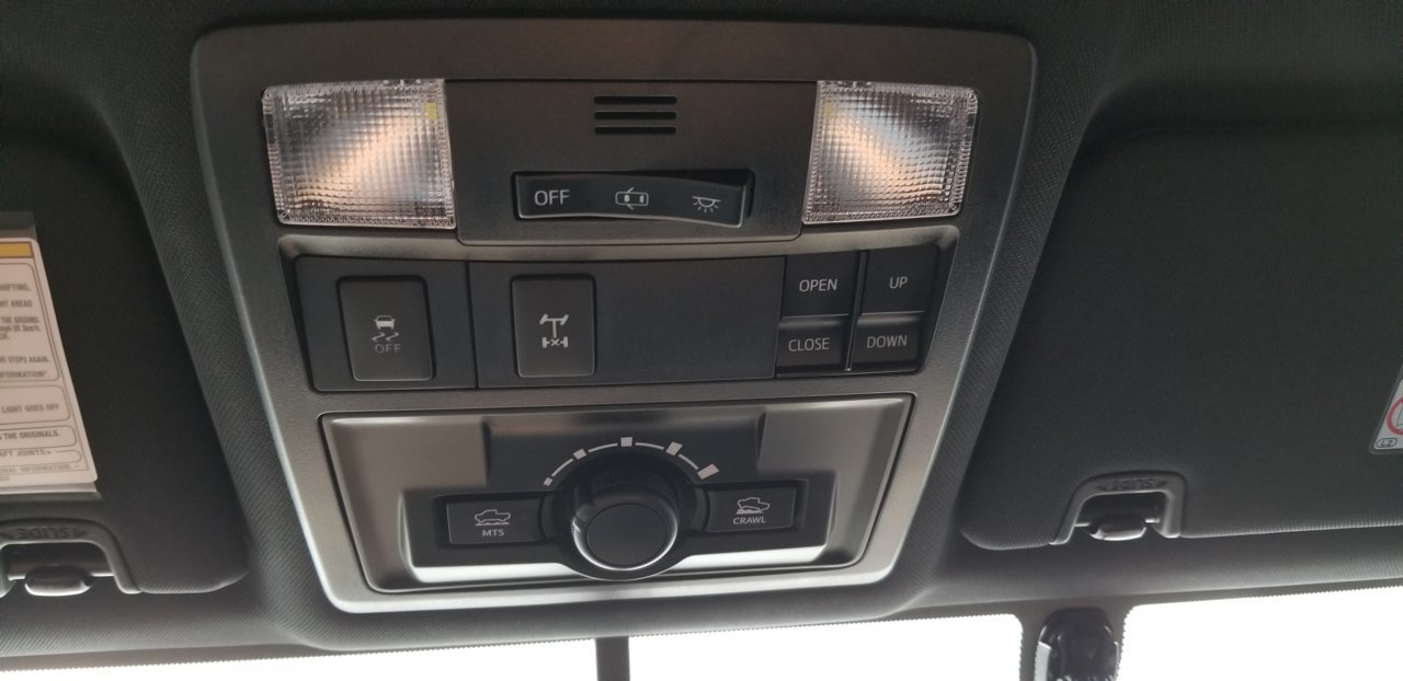

    Does anyone know what wire I can tap into for illumination in the overhead area? I'll be adding a toggle switch up there and want to light it up the same way. 20181112_162040.jpg

    I don't want to plug it into any 12v source because it would be lit all the time. I'm planning on tapping into the rear differential lock switch right there. It only has 4 wires going into it. One has to be for illumination

    Actually you need two wires, illumination power and illumination ground. The other two are switch power and switch output. Can you drop the overhead panel and take a pic of the switch and connector? The internals are all pretty much the same for each switch style, just the laser etching differs. Inside there's a printed circuit board with two leds, two resistors, and one push button switch. If the leds dont match either in color or brightness you can easily (and I mean rank beginner level soldering easy) swap in a different 3mm led or 1/4w resistor.

    For the illumination ground I'm just going to ground it to the chassis. I did the same with the switchs I installed on the left side of the steering wheel over a year ago and there still working fine. I tapped all 5 into the same illumination wire coming off one of the switchs there, and then just grounded all the wires, screwed them to the chassis.
    Below is the back side of the upper center console

    4 wires on diff lock left to right:
    Black(?) illumination ground
    Black/white(?) illumination power
    Red/white 12v switch power
    Tan switch output.
    Since the aftermarket switches seem to have the same layout as the oem ones this would be my first choice for verification.
    The (?) are because I'm not certain of the colors I'm seeing in the pic which is why left to right is also listed.

    2 of the 4 wires will have 12v but only 1 will always be hot with ignition on while the other should only be hot with the headlights on as well.
