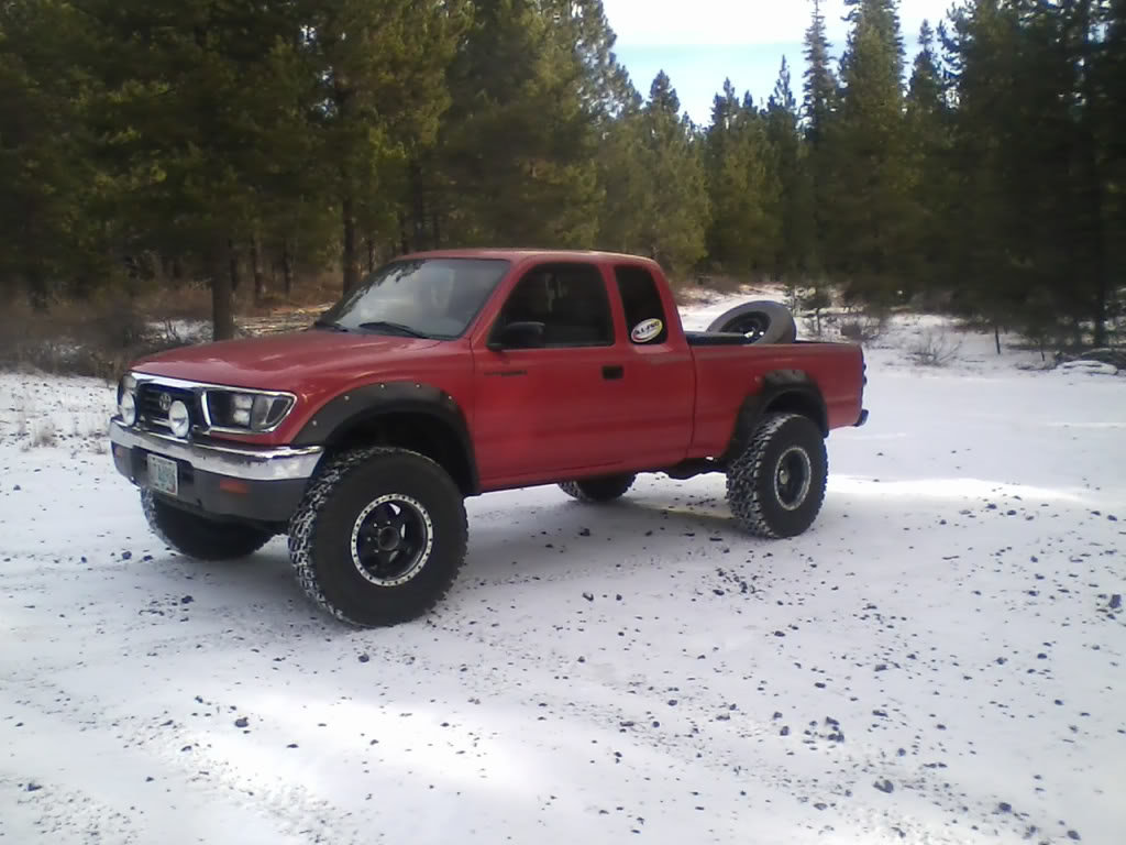

    I'm running the 5100's set at 2.5" up front with stock trd coils. I have 33x12.50x15 and had to get wheel spacers to keep them from rubbing the upper control arm.mafter the spacers they rubbed around the pinch weld so I smashed it even more and had to cut a little. Now they rub occasionally but look 100x better than my 32x11.50s that I had. You should be fine with 33x12.50 cause 5100's and eibachs give something like 3.5" of lift if I'm correct. Get 33x12.50s
    32s
    33s
