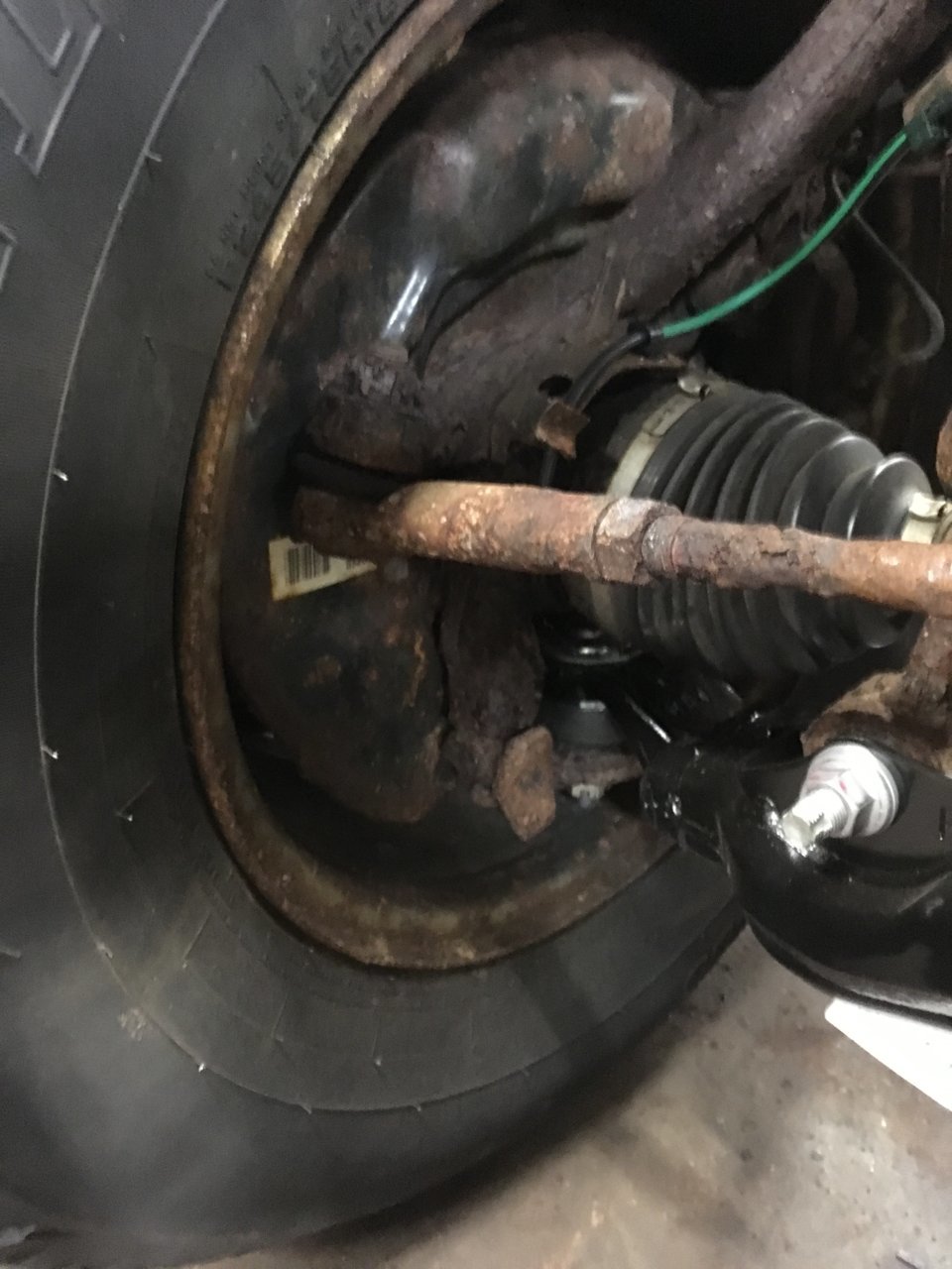

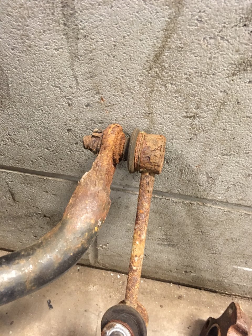

    I am currently in the process of gathering up parts to replace the worst bits of my suspension. Here's their current state:
    My hope is to gather as many parts off TW members' sales as possible. This will save me a ton of money, and I hope supports this community that has been extraordinarily helpful to me.

    Shoulda got the tie rods done at the dealer while the frame was being done, coulda saved you $$$ on the alignment!
    I bought some new ends for my truck when they are trashed, 20 bucks each on Amazon i will grab you the link. They have grease fittings on top for maintenance lubing unlike the oem sealed units that suck. Guess i cant complain though, my boots have been torn for like 55k and they are in great shape still
    Proforged 104-10601 Greasable Front Outer Tie Rod End https://www.amazon.com/dp/B008VMQ84G/ref=cm_sw_r_cp_api_i_YVWdBb59XPHSQ

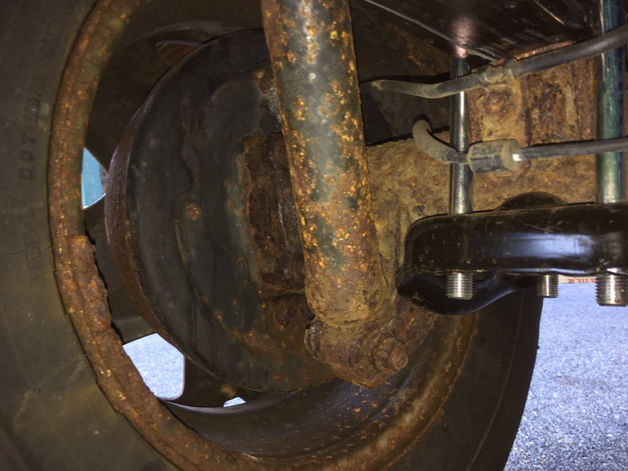

    fml! That's so much rust!!!!!!!!!!!!

    I would seriously consider getting rid of that truck and starting over, that rust is unprecedented and is likely in places that you'll never be able to reasonably fix. I just see years and years of problems and hassle. Somebody really neglected that poor thing
